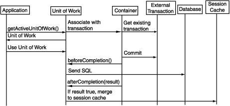

When getActiveUnitOfWork returns a unit of work that is not null, you are associated with an existing external transaction. Use the unit of work as usual.
As the external transaction was not started by the unit of work, issuing a commit on it will not cause the external transaction to be committed. The unit of work will defer to the application or container that began the transaction. When the external transaction does get committed by the container, TopLink receives synchronization callbacks at key points during the commit transaction.
The unit of work sends the required SQL to the database when it receives the beforeCompletion callback.
The unit of work uses the Boolean argument received from the afterCompletion callback to determine if the commit was successful (true) or not (false).
If the commit transaction was successful, the unit of work merges changes to the session cache. If the commit transaction was unsuccessful, the unit of work discards the changes.
Figure 99-2 shows the life cycle of a unit of work when an external transaction exists.
Figure 99-2 Unit of Work When an External Transaction Exists
Description of Figure 99-2 follows
Description of "Figure 99-2 Unit of Work When an External Transaction Exists"

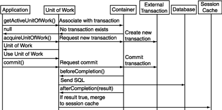

Using a Unit of Work When No External Transaction Exists
When the getActiveUnitOfWork method returns a null unit of work, there is no existing external transaction. You must start a new external transaction.
Do this either by starting an external transaction explicitly using the UserTransaction interface, or by acquiring a new unit of work using the acquireUnitOfWork method on the server session.
Once the modifications to registered objects are complete, you must commit the transaction either explicitly through the UserTransaction interface or by calling the unit of work commit method.
The transaction synchronization callbacks are then invoked on, and the database updates and cache merge occur based upon those callbacks.
Figure 99-3 Unit of Work When No External Transaction Exists
Description of Figure 99-3 follows
Description of "Figure 99-3 Unit of Work When No External Transaction Exists"
