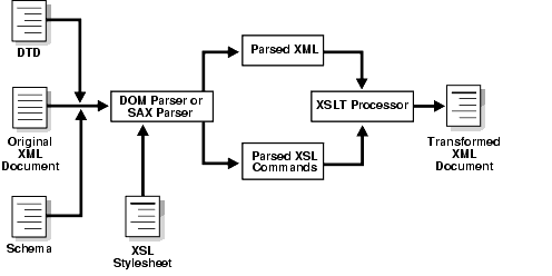

Figure 3-1 shows an XML document as input to the XML Parser for Java. The DOM or SAX parser interface parses the XML document. The parsed XML is then transferred to the application for further processing.
The XML Parser for Java includes an integrated XSL Transformation (XSLT) Processor for transforming XML data using XSL stylesheets. Using the XSLT Processor, you can transform XML documents from XML to XML, XML to HTML, or to virtually any other text-based format.
If a stylesheet is used, the DOM or SAX interface also parses and outputs the XSL commands. These are sent together with the parsed XML to the XSLT Processor where the selected stylesheet is applied and the transformed (new) XML document is then output. Figure 3-1 shows a simplified view of the XML Parser for Java.
Figure 3-1 XML Parser for Java
Description of Figure 3-1 follows
Description of "Figure 3-1 XML Parser for Java"

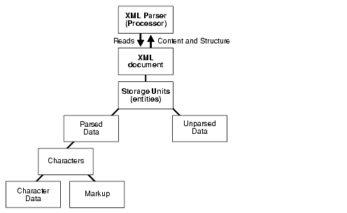

The XML Parser for Java processor reads XML documents and provides access to their content and structure. An XML processor does its work on behalf of another module, your application. This parsing process is illustrated in Figure 3-2.
Figure 3-2 XML Parsing Process
Description of Figure 3-2 follows
Description of "Figure 3-2 XML Parsing Process"

XML documents are made up of storage units called entities, which contain either parsed or unparsed data. Parsed data is made up of characters, some of which form character data, and some of which form markup.
Markup encodes a description of the document's storage layout and logical structure. XML provides a mechanism to impose constraints on the storage layout and logical structure.

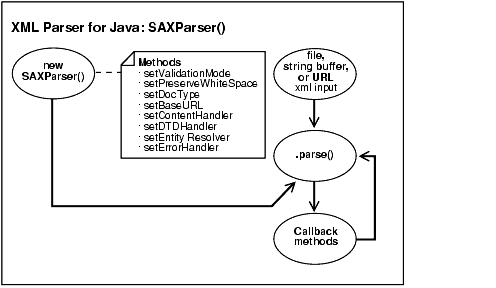

The parser method setValidationMode(mode) parses XML in the mode values shown in Table 3-1.

The XML Parser for Java provides for validating and non-validating DTD caching through the setDoctype() function. After you set the DTD using this function, XMLParser will cache this DTD for further parsing.
If your application has to parse several XML documents with the same DTD, after you parse the first XML document, you can get the DTD from parser and set it back:
dtd = parser.getDoctype();
parser.setDoctype(dtd);
The parser will cache this DTD and use it for parsing the following XML documents.
Set the DOMParser.USE_DTD_ONLY_FOR_VALIDATION attribute, if the cached DTD Object is used only for validation by:
parser.setAttribute(DOMParser.USE_DTD_ONLY_FOR_VALIDATION,Boolean.TRUE);
Otherwise, the XML parser will copy the DTD object and add it to the result DOM tree.
The method to set the DTD is setDoctype(). Here is an example:
// Test using InputSource
parser = new DOMParser();
parser.setErrorStream(System.out);
parser.showWarnings(true);
FileReader r = new FileReader(args[0]);
InputSource inSource = new InputSource(r);
inSource.setSystemId(createURL(args[0]).toString());
parser.parseDTD(inSource, args[1]);
dtd = (DTD)parser.getDoctype();
r = new FileReader(args[2]);
inSource.setSystemId(createURL(args[2]).toString());
parser.setValidationMode(DTD_VALIDATION);
parser.parse(inSource);
doc = (XMLDocument)parser.getDocument();
doc.print(new PrintWriter(System.out));

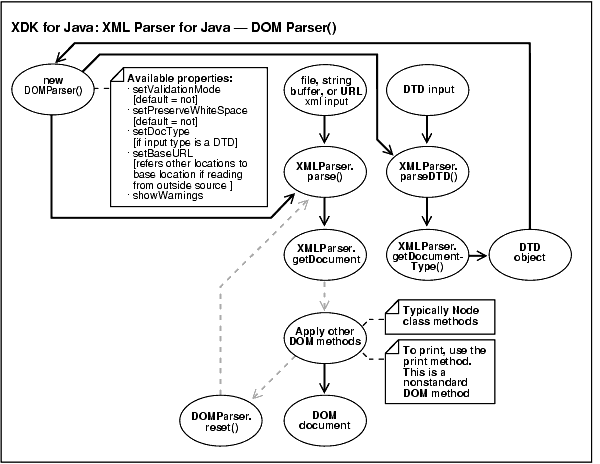

To recognize external DTDs, the XML Parser for Java has the setBaseURL() method.
The way to redirect the DTD is by using resolveEntity():
  1. Parse your External DTD using a DOM parser's parseDTD() method.
  2. Call getDoctype() to get an instance of oracle.xml.parser.v2.DTD.
  3. On the document where you want to set your DTD programmatically, use the call setDoctype(yourDTD). Use this technique to read a DTD out of your product's JAR file.
Loading External DTDs from a JAR File
The parser supports a base URL method (setBaseURL()), but that just points to a place where all the DTDs are exposed.
Do the following steps:
  1. Load the DTD as an InputStream:
    InputStream is =      YourClass.class.getResourceAsStream("/foo/bar/your.dtd");
    This opens ./foo/bar/your.dtd in the first relative location on the CLASSPATH that it can be found, including out of your JAR if it is in the CLASSPATH.
  2. Parse the DTD:
    DOMParser d = new DOMParser();
    d.parseDTD(is, "rootelementname");
    d.setDoctype(d.getDoctype());
  3. Parse your document:
    d.parse("yourdoc");

Parsing a DTD Object Separately from an XML Document
The parseDTD() method enables you to parse a DTD file separately and get a DTD object. Here is some sample code to do this:
DOMParser domparser = new DOMParser();
domparser.setValidationMode(DTD_VALIDATION);
/* parse the DTD file */
domparser.parseDTD(new FileReader(dtdfile));
DTD dtd = domparser.getDoctype();

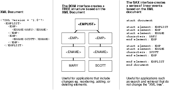

Consider the following simple XML document:
<?xml version="1.0"?>
  <EMPLIST>
    <EMP>
     <ENAME>MARY</ENAME>
    </EMP>
    <EMP>
     <ENAME>SCOTT</ENAME>
    </EMP>
  </EMPLIST>
DOM: Tree-Based API
A tree-based API (such as DOM) builds an in-memory tree representation of the XML document. It provides classes and methods for an application to navigate and process the tree.
In general, the DOM interface is most useful for structural manipulations of the XML tree, such as reordering elements, adding or deleting elements and attributes, renaming elements, and so on. For example, for the immediately preceding XML document, the DOM creates an in-memory tree structure as shown inFigure 3-3.
SAX: Event-Based API
An event-based API (such as SAX) uses calls to report parsing events to the application. Your Java application deals with these events through customized event handlers. Events include the start and end of elements and characters.
Unlike tree-based APIs, event-based APIs usually do not build in-memory tree representations of the XML documents. Therefore, in general, SAX is useful for applications that do not need to manipulate the XML tree, such as search operations, among others. The preceding XML document becomes a series of linear events as shown in Figure 3-3.
Figure 3-3 Comparing DOM (Tree-Based) and SAX (Event-Based) APIs
Description of Figure 3-3 follows
Description of "Figure 3-3 Comparing DOM (Tree-Based) and SAX (Event-Based) APIs"

Without DTD Input
In some applications, it is not necessary to validate the XML document. In this case, a DTD is not required.
  1. A new DOMParser() is called. Some of the methods to use with this object are:
    • setValidateMode()
    • setPreserveWhiteSpace()
    • setDoctype()
    • setBaseURL()
    • showWarnings()
  2. The results of DOMParser() are passed to XMLParser.parse() along with the XML input. The XML input can be a file, a string buffer, or URL.
  3. Use the XMLParser.getDocument() method.
  4. Optionally, you can apply other DOM methods such as:
    • print()
    • DOMNamespace() methods
  5. The Parser outputs the DOM tree XML (parsed) document.
  6. Optionally, use DOMParser.reset() to clean up any internal data structures, once the DOM API has finished building the DOM tree.
With a DTD Input
If validation of the input XML document is required, a DTD is used.
  1. A new DOMParser() is called. The methods to apply to this object are:
    • setValidateMode()
    • setDocType()
    • setBaseURL()
    • showWarnings()
  2. The results of DOMParser() are passed to XMLParser.parseDTD() method along with the DTD input.
  3. XMLParser.getDocumentType()method sends the resulting DTD object back to the new DOMParser() and the process continues until the DTD has been applied.
Figure 3-4 XML Parser for Java: DOMParser()
Description of Figure 3-4 follows
Description of "Figure 3-4 XML Parser for Java: DOMParser()"

Figure 3-5 shows the main steps for coding with the SAXParser class.
  1. Create a new handler for the parser:
    SAXSample sample = new SAXSample();
  2. Declare a new SAXParser() object. Table 3-3 lists all the available methods.
    Parser parser = new SAXParser;
  3. Set validation mode as DTD_VALIDATION.
  4. Convert the input file to URL and parse:
    parser.parse(DemoUtil.createURL(argv[0].toString());
  5. Parse methods return when parsing completes. Meanwhile the process waits for an event-handler callback to return before reporting the next event.
  6. The parsed XML document is available for output by this application. Interfaces used are:
