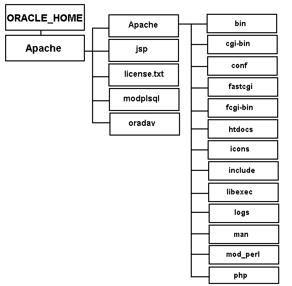

2.1 Understanding Oracle HTTP Server Directory Structure
Oracle HTTP Server is installed in the ORACLE_HOME/Apache directory on UNIX or ORACLE_HOME\Apache directory on Windows.
Figure 2-1 illustrates Oracle HTTP Server directory structure.
Figure 2-1 Oracle HTTP Server Directory Structure
Description of Figure 2-1 follows
Description of "Figure 2-1 Oracle HTTP Server Directory Structure"
The Apache directory is located at the top level under the ORACLE_HOME. It contains subdirectories for configuring modules such as mod_plsql, and mod_oradav. It also contains another directory called Apache, which is the base directory of Oracle HTTP Server. Table 2-1 contains information about the subdirectories within the ORACLE_HOME/Apache/Apache directory.
Table 2-1 Apache Subdirectories
Directory Name Contents
bin
Contains Oracle HTTP Server executables.
cgi-bin
Contains the CGI scripts. These are programs or shell scripts that can be executed by Oracle HTTP Server on the behalf of its clients.
conf
Contains the configuration files.
fastcgi
Contains the fastcgi runtime libraries, the necessary bits to build your own fastcgi applications.
fcgi-bin
Contains FastCGI scripts.
htdocs
Contains the HTML scripts. The htdoc directory and its subdirectories are accessible to anyone on the Web, and therefore pose a severe security risk if used for anything other than publicly available data.
icons
Contains the icons that Oracle HTTP Server uses when displaying information or error messages.
include
Contains header files for building custom modules.
libexec
Contains the shared library files for modules.
log
Contains the log data, for both access and errors.
man
Contains the man page for Oracle HTTP Server
mod_perl
Contains sample code for mod_perl. It also contains mod_perl specific libraries, and man pages.
php
Contains sample code for mod_php. On UNIX, the php directory also contains the PHP CLI (PHP executables), man pages, and headers. The headers enable you to build your own PHP extensions. On Windows, it contains the PHP CLI, and OCI extension to PHP (on UNIX, the OCI extension is compiled into mod_php).
