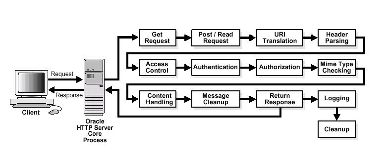

Figure 7-1 shows how URL requests are handled by the server. Each step in this process is handled by a server module depending on how the server is configured. For example, if basic authentication is used, then the steps labeled "Authentication" and "Authorization" in Figure 7-1 represent the processing of the mod_auth module.
Figure 7-1 Steps for Handling URL Requests in Oracle HTTP Server
This figure shows the steps for handling URL requests.
Description of "Figure 7-1 Steps for Handling URL Requests in Oracle HTTP Server"
