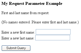

Using HTML Forms and Request Parameters
A typical servlet might ask the user to enter some information for the servlet to display or manipulate. The servlet can use HTML forms to take the information, store it in parameters of the HTTP request object, and send it to the server. You can also retrieve other information from the request object, such as the protocol, HTTP method, and request URI being used.
The following sections show some examples:
HTTP request parameters will not be available to servlet filters that are meant to be executed before dispatch of the request to a static resource (an .html file, for example). Filters that execute before dynamic resources, such as a servlet or JSP page, will have access to the parameters.
See "Key Methods of the HttpServletRequest Interface" for a summary of request methods.
Using an HTML Form for User Input
A servlet can use an HTML form to take input from the user, then submit these data to the server as parameters of the HTTP request object. Here is an example:

This example prompts the user to enter his or her first name, stores it in a request parameter called firstname, prompts for the last name, and stores it in a request parameter called lastname. The request object is sent to the server, where the information is processed as desired (as shown in the next section).
A significant disadvantage to using the GET method for this operation, however, is that the parameter names and values are appended to the servlet URL string. To prevent this, you can use the POST method instead, as shown in "Using the POST Method for URL Security".

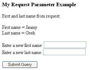

Displaying Request Parameter Data Specified in User Input
This section shows sample code that displays request parameter data that were specified by the user through an HTML form (shown in the preceding section).
PrintWriter out = response.getWriter();
String firstName = request.getParameter("firstname");
String lastName = request.getParameter("lastname");
out.println("First and last name from request:" + "<br>" + "<br>");
if (firstName != null || lastName != null) {
    out.println("First name ");
    out.println(" = " + firstName + "<br>");
    out.println("Last name ");
    out.println(" = " + lastName + "<br>");
} else {
    out.println("(No names entered. Please enter first and last name.)");
The values of the request parameters firstname and lastname are stored in the strings firstName and lastName, then output to the user.
Complete Example Using a Form and Request Parameters
Here is the complete servlet with the code from the preceding sections. It prompts the user for first name and last name, with the information being written to the request object, then it retrieves the names from the request object and outputs them to the user. (The output code comes first, indicating "No names entered" until the user first enters some names.)
import java.io.*;
import javax.servlet.*;
import javax.servlet.http.*;
public class RequestParamExample extends HttpServlet {
    public void doGet(HttpServletRequest request,
                      HttpServletResponse response)
        throws IOException, ServletException
        response.setContentType("text/html");
        out.println("<html>");
        out.println("<body>");
        out.println("<h3>" + "My Request Parameter Example" + "</h3>");
        } else {
        out.println("<P>");
        out.print("<form action=\"");
        out.print("RequestParamExample\" ");
        out.println("method=GET>");
        out.println("Enter a new first name: ");
        out.println("<input type=text size=20 name=firstname>");
        out.println("<br>");
        out.println("Enter a new last name: ");
        out.println("<input type=text size=20 name=lastname>");

When the servlet first starts, it shows the following:
Request Parameter Example (1 of 2)
If you enter "Jimmy" and "Geek" and then click Submit Query, it shows the following:
Request Parameter Example (2 of 2)

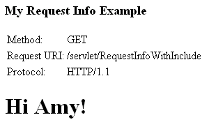

Invoking RequestInfoWithInclude results in output such as the following:
Description of include.gif follows
