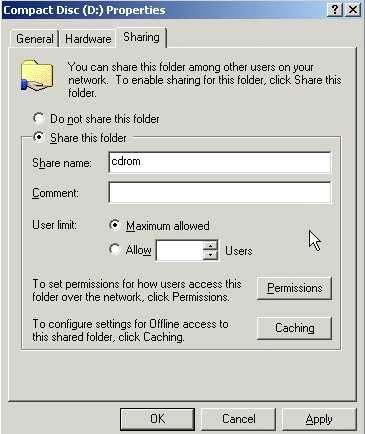

On the Remote Computer, Share the CD-ROM or DVD-ROM Drive
The remote CD-ROM or DVD-ROM drive that you want to use must allow shared access. To set this up, perform these steps on the remote computer (which has the CD-ROM or DVD-ROM drive):
  1. Log in to the remote computer as an Administrator user.
  2. Start up Windows Explorer.
  3. Right-click the CD-ROM or DVD-ROM drive letter and choose Sharing (Windows 2000) or Sharing and Security (Windows 2003, Windows XP).
  4. In the Sharing tab (Figure 2-3):
    Select Share this folder.
    Share name: Give it a share name such as cdrom or dvd. You will use this name when you map the CD-ROM or DVD-ROM drive on the local computer. See step d.
    Click Permissions. You need at least "read" permission for the user who will be accessing it to install Oracle Application Server.
    Click OK when done.
    Figure 2-3 Sharing a CD-ROM Drive
    Description of Figure 2-3 follows
    Description of "Figure 2-3 Sharing a CD-ROM Drive"
  5. CD-ROM: Insert Oracle Application Server Disk 1 into the CD-ROM drive.
    DVD-ROM: Insert the Oracle Application Server DVD-ROM into the DVD-ROM drive.
