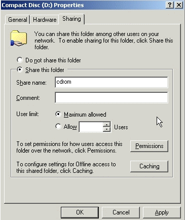

2.9.8 Installing from a Remote CD-ROM or DVD-ROM Drive
If the computer where you want to install Oracle Application Server does not have a CD-ROM or DVD-ROM drive, you can perform the installation from a remote CD-ROM or DVD-ROM drive. Check that you have performed these steps:
On the Remote Computer, Share the CD-ROM or DVD-ROM Drive
The remote CD-ROM or DVD-ROM drive that you want to use must allow shared access. To set this up, perform these steps on the remote computer (which has the CD-ROM or DVD-ROM drive):
  1. Log in to the remote computer as an Administrator user.
  2. Start up Windows Explorer.
  3. Right-click the CD-ROM or DVD-ROM drive letter and choose Sharing (Windows 2000) or Sharing and Security (Windows 2003, Windows XP).
  4. In the Sharing tab (Figure 2-3):
    Select Share this folder.
    Share name: Give it a share name such as cdrom or dvd. You will use this name when you map the CD-ROM or DVD-ROM drive on the local computer. See step d.
    Click Permissions. You need at least "read" permission for the user who will be accessing it to install Oracle Application Server.
    Click OK when done.
    Figure 2-3 Sharing a CD-ROM Drive
    Description of Figure 2-3 follows
    Description of "Figure 2-3 Sharing a CD-ROM Drive"
  5. CD-ROM: Insert Oracle Application Server Disk 1 into the CD-ROM drive.
    DVD-ROM: Insert the Oracle Application Server DVD-ROM into the DVD-ROM drive.
On the Local Computer, Map the CD-ROM or DVD-ROM Drive
Perform these steps on the local computer to map the CD-ROM or DVD-ROM drive and to run the installer:
  1. Map the remote CD-ROM or DVD-ROM drive.
    1. Start up Windows Explorer on the local computer.
    2. Select Tools > Map Network Drive. This displays the Map Network Drive dialog.
    3. Select a drive letter to use for the remote CD-ROM or DVD-ROM drive.
    4. In Folder, enter the location of the remote CD-ROM or DVD-ROM drive using the following format:
      \\remote_hostname\share_name
      Replace remote_hostname with the name of the remote computer with the CD-ROM or DVD-ROM drive.
      Replace share_name with the share name that you entered in step 4.
      Example: \\computer2\cdrom
    5. If you need to connect to the remote computer as a different user:
      Click different user name, and enter the username.
    6. Click Finish.
  2. Run the installer from the mapped CD-ROM or DVD-ROM drive.
    When the installer prompts you to switch CD-ROMs, eject the CD-ROM and insert the requested CD-ROM.
    The installer must be running when you are switching CD-ROMs. Do not exit the installer when switching CD-ROMs. If you exit the installer, it is unable to continue from where it left off. In addition, the partial installation that it created is not usable, and may need to be removed manually.
