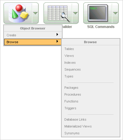

To view Object Browser you can either:
Click the Object Browser icon.
Click the down arrow on the right side of the icon to view a pull-down menu. Then, select the appropriate menu option.

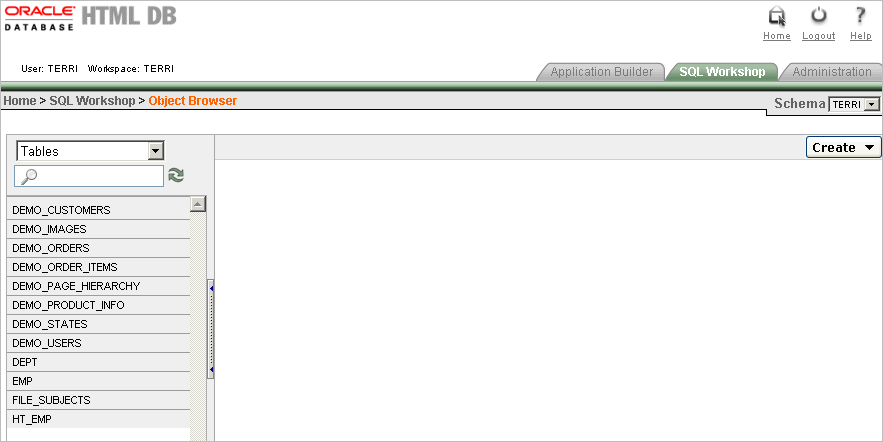

The Object Selection pane displays on the left side of the Object Browser page and lists database objects by type with the current schema. You can filter the view by selecting an object type or entering a case insensitive search term.
Topics in this section include:
To search or filter objects in the Object Selection pane:
Navigate to Query Builder:
Click the SQL Workshop icon on the Workspace home page.
Click Object Browser.
Object Browser appears.
Select a schema from the Schema list on the right side of the page.
Only objects in the current schema display. Remember that the values available in the schema depend upon your workspace privileges.
Select an object type from the Object list.
The list of objects that appears depends upon the available objects in the current schema. Note that any object having a red bar adjacent to it is invalid.
To search for an object name, enter a case insensitive search term in the search field.
To view all objects, leave the search field blank.
You can hide the Object Selection pane by selecting the Hide Objects control. This control displays on the right side of the Object Selection pane. If the Object Selection pane appears, selecting this control hides it. Similarly, if the Object Selection pane is hidden, selecting this control causes the pane to reappear.

To browse a trigger in Object Browser:
Navigate to Object Browser:
From the Object list, select Triggers.
From the Object Selection pane, select a trigger.
The Details view appears.
