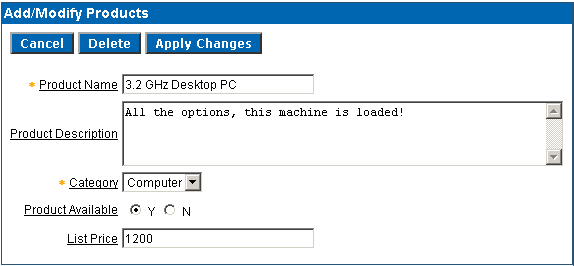

As shown in Figure 5-1, note that Product Available is a radio group. In this exercise that follows you will change this item to a check box.
In this exercise you change the Product Available radio group to a check box and then change the position of the label.

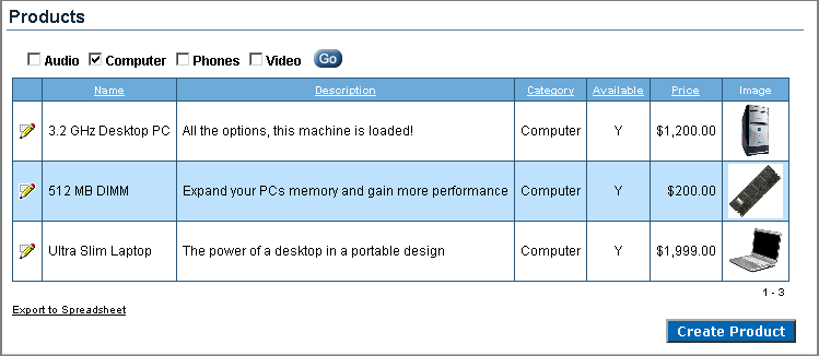

As shown in Figure 5-4, notice you can filter the report by selecting a category check box at the top of the page.
Figure 5-4 Product Page with Category Check Boxes and Go Button

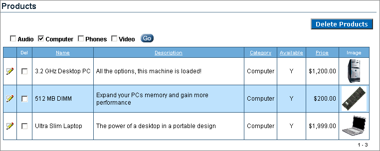

To edit the query to call HTMLDB_ITEM.CHECKBOX
Navigate to the Page Definition for page 3.
Under Regions, click Products.
In Region Source, add the new line appearing in bold face to the query.
SELECT p.product_id edit_product, p.product_id view_product_id,
htmldb_item.checkbox(1,p.product_id) del,
p.product_name, p.product_description, p.category, p.product_avail, p.list_price, '<img src="#OWNER#.custom_image_display?p_image_id=' || nvl(i.image_id,0) || '"
height="50" width="50" />' img
FROM demo_product_info p, demo_images i
WHERE p.image_id = i.image_id (+)
AND instr(':'||:P3_SHOW||':',category) > 0
HTMLDB_ITEM is an Oracle HTML DB supplied package you can use to generate certain form elements dynamically. Note the value passed in for p_idx
in the above example is 1. You reference the check box values using the global variable HTMLDB_APPLICATION.G_F01
later on.

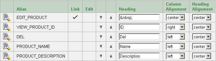

Select the Report Attributes tab.
Under Column Attributes, locate the Del
column.
Click the Up arrow until the DEL
column is directly beneath VIEW_PRODUCT_ID
. (See Figure 5-5).
Click Apply Changes.

If you run the page, the Delete Products button appears above the report. (See Figure 5-6). To remove a product from the report, select the Del check box and click Delete Products.
Figure 5-6 Products Report with Delete Products Check Box
