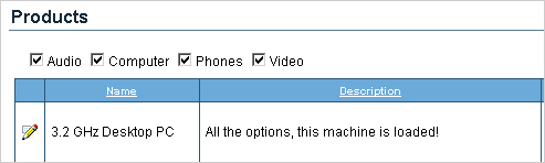

If you ran page 3 now, you would notice that the category check boxes are displayed vertically. Next, you need to change the display so that the category check boxes are displayed horizontally.
To display the category check boxes horizontally:
  1. Navigate to the Page Definition for page 3.
  2. Under Items, click P3_SHOW.
  3. Scroll down to List of Values.
  4. In Number of Columns, enter 4.
  5. At the top of the page, click Apply Changes.
    The Page Definition for page 3 appears.
  6. Click the Run Page icon in the upper right corner.
    Note the check boxes are displayed horizontally at the top of the page, as shown in Figure 6-5.
    Figure 6-5 Category Check Boxes Moved to Top of Page
    Description of Figure 6-5 follows
    Description of "Figure 6-5 Category Check Boxes Moved to Top of Page"

Description of "Figure 6-6 Product Page with Category Check Boxes and Go Button"
Change the Default Check Box Behavior
Although the category check boxes correctly filter the content on page 3, if you deselect all the check boxes, notice the report returns all products. This behavior results from the fact that if a check box has a NULL value (that is, it is deselected), then it defaults to the default value Y. The default value of Y, in turn, enables the check box.
You can alter this behavior by adding a computation that remembers the state of the check box.

Run the page again, deselect all the category check boxes, and then click Go. Notice that this time the report contains the expected result, that is, no returned records.
