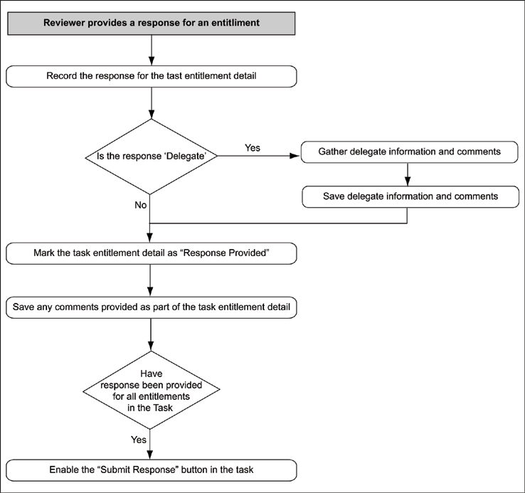

From the task details page, the reviewer would provide a response (optionally, with a comment) for each entitlement. This would also mark that attestation entitlement detail (within the task) as "Response Provided".
In case the reviewer's response to any of the entitlements was to "Delegate", then the reviewer would be taken through additional steps of providing the user to delegate the attestation activity to for those specific entitlements. Optionally, the reviewer could provide comments regarding why they are delegating the attestation activity to that user.
Once the reviewer has provided responses to all entitlements, they will be allowed to submit their action (commit) for the attestation task by submitting all responses.
Figure A-2 Flow of Events when Reviewer Responds to Entitlement
