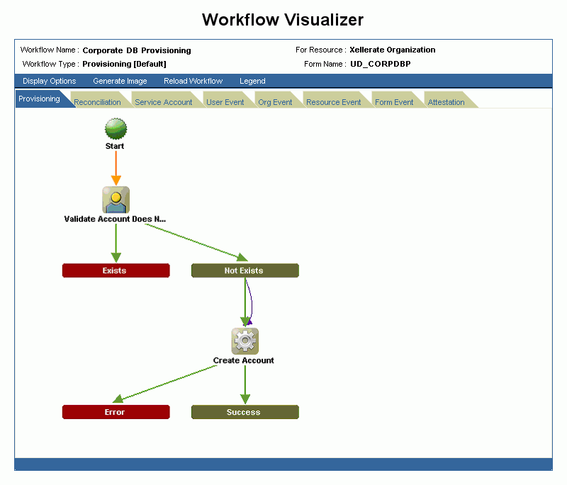

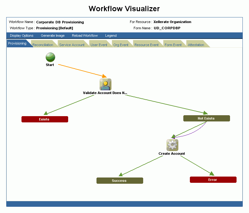

Using Drag and Drop
You can rearrange the graphical workflow by dragging and dropping the icon components that make up the workflow definition to any location in the workflow view. As you move an icon component, the direction arrow will continue to associate the link.
Figure 12-2 Using Drag and Drop in the Workflow Visualizer
Description of Figure 12-2 follows
Description of "Figure 12-2 Using Drag and Drop in the Workflow Visualizer"

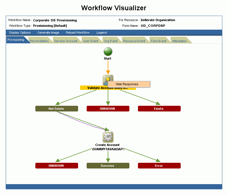

Using the Task Node (right-click menu)
When you right click the task node, the Hide Responses option appears. When you click this option the response sub-tree will collapse and replace it with an expansion node. The task node name (label) is highlighted in yellow to denote that it was collapsed. Once collapsed, the Hide Responses action option will not appear.
Figure 12-3 Using the Task Node (Right-Click Menu)
Description of Figure 12-3 follows
Description of "Figure 12-3 Using the Task Node (Right-Click Menu)"
