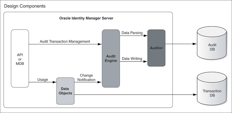

Figure 1-1 shows the design components of the auditing process.
Figure 1-1 Design Components of the Auditing Process
Description of Figure 1-1 follows
Description of "Figure 1-1 Design Components of the Auditing Process"
Any action taken in the Oracle Identity Manager system translates into an application programming interface (API) call, or an MDB picking up a message to process some action.Multiple changes could originate from this one action. All associated changes are tied together into one Audit Transaction. Each API method that can modify data objects calls the startTransaction method on the Audit Engine at the beginning of the API and the endTransaction method at the end of the method call, defining the Audit Transaction boundaries. The Audit Engine generates a transaction ID that is used to identify all changes made in that transaction.
