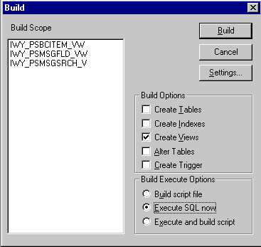

  8. To build the views in the project, select Build, and then select Project.
    The Build dialog box is displayed.
    Build dialog box
  9. In the Build Options pane, select Create Views.
  10. Select your site's customary option in the Build Execute Options pane. (In the previous figure, Execute SQL now is selected.)
  11. Click Build.
    The Application Designer displays a Build Progress status window.
    Build Progress dialog box

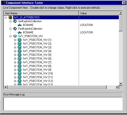

  4. Highlight one of the lines with its corresponding key in the Find Results window and click Get Selected. The relevant data for the selected key is displayed.
    If this window opens, the Component Interface has been successfully tested for the Find method.
    Component Interface Tester data
  5. Click Get Existing. For the Get method, an existing key must be entered.
    Component Interface Tester Get Method
    The exposed properties for the key that is entered are returned.
    If the following window opens, the Component Interface has been successfully tested for the Get method.
    Component Interface Tester - exposed key properties
