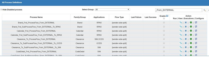

If you want to view the disabled flows, search for "_From_EXTERNAL" and uncheck the Hide Disabled process checkbox as shown below.

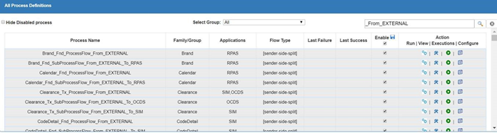

  1. Search for "_From_EXTERNAL" and uncheck the Hide Disabled process checkbox.
    Figure 4-1 View _From_EXTERNAL Processes
  2. Click the header checkbox to enable/disable. The default is disabled.
  3. Click a second time on the header checkbox to make it enable/disable. Click the Save icon. The flag is updated in the database to "true" or enabled.
    Figure 4-2 Enable _From_EXTERNAL Processes
    Follow the similar approach to enable external jobs as well.

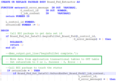

For each required interface, implement the logic in "extract" function of the "<InterfaceModule_Name>_Extractor_Body.sql" file as in the indicated section below. The sql file is located in the <bdi-edge-external-job-home>/setup-data/ddl/ folder.

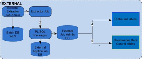

BDI Extractor (PL/SQL Application)
  1. The Extractor job is run from the App A (for example EXTERNAL) Extractor Job Admin application through REST or the UI.
  2. The Extractor job invokes the PL/SQL stored procedure in the App A database.
  3. A PL/SQL stored procedure is run in the App A database.
  4. The PL/SQL stored procedure moves data from transactional tables to the outbound tables in the BDI schema.
  5. The PL/SQL stored procedure inserts entries in downloader data control tables to indicate the data set is ready for download.

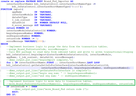

For each required interface, implement the logic in the "import" function of the "<InterfaceModule_Name>_Importer_Body.sql" file as in the indicated section below. The sql file is located in <bdi-edge-external-job-home>/setup-data/ddl/ folder.

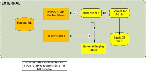

External Importer
  1. Importer job is run from App B EXTERNAL Job Admin application through REST or UI.
  2. Importer job checks for data sets in importer data control tables.
  3. If data set is available for import, importer job downloads data from inbound table.
  4. Importer job loads data to App B EXTERNAL staging tables.

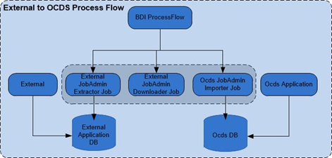

Figure 4-6 External Application to OCDs Process Flow
