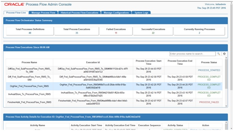

If the process flow app is successfully deployed, you should be able to access the application at the URL http://<host>:<port>/bdi-process-flow/. The following is a sample screenshot of the process flow application. Make sure all the tabs of the application are properly displayed.
See the Oracle Retail Bulk Data Integration Implementation Guide for the operation details of the Process Flow application.
