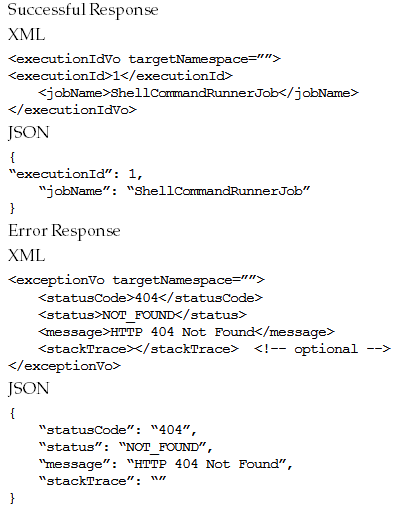

The Batch service is a RESTful service that provides various endpoints to manage batch jobs. Here are the key endpoints in the Batch Service.
Start Job
This endpoint starts a job asynchronously based on a job name and returns the execution ID of the job in the response. If the given job is disabled it throws the exception "Cannot start the disabled Job {jobName}. Enable the Job and start it."
Path: /batch/jobs/<jobName>
HTTP Method: POST
Inputs:
Job Name as path parameter
Job Parameters is a query parameter. Job Parameters is a comma-separated list of name value pairs. This is optional.
Sample Request
http://localhost:7001/jos-batch-job-admin/resources/batch/jobs/ShellCommandRunnerJob?jobParameters=key=value

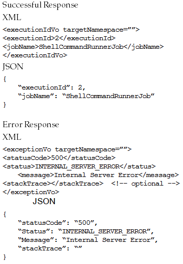

Restart Job
This endpoint restarts a job asynchronously using the job execution ID and returns the new job execution ID. If the given job is disabled it throws the exception "Cannot restart the disabled Job {jobName}. Enable the Job and restart."
Path: /batch/jobs/executions/{executionId}
HTTP Method: POST
Inputs: executionId as path parameter
Sample Request
http://localhost:7001/jos-batch-job-admin/resources/batch/jobs/executions/2

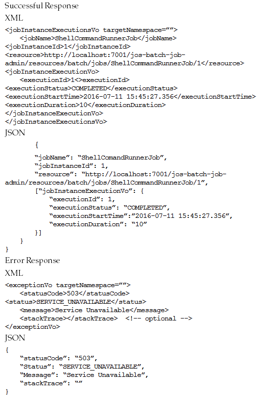

Inputs
jobName as path parameter
jobExecutionId as path parameter
Sample Request
http://localhost:7001/jos-batch-job-admin/resources/batch/jobs/ShellCommandRunnerJob/1
