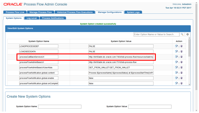

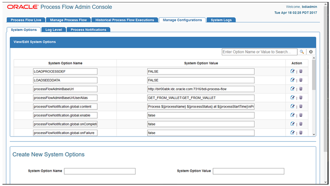

External Variables
Some of the system level configuration values are available in the externalVariables map. These values are read-only. The process flow DSL can use these values, but should not attempt to change it.
For example:
externalVariables["rxmJobAdminBaseUrlUserAlias"]

externalVariables
Implicit
def myVar = externalVariables['myKey']
These are global variables that apply to all process flows. It comes from System Options table. Installation specific key values will be here.

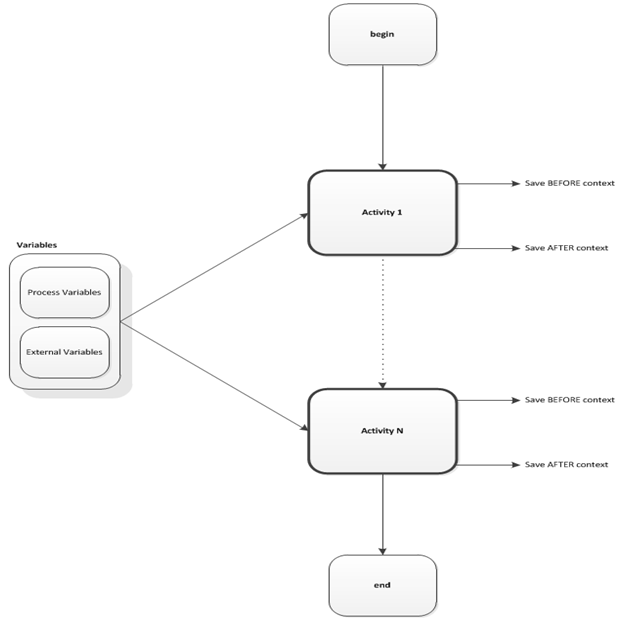

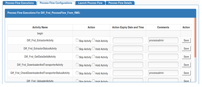

Process Flow Instrumentation
When the process engine executes the process flow, the before and after snapshots of the activity are recorded in the process schema.
The information is reported through the Process Flow Admin application. Process Flow Admin is a web application that provides a GUI to manage task workflows. This is useful for tracking the process flows as well as troubleshooting. The snapshots also help when restarting a failed process. From the schema, the process engine can recreate the context to execute a restart and can resume execution from the activity that failed in the previous run.

This table stores the user runtime choices like SKIP, HOLD, and so on, at the activity level

Skip Activity
Activities in a process flow can be skipped by setting the skip activity flag through the Process Flow Configurations screen or REST endpoint. The skip flag can be set to expire, based on date and time. If the expiration date is not provided, then that activity will be skipped until the skip flag is removed. When an activity is set to skip, the process flow engine skips that activity and runs the next activity in the flow.
Figure 4-2 Process Flow Configurations Screen
Surrounding text describes Figure 4-2 .
REST Endpoint to Set the Skip Activity Flag

Set up the callback URL in process flow system options. To configure a callback URL, you should add system options such as <serviceName>CallBackServiceUrl, for example, processCallBackServiceUrl.
  1. In the Process Flow Admin console, navigate to the Manage Configurations tab and the System Options sub-tab.
    Figure 4-3 Process Flow Admin Console Manage Configurations Tab
    Surrounding text describes Figure 4-3 .

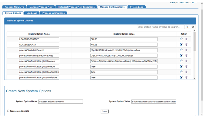

  2. Scroll down to Create New System Options and enter System Option Name and System Option Value. The URL must be a valid ReST Service.
    Figure 4-4 Create New Systems Options Section
    Surrounding text describes Figure 4-4 .
  3. Click Save.
    Figure 4-5 Saved System Options
    Surrounding text describes Figure 4-5 .

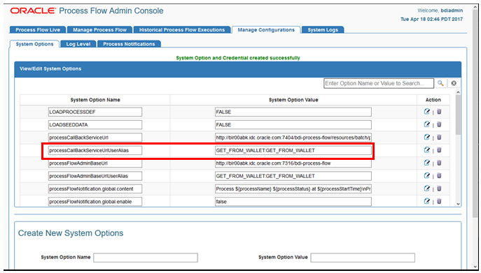

  4. Set up the callback URL credential alias in the process flow. To add the callback URL credential alias, you must add credential alias such as <serviceName>CallBackServiceUrlUserAlias, for example, processCallBackServiceUrlUserAlias.

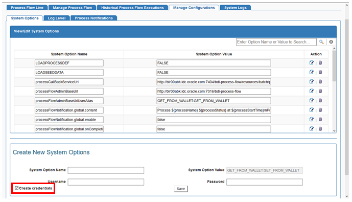

  5. In the Create New System Options section, select the Create Credentials check box.
    Figure 4-6 Create Credentials Check Box
    Surrounding text describes Figure 4-6 .

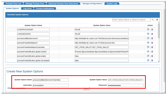

  6. Enter System Option Name, Username, and Password for the URL provided in the previous step. If the system option name for the URL is processCallBackServiceUrl, then the system option name for the credential must be processCallBackServiceUrlUserAlias.
    Figure 4-7 Entering URL Credentials
    Surrounding text describes Figure 4-7 .
  7. Click Save.
    Figure 4-8 System Option Name
    Surrounding text describes Figure 4-8 .
    Credentials created through the UI are available after a server restart; however, after the redeployment of the application, the credentials must be created again.

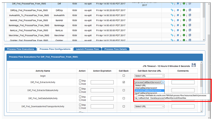

  8. Navigate to the Manage Process Flow tab and select process flow, then go to Process Flow Configurations sub-tab.
  9. Select Callback check box for the activities you want callback to be enabled for. Select Callback URL from the drop-down list.
    Figure 4-9 Configuring Callback Activities
    Surrounding text describes Figure 4-9 .

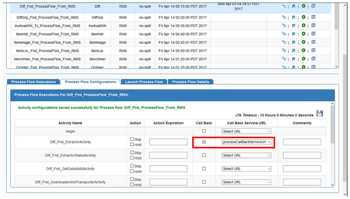

  10. Click Save.
    Figure 4-10 Saved Callback Service URL
    Surrounding text describes Figure 4-10 .

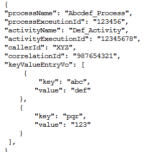

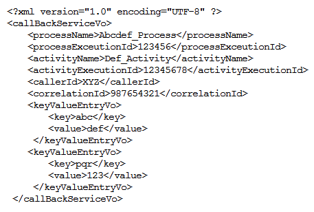

Callback Request Payload Structure
The JOS process flow will make a POST REST call to the callBackService URL, passing in the following payload. JSON is the default content type.
Figure 4-11 JSON Payload Contract
Surrounding text describes Figure 4-11 .
Figure 4-12 XML Payload Contract
Surrounding text describes Figure 4-12 .
