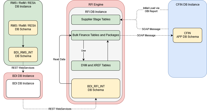

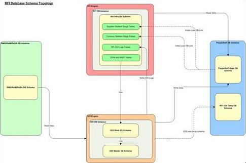

This topology diagram shows how different schemas are integrated with each other. There are three diagrams: one with EBS as integrating financial system, another with Oracle PeopleSoft as integrating financial system, and last one with Cloud Financials (CFIN) as integrating financial system.
