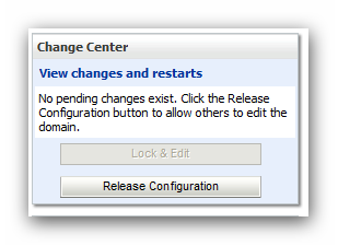

  3. Click Lock & Edit. Surrounding text describes new2.png.

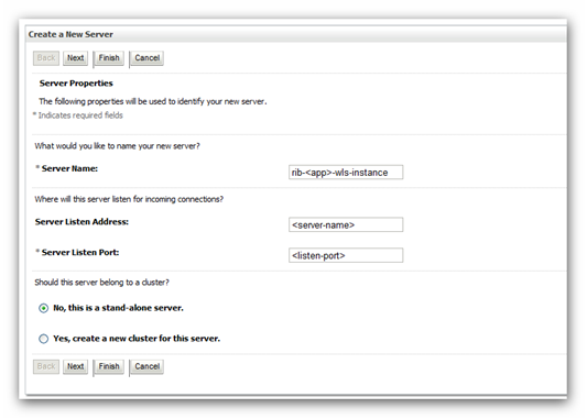

  4. Click New.
  5. Enter the name, port, and listen address of the server instance to be created.
    For example:
    • Server Name: rib-<app>-server
    • Server Listen Address: <server-name>
    • Server Listen Port: <listen-port> Surrounding text describes new3.png.
  6. Click Next. Click Finish. Make sure you see this instance listed under Servers

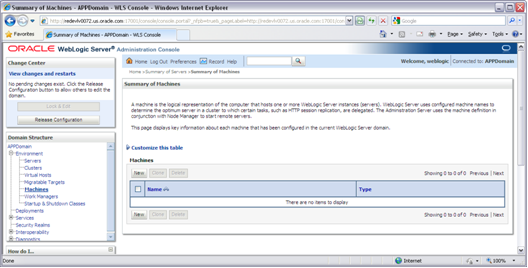

  2. Click Lock & Edit and navigate to Environments> Machines.
    Surrounding text describes node1.png.

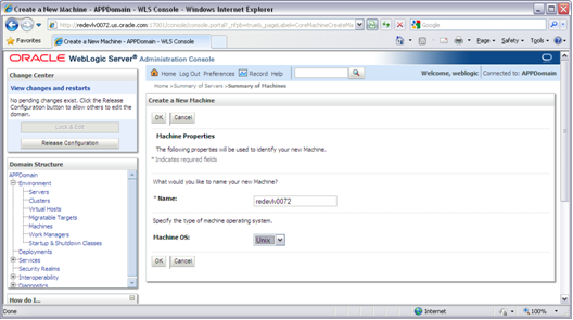

  3. Click New.
    Surrounding text describes node2.png.
  4. Set the following variables:
    • Name: Logical machine name
    • Machine OS: UNIX

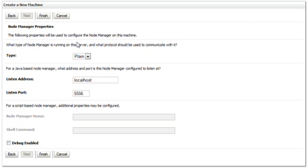

  6. Update the details below and click the Finish button.
    • Type: Plain
    • Listen Address: For example, ribhost.example.com
    • Listen Port: Default port (for example, 5556) or any available port
    Surrounding text describes create_newmachine.png.

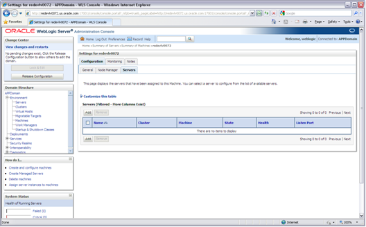

  9. Navigate to Environments > machines. Click on the machine name and select the Servers tab.
    Surrounding text describes node6.png.
  10. Add the managed servers that need to be configured with NodeManager. Save the changes.
