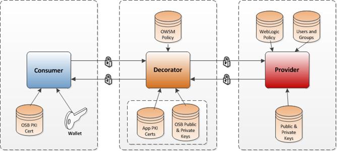

The RSB is an enterprise infrastructure for service oriented communication. RSB provides an architectural approach which involves Oracle Retail applications being exposed as ”Service Providers”, and OSB core components called ”Decorator Services” wrap the edge-app-services to provide virtualized and operational visibility to Oracle Retail services infrastructure. Lastly, the decorator services expose proxy WSDL's that are called by ”Service Consumers” which could be Retail applications or third party applications capable of making a SOAP invocation.
The RSB key components can be loosely coupled across platform, technology, and physical topologies. In order to establish an end-to-end security in RSB system, one has to secure all the intermediary layers that are part of a communication channel through RSB. As discussed earlier, there are three main layers, Service Provider, Decorator and the Service Consumer. Each of these must participate in configuring security in order to achieve effective security while making Web service calls.
Security decisions are mostly Service Provider driven; Decorators and Consumers will need to adhere to the chosen security mechanism by the provider in an integrated system. RSB provides numerous tools to ease the security configuration and automate the process which otherwise is quite cumbersome.

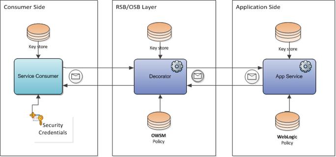

Securing an RSB system involves following components. Each of these components is a layer in the RSB security architecture.
Edge App Services
Decorator Business Services
Decorator Proxy Services
These services are deployed as part of ear files on the WebLogic server and it is not required to have Fusion Middleware components in that environment. In such environments, OWSM is not available to secure Web services. Therefore, these services are secured using the WebLogic Web service policies.
The decorator proxy and business services are deployed in an OSB server where OWSM components can be used for Web service policies. Therefore, decorator proxy and business services use those OWSM policies which are compatible with the WebLogic policies applied to edge app services.
The policy files for business and proxy services depend on which policy has been attached to the corresponding edge app service. Business service needs to be configured with an OWSM client policy file which is corresponding to the policy file attached to the edge app service. The proxy services need to be configured with an OWSM service policy file that should have configuration matching with edge app policy file. The client of the proxy service needs to use a client policy file which matches the service policy for OSB proxy service.

The proxy service processes the header in the client's SOAP messages and enforces the message-level access control policy on the messages.
For example, a client encrypts and signs its SOAP message and sends it to a proxy service. The proxy service decrypts the message and verifies the digital signature, then routes the message. Before the proxy service sends the response back to the client, the proxy service signs and encrypts the message. The client then decrypts the message and verifies the proxy service's digital signature.
Instead of processing the header in the client's SOAP messages, the proxy service passes the message untouched to a business service. Although the proxy service does not process the secured sections of the SOAP message, it can route the message based on values in the header. When the business service receives the message, it processes the security header and acts on the request. Note that the business service must use the Web Services Policy (WS-Policy) framework to describe which of its operations are secured with message-level security. The business service sends its response to the proxy service, and the proxy service passes the response untouched to the client.
For example, the client encrypts and signs the message and sends it to the proxy service. The proxy service does not decrypt the message or verify the digital signature; it simply routes the message to the business service. The business service decrypts the messages and verifies the digital signature, and then processes the request. The response path is similar.

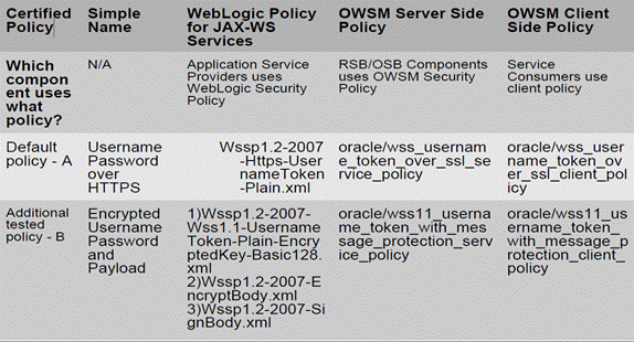

There are two types of security configurations certified for RSB by Oracle Retail. For ease of use these are classified and referred in this document as Policy A and Policy B.
Each of these certified approaches involve a set of security policies. The following table describes the required set of policies for Policy A and B.

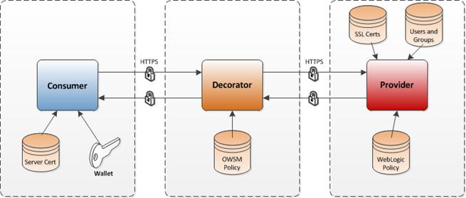

Policy A is a Username Token over HTTPS. This security configuration is referred to as Policy A in this document.
Wssp1.2-2007-Https-UsernameToken-Plain.xml
Policy A is selected as the default policy for the following reasons:
Most widely (SSL) used policy
Easy to configure and setup
Data going over the wire is encrypted and is secure
Interoperable between WebLogic and OWSM policy
Good performance for the level of security provided
Good support from all programming languages
Policy B is a Message Protection plus username token. This security configuration is referred to as Policy B in this document.
Wssp1.2-2007-Wss1.1-UsernameToken-Plain-EncryptedKey-Basic128
Wssp1.2-2007-EncryptBody
Wssp1.2-2007-SignBody
