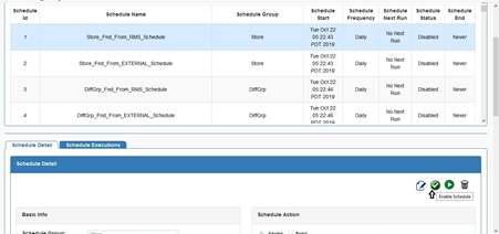

To enable the schedule using the User Interface:

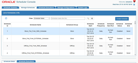

Login to the BDI scheduler web application.
Navigate to the Manage Schedules tab.
Select the Schedule in the List of Schedules table.
Go to the Schedule Detail Tab below the table.
Click on the Enable Schedule Icon on the top right of the Schedule Detail Panel.
