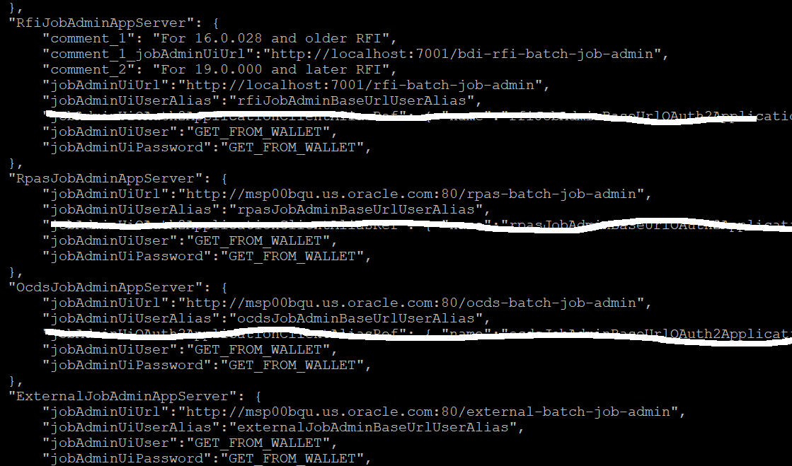

Edit the rms job configuration file to point to deployment environment (conf/bdi-job-admin-deployment-env-info.json) as follows:
To deploy without OAuth, we need to rename or remove the OAuth2 aliases for example:- jobAdminUiOAuth2ApplicationClientAliasRef from bdi-job-admin-deployment-env-info.json, and then deploy. No other extra steps needed for deployment. See How to Install BDI without IDCS.
cd bdi-edge-rms-job-home/conf vi bdi-job-admin-deployment-env-info.json
Provide the following values in the JSON file.

JobAdminAppServer -> jobAdminUiUrl |
Job Admin URL of BDI RMS http://<host>:<managed server port>/bdi-rms-batch-job-admin |
dataSourceProperties |
DataSource configurations contributes to the performance of the applications at the runtime. Ex: "connectionPool_MaxCapacity":"100" "general_RowPreferfetchSize":"100" |
RpasJobAdminAppServer -> jobAdminUiUrl |
Job Admin URL of BDI RPAS http://<host>:<rpas managed server port>/rpas-batch-job-admin |
SimJobAdminAppServer -> jobAdminUiUrl |
Job Admin URL of BDI SIM http://<host>:<sim managed server port>/sim-batch-job-admin |
RfiJobAdminAppServer-> jobAdminUiUrl |
Job Admin URL of BDI RFI http://<host>:<sim managed server port>/bdi-rfi-batch-job-admin |
OcdsJobAdminAppServer -> jobAdminUiUrl |
Job Admin URL of BDI RFI http://<host>:<ocds managed server port>/ocds-batch-job-admin |
ExternalJobAdminAppServer -> jobAdminUiUrl |
Job Admin URL of BDI RFI http://<host>:<external managed server port>/external-batch-job-admin |
oauth2AuthorizationServerUrl |
Provide the IDCS url For example - https://idcs-4ff493196128425c80ce4ecbfc8352e5.identity.c9dev1.oc9qadev.com/oauth2/v1/token |
jobAdminUiOAuth2ApplicationClientAliasRef |
ICDS Client secret ID and password "name":"simJobAdminBaseUrlOAuth2ApplicationClientAlias", "value": "*simOauth2ApplicationClientAlias" |
"name":"rfiJobAdminBaseUrlOAuth2ApplicationClientAlias", "value": "*ricsOauth2ApplicationClientAlias" |
"name":"rpasJobAdminBaseUrlOAuth2ApplicationClientAlias", "value": "*rpasOauth2ApplicationClientAlias" |
ICDS Client secret ID and password "name":"ocdsJobAdminBaseUrlOAuth2ApplicationClientAlias", "value": "*ricsOauth2ApplicationClientAlias" |

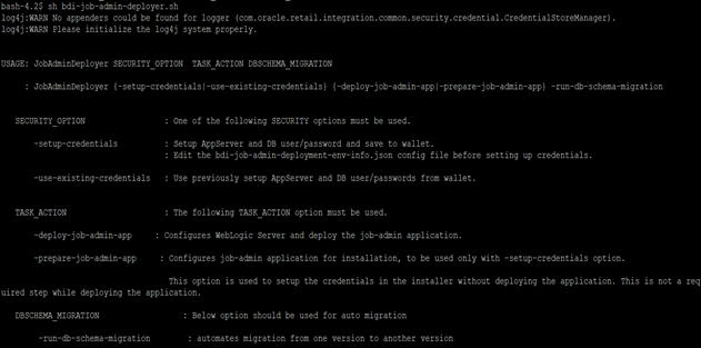

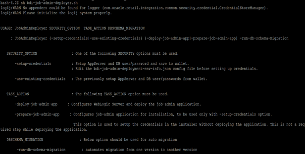

Run the deployer script to create the data sources and deploy BDI RMS Batch Job Admin. While deploying, the user needs to provide the IDCS client secret ID & password for ricsOauth2ApplicationClientAlias, mfcsOauth2ApplicationClientAlias, rpasOauth2ApplicationClientAlias
cd bdi-edge-rms-job-home/bin bdi-job-admin-deployer.sh -setup-credentials -deploy-job-admin-app
Enter the values prompted by the script for following credentials aliases. JobAdmin user has more privileges (e.g change configuration and run jobs from JobAdmin UI) than JobOperator user. JobOperator can run batch jobs where as JobMonitor has just read privileges.

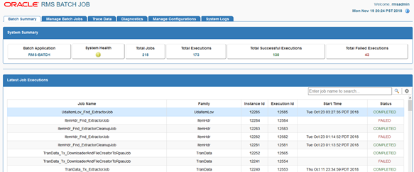

After you deploy to the server successfully, BDI RMS Batch Job Admin can be accessed using the following URL:
http://<server>:<port>/rms-batch-job-admin
Log in using credentials provided during the installation and verify that jobs are displayed in the Manage Batch Jobs tab and configuration is displayed in the Manage Configurations tab.

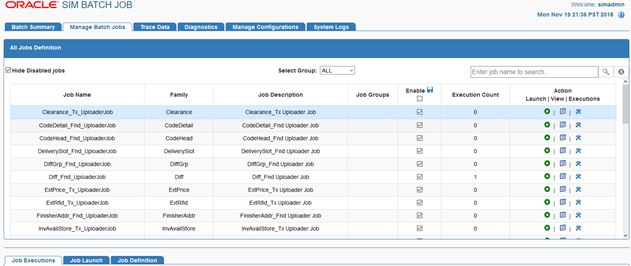

After you deploy to the server successfully, the BDI SIM Batch Job Admin can be accessed using the following URL:
http://<server>:<port>/sim-batch-job-admin

The following changes have been introduced to the BDI Edge RMS Job Admin Configuration file in 19.0.1 Release
For BDI RFI the application has been renamed from BdiIntJobAdminPak<VERSION>ForRfi<VERSION>_eng_ga.zip to BdiEdgeAppJobAdminPak<VERSION>ForRfi<VERSION>_eng_ga.zip, due to this change the BDI RMS Configuration for BDI RFI has also changed:
"RfiJobAdminAppServer": {
"comment_1": "For 16.0.028 and older RFI",
"comment_1_jobAdminUiUrl":"http://localhost:7001/bdi-rfi-batch-job-admin",
"comment_2": "For 19.0.00019.0.1 and later RFI",
"jobAdminUiUrl":"http://localhost:7001/rfi-batch-job-admin",
"jobAdminUiUserAlias":"rfiJobAdminBaseUrlUserAlias",
"jobAdminUiUser":"GET_FROM_WALLET",
"jobAdminUiPassword":"GET_FROM_WALLET",
