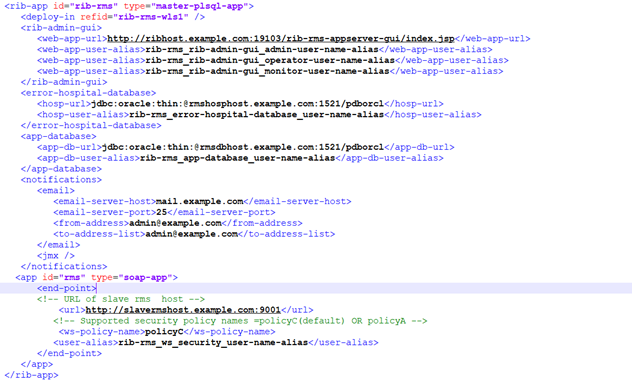

Following is the hybrid cloud installation section for rib-rms.
Example (this is also available on deployment XML):

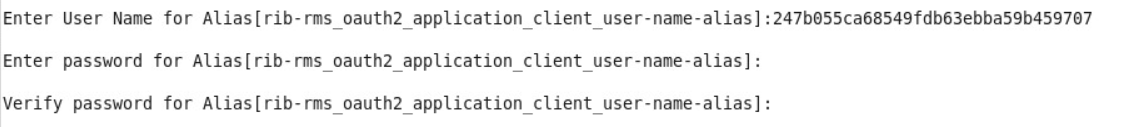

Note: RMS retail app type is "rest-app". RIB app (rib-rms) type is "master-plsql-app". RIB will use IDCS OAuth2 for authentication of ReST calls both inbound and outbound(publisher/injector restful services). Although, the basicAuth will also be supported to maintain backward compatibility and to support on-prem requirements, primary authentication mechanism in the cloud would be OAuth2 using IDCS authenticator. Out of the box configuration would expect OAuth2 to be used. |
Compile: Run the rib-home/application-assembly-home/bin/rib-app-compiler.sh script with setup-security-credential from rib-home/application-assembly-home/bin directory.
Example: ./rib-app-compiler.sh -setup-security-credential
For rib-rms give the same schema details for Error Hospital (EH) and app-DB

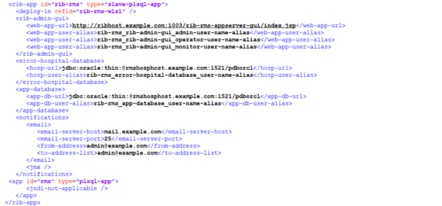

Make sure following entries are present in the rib-app section of rib-rms slave:

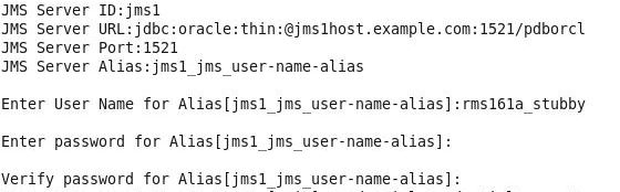

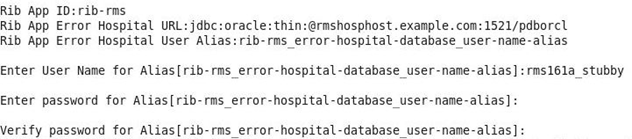

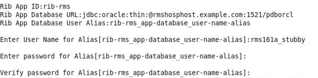

Compile: Run the rib-home/application-assembly-home/bin/rib-app-co mpiler.sh script with setup-security-credential from rib-home/application-assembly-home/bin directory. Example: ./rib-app-compiler.sh -setup-security-credential
When the slave app deploys on-premise, it will not have access to AQ JMS and Error hospital. Therefore, both datasources must connect to the RMS app schema.
