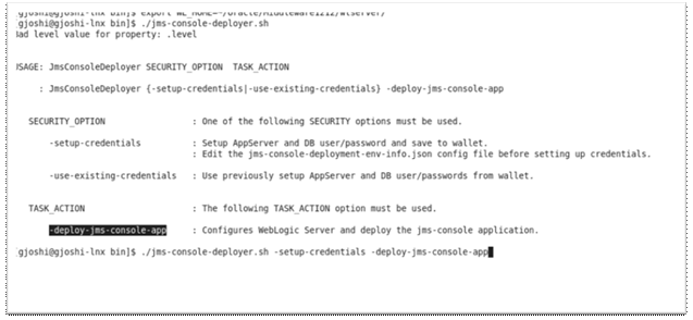

  6. Run the deployer script to create the datasource and deploy JMSconsole.
    $ cd jmsconsole/bin/
    $ sh jms-console-deployer.sh -setup-credentials -deploy-jms-console-app
    Surrounding text describes image049.gif.
  7. Enter the parameter value prompted by the script.
  8. Bounce the WebLogic server hosting JMS Console application.
