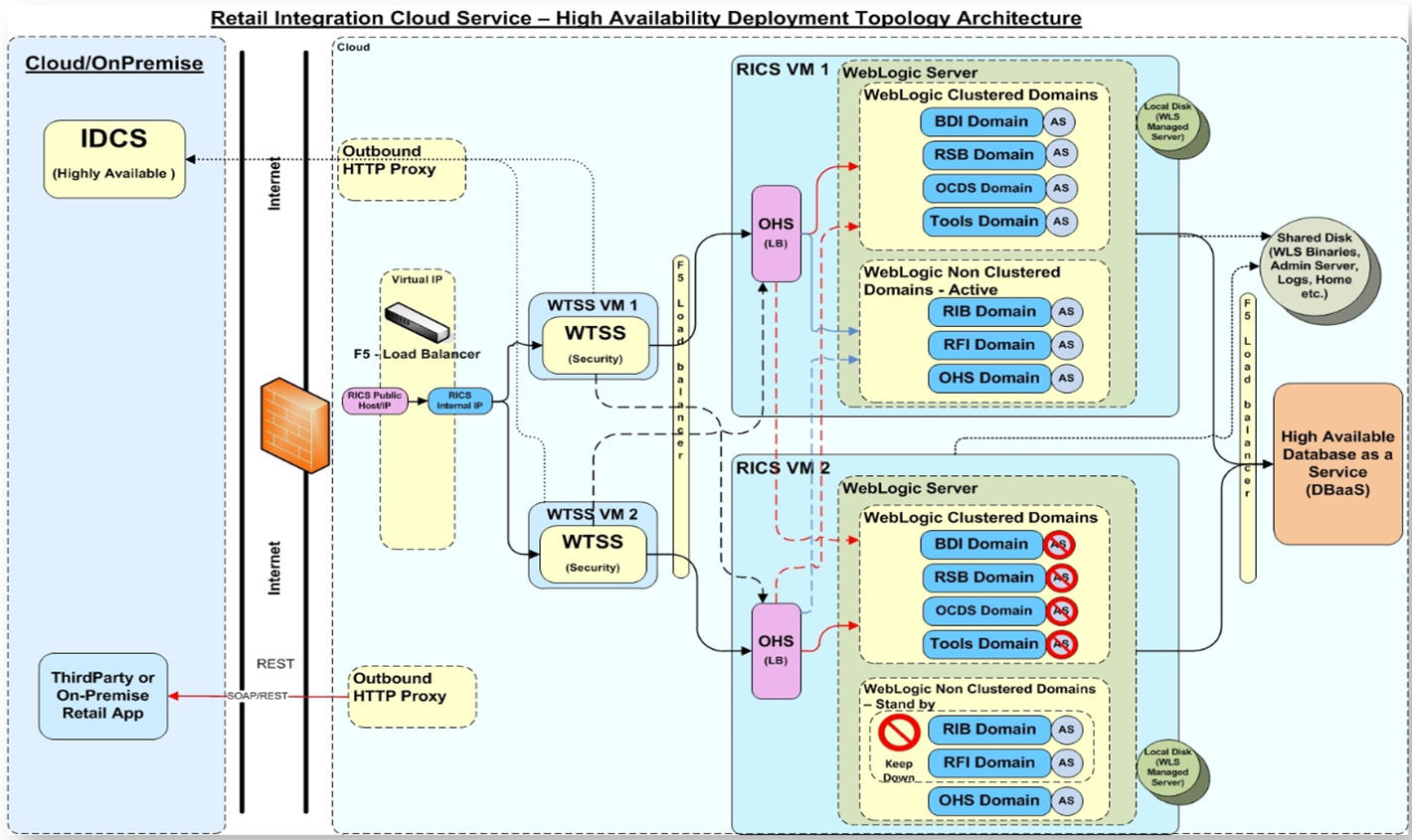

RIB High Availability Requirements
RIB is usually considered a high availability (HA) requirement, so an architecture and operations plan to handle this need is developed.
Description
To fulfill the HA requirement for RIB, a useful feature was added to RIB that allows using single rib-home for multiple environments. There is a new script added in rib-home for setting up multiple environment from same rib-home. This script must be run before rib-app compilation. There will be different deployment file for each environment. For example, there are two WebLogic domains available: say node1 in RICS VM1 and node2 in RICS VM2. To deploy RIB on these two servers, rename the specific deployment file for that with an extension sample below.
  • rib-deployment-xml.node1
  • rib-deployment-xml.node2
Then, before compilation, run the script to specify which environment you want to deploy to.
For example: select-deployment-options.sh -deployment-file-extension {active|passive|node1|node2} -set-adapter-status {adapter-up|adapter-down} -for-rib-app {all|rib-rms|rib-sim}
Usage:
  • deployment-file-extension is a required parameter and a file name needs to be passed for value. For example, if node1 is passed as a value for this parameter, rib-deployment-env-info.xml.node1 will be used for deployment configuration.
  • set-adapter-status is optional. Default is up. If this option is not provided, there won't be any change in the initial state of the adapters. If adapter-up is provided for this parameter, the initial state of all the adapters will be changed from stopped to running and vice versa.
  • for-rib-app is an optional parameter. Default is all.
Surrounding text describes highavaildeployarch.jpg.
See the Oracle Retail Integration Bus Installation Guide: RIB High Availability Installation Instructions
See the Oracle Retail Integration Bus Installation Guide: The RIB and Oracle Database Cluster (RAC)

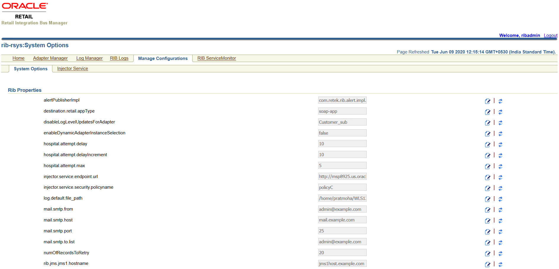

The RIB administration GUI provisions updating the above configuration files:
  1. RIB Properties - The System Options tab in Manage Configuration lists all the RIB properties available for update at runtime. Any updates to properties here is stored in database runtime table. See chapter "Backend System Administration and Logging" for a detailed description of all the RIB properties and what users should and should no update.
    RIB Properties

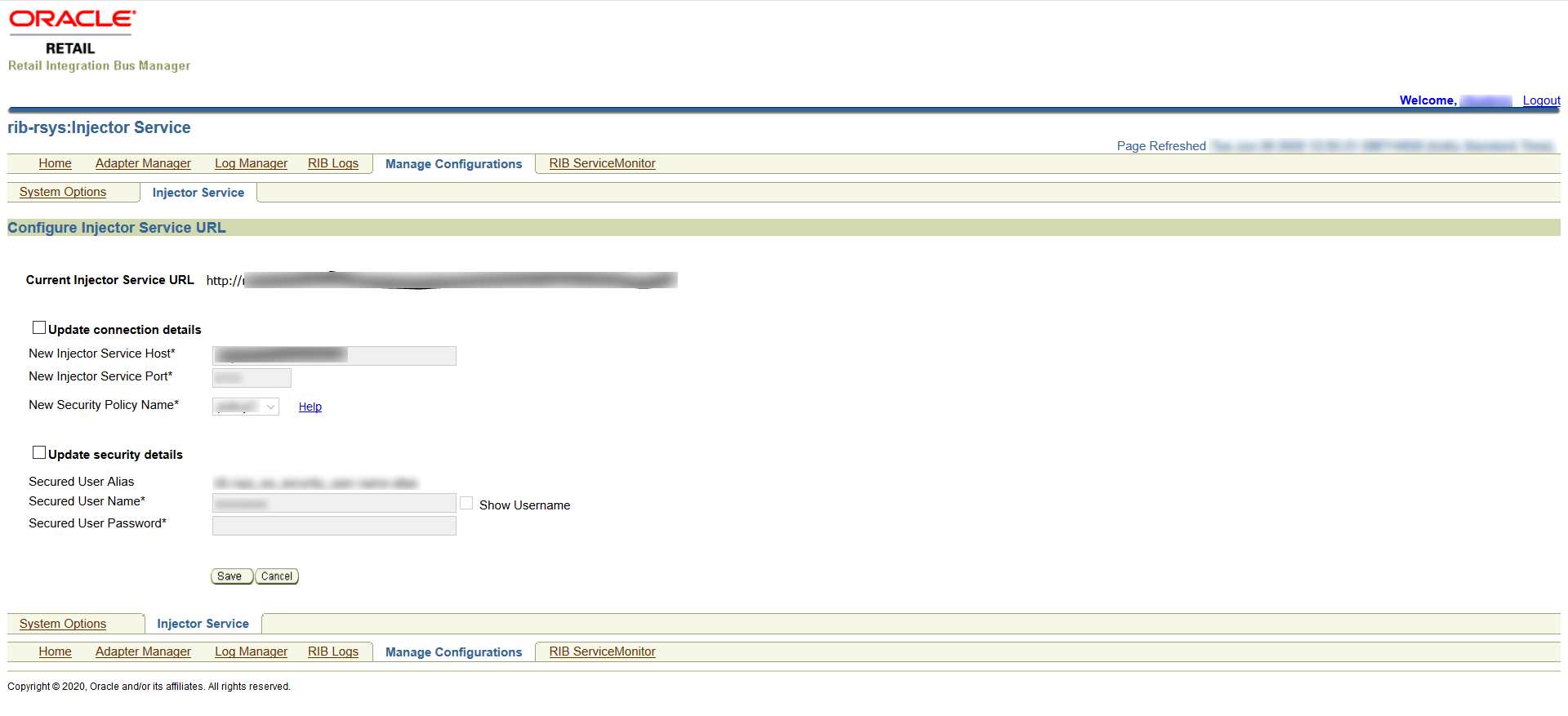

  2. Injector Service - The Injector Service tab in Manage Configurations exposes the injector service end-point URL for primary-secondary, rest-app and soap-app. Any updates to the end-point URL and policy name will persist in the runtime table.
    Surrounding text describes inject_serv.png.

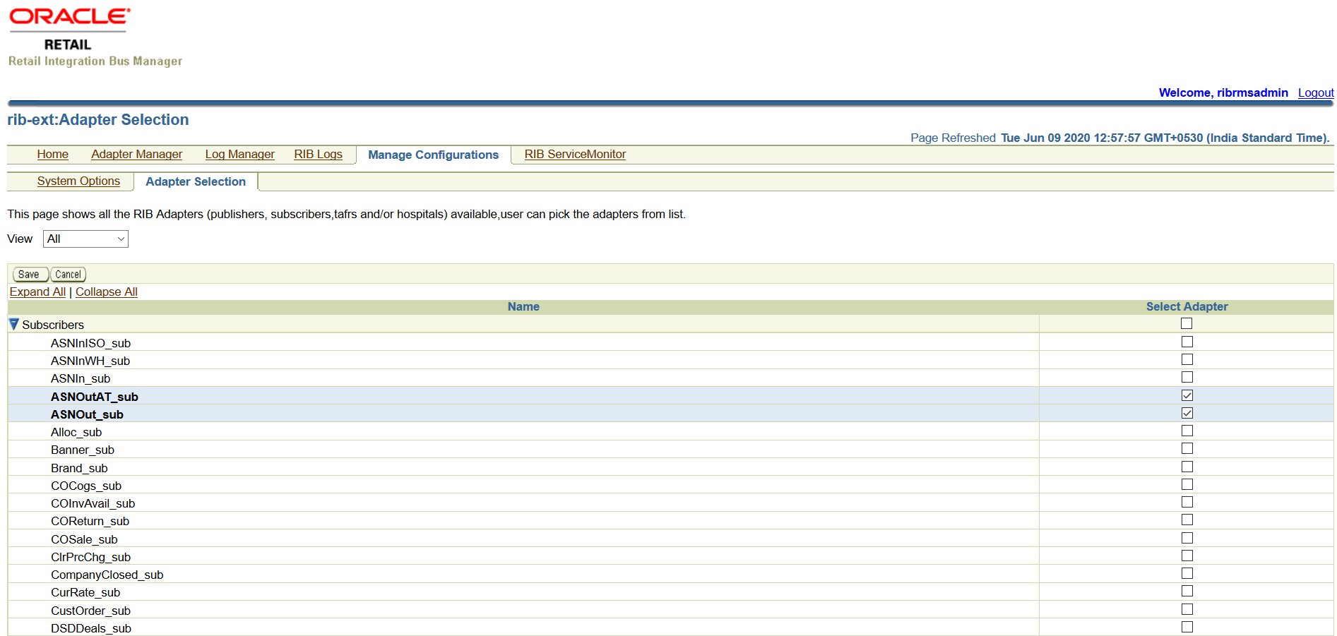

  3. Adapter Selection - The Adapter Selection tab under Manage Configurations allows users to pick a small set of adapters at runtime for rib-ext. The selected adapters list is written to the runtime table.
    Surrounding text describes adapt_select.png.

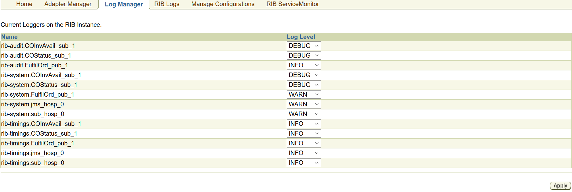

  4. Log Level Change -To update the log level for any RIB application logger, you can login to the RIB Admin GUI, go to Log Manager then select the needed log level against each logger, then click Apply. The selected log level for each logger is persisted into the RUNTIME_OVERRIDE_CONFIG table in the RIB error hospital schema. These values are persisted across restart and re-deployment of rib-applications.
    Until the previous version, the log levels were persisted to log4j.xml.But from this version onwards, the log levels for the loggers will not be persisted to the file log4j2.xml, and instead they will persist into database to facilitate upgrades.
    The log levels for many adapter logs are initially loaded from the lof4j2.xml file when the managed server starts. Further, if any override log-level value exists for the logger in the RUNTIME_OVERRIDE_CONFIG table, the log level is updated to this value on application startup. The RIB LogManager UI will show these log levels.
    Surrounding text describes log_lvl_chg.png.

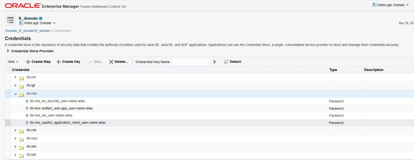

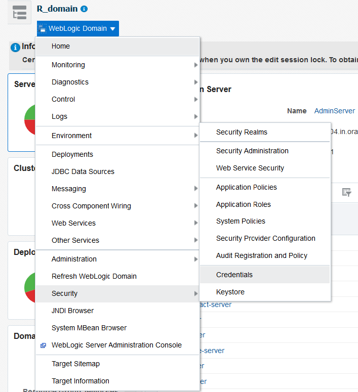

RIB Runtime Credentials Persist in Database Store Instead of File System (Wallet Files)
RIB uses a database store instead of wallet files for storing runtime credentials. There are no changes in the installer to support this. Compilation and deployment steps remains same as before. During the rib-<app> deployment, the deployer creates runtime credentials in the database store instead of copying the wallet files from the managed server home. These runtime credentials can be viewed from WebLogic Enterprise Manager console:
  1. Log into the WebLogic Enterprise Manager.
  2. Click Domain -> Security - > Credentials.
    Surrounding text describes open_credentials_menu.png.
  3. Open appTag to view or edit credentials.
    Surrounding text describes credentials_list.png.
