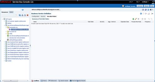

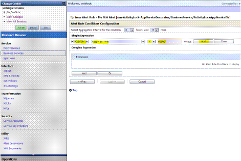

Both Business (pipeline) and Service (SLA) alerts can be added either through OSB console or programmatically. If the alert is added through OSB console, the alert configuration will get overwritten when the OSB project is redeployed. So it is recommended to add only temporary alerts through OSB console. Any alerts that are permanently needed must be added programmatically. SLA alerts are added at the proxy or business services. Pipeline alerts are added to the message flow. Take the following steps to add an SLA alert to a business service:
Click on the Business Services link in Resource Browser of OSB console.
Click the service for which you want to add the alert.

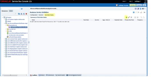

Select the SLA Alert Rules tab. Click Add.

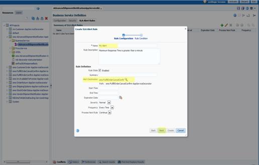

Enter Rule Name and Alert Destination corresponding to the decorator.

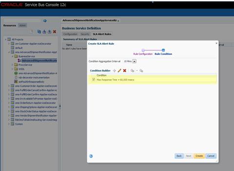

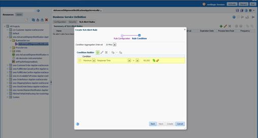

Construct the Alert Rule Condition as shown in the following screen:

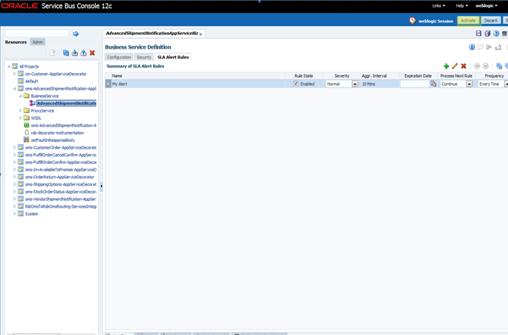

Save the alert and activate the session.
Click Update and then Create.
Activate the session.
