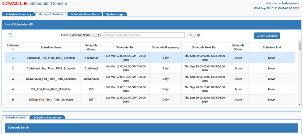

  2. Launch the Scheduler admin app via the URL - http://<host>:<port>/bdi-scheduler/
  3. Verify you are able to access the URL by logging in using the admin or operator role.
  4. Verify that the list of schedules (created from seed data) is displayed in 'Manage Schedules' page of the app.
  5. All schedules in BDI are in 'DISABLED' state by default. To enable the schedules, the user can enable them in the UI. Refer to Appendix B, " Appendix: Enabling BDI Schedules".
  6. Ensure that all the schedules are in 'Disabled' status.
  7. A schedule can be in 'Disabled' status if no schedule action is loaded for the corresponding schedule or if the schedule action contains any forbidden keyword. The user needs to correct the schedule action and enable the schedule. For more details on this, please refer to the Oracle Retail Bulk Data Integration Implementation Guide.
    Surrounding text describes batchsch-console.png.

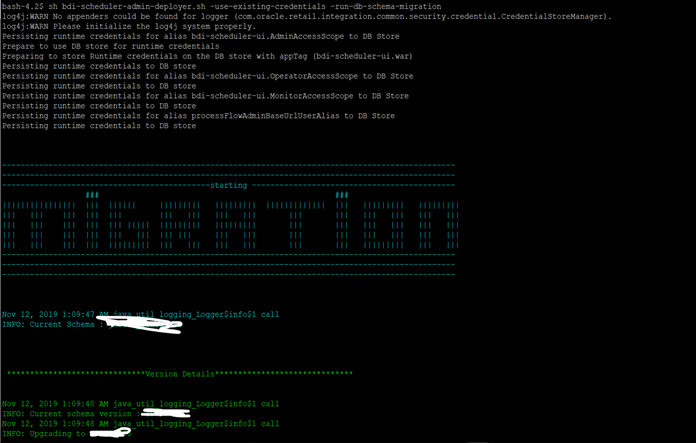

  5. Run the below command to upgrade and deploy the scheduler app.
    Cd scheduler-home/bin
    sh bdi-scheduler-admin-deployer.sh  -use-existing-credentials -run-db-schema-migration -deploy-scheduler-admin-app
    upgrade and deploy scheduler app
  6. After successful deployment, bounce the scheduler managed server.
