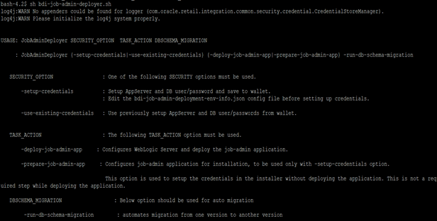

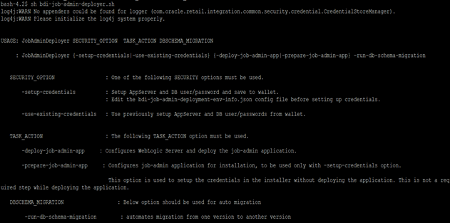

  1. Download BdiEdgeJobAdminPak21.0.000ForRms21.0.000_eng_ga.zip to $BDI_HOME.
  2. Unzip the downloaded archive.The Bdi Job home directory will be created under the current directory.
    unzip BdiEdgeJobAdminPak21.0.000ForRms21.0.000_eng_ga.zip
    This command extracts the archive. The relevant directories for the installation are shown (There are more directories than what is shown).

  5. Run the deployer script to create the data sources and deploy BDI RMS Batch Job Admin. While deploying, the user needs to provide the IDCS client secret ID & password for ricsOauth2ApplicationClientAlias, mfcsOauth2ApplicationClientAlias, rpasOauth2ApplicationClientAlias
    cd bdi-edge-rms-job-home/bin
    bdi-job-admin-deployer.sh -setup-credentials -deploy-job-admin-app
    BDI deploy

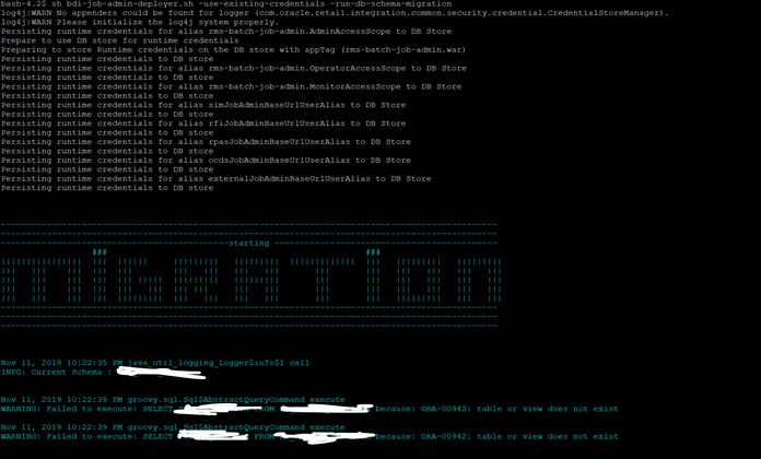

    If you have already configured the credentials and can use the same credentials (typically when redeploying the app), you can run the deployer with the -use-existing-credentials option as follows, and you will not be prompted for the credentials again for the deployment.
    bdi-job-admin-deployer.sh -use-existing-credentials -deploy-job-admin-app

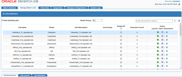

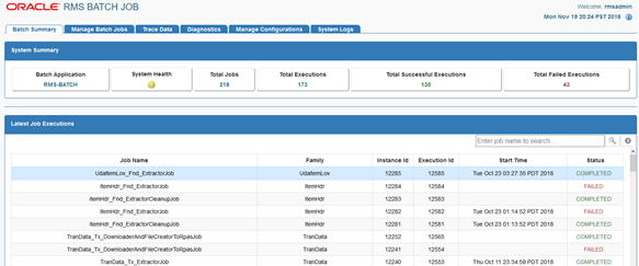

Testing the Deployment
After you deploy to the server successfully, BDI RMS Batch Job Admin can be accessed using the following URL:
http://<server>:<port>/rms-batch-job-admin
Log in using credentials provided during the installation and verify that jobs are displayed in the Manage Batch Jobs tab and configuration is displayed in the Manage Configurations tab.

  5. Run the deployer script to create the data sources and deploy BDI SIM Batch Job Admin.
    cd bdi-edge-sim-job-home/bin
    deployer

After you deploy to the server successfully, the BDI SIM Batch Job Admin can be accessed using the following URL:
http://<server>:<port>/sim-batch-job-admin

  3. Login to the BDI Edge Job App (Example: http://host:17011/rms-batch-job-admin)

  9. Deploy the BDI Edge job app using -setup-credential option (Follow BDI Installation Guide). -use-existing-credential option will not work the first time, since there is a new entry (IDCS client credentials) now. While deploying user needs to provide the IDCS client secret ID & password for ricsOauth2ApplicationClientAlias, mfcsOauth2ApplicationClientAlias, rpasOauth2ApplicationClientAlias. Cd to <appName>-job-home/bin and run the below command to upgrade and deploy the bdi job app.
    sh bdi-job-admin-deployer.sh -use-existing-credentials } -run-db-schema-migration -deploy-job-admin-app
    Database schema auto migration feature should be used from >=16.0.028 version.
    deploy BDI Edge

  11. Login to BDI Edge Job App and make sure no error is displayed in any of the pages.

In case any similar errors like ORA-00942: table or view does not exist Verify if the corresponding tables present in the schema or not, as there are cases where Bdi<App>ReceiverServiceDataSource and Bdi<App>JobAdminDataSource might have configured to different schemas.RTG maintains only one migration script for upgrades. Please ignore those errors.
