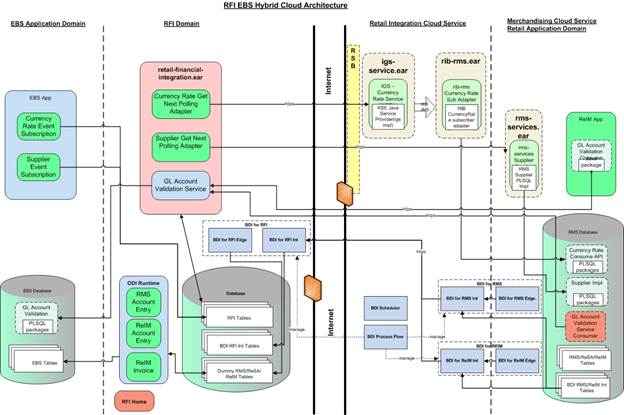

Problem: Most of the Retail applications (RMS/ReIM) are on cloud but EBS is on premises. It utilizes a hybrid cloud model for the integration to happen. There is a limitation in hybrid cloud integration. ODI has issues interacting with remote database tables using JDBC.
Solution: Oracle Retail Bulk Data Integration (BDI) is able to move the data from one end (source) to the other end (destination) using REST service calls. This moves the retail schema data from the cloud to the on-premises retail proxy schema where ODI looks for further data processing. BDI implementation has to take place at the retail application side (RMS, REIM and retail integration application, RFI).
The Oracle Retail Financial Integration (RFI) layer serves as an intermediate thin layer of application between the financial application (EBS) and the Oracle Retail applications. This integration remains synchronized with the Edge applications.
The RMS-Edge application (sender side) jobs are used to read the data from the retail schema (RMS) tables and write the data to the outbound tables of the integration schema. The BDI-RMS jobs are used to read data from the outbound tables and write to csv files.
The BDI-RFI application (receiver side) includes uploader and importer jobs. The uploader job moves the data from the csv files to the retail proxy schema inbound tables. Once data is available in the inbound tables, the importer job moves the data from the inbound tables to invoice matching financial tables. After moving the data to the retail proxy schema, ODI scripts transfer the data to DVM and EBS tables.

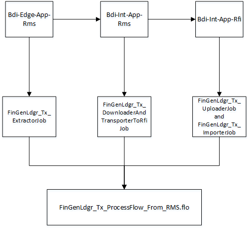

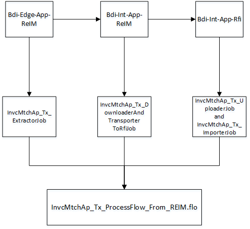

There are three different process flows for this integration.
InvcMtchAp_Tx_ProcessFlow_From_RMS.flo: Launching this process moves data from the Im_Ap_Stage_Head and Im_Ap_Stage_Detail tables of the RMS schema (cloud side) to the same tables present in the RMS proxy schema (on-premises). InvcMtchAp_Tx_UploaderJob post importer activity transfers from RMS proxy schema to EBS schema.
InvcMtchFin_Tx_ProcessFlow_From_RMS.flo: Launching this process moves data from the Im_Financials_Stage table of the RMS schema (cloud side) to the same table present in the RMS proxy schema (on-premises). InvcMtchFin_Tx _UploaderJob post importer activity transfers from RMS proxy schema to EBS schema.
FinGenLdgr_Tx_ProcessFlow_From_RMS.flo: Launching this process moves data from Stg_Fif_Gl_Data table of the RMS schema (cloud side) to the same table present in the RMS proxy schema (on-premises). FinGenLdgr_Tx _UploaderJob post importer activity transfers from RMS proxy schema to EBS schema.
