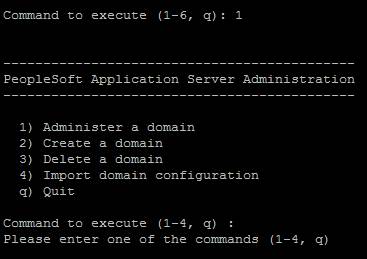

  2. To verify the Pub/Sub parameter value:

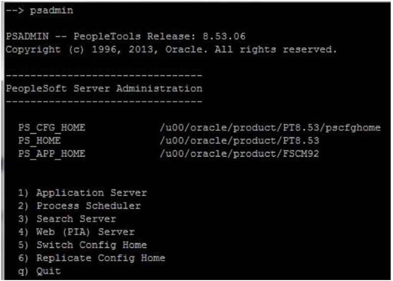

    1. Access the PSADMIN Quick-Configure menu by launching psadmin.sh from the PS_HOME\appserv directory
      Surrounding text describes image001_chap8.jpg.
    2. Select option 1 [Application Server]
      Surrounding text describes image002_chap8.jpg.

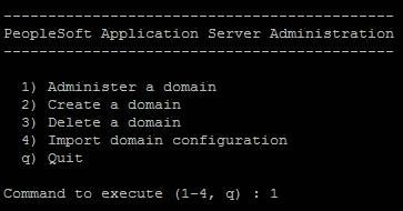

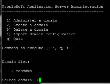

    3. Select Option 1 [Administer a domain]
      Surrounding text describes image003_chap8.jpg.
    4. Select the domain to configure [E.g. - fscmdmo].
      Surrounding text describes image004_chap8.jpg.

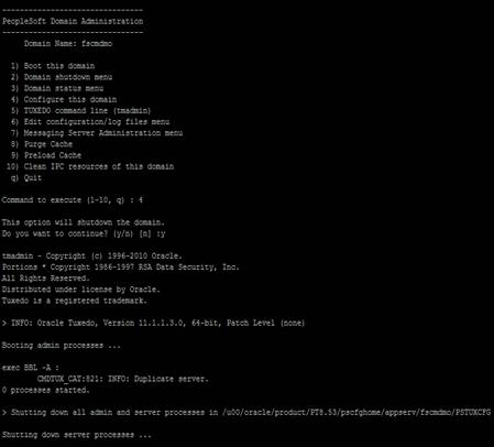

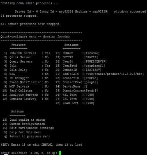

    5. Select Option 4 [Configure this domain]
      1. The system will prompt "This option will shut down the Domain. Do you want to continue? (y/n) [n] :"
      2. Select "y" to shut down the domain
      Surrounding text describes image005_chap8.jpg.
      Surrounding text describes image006_chap8.jpg.

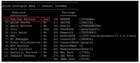

    6. Confirm that Pub/Sub Servers parameter value is set to Yes. If not select 1 to change the value to Yes.
      Surrounding text describes image007_chap8.jpg.

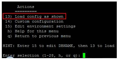

    7. If the value is changed ,select option 13 to load the new configuration. If it is not changed, select q to return to previous menu.
      Surrounding text describes image008_chap8.jpg.

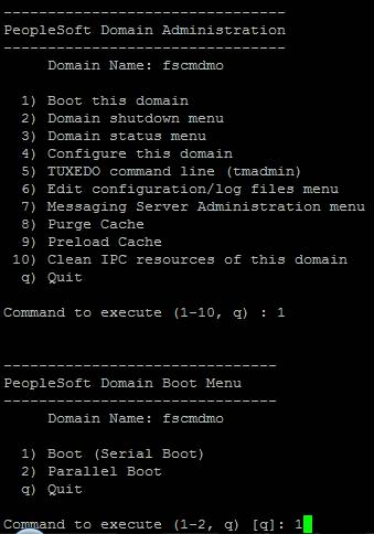

    8. Select Option 1 to boot the domain.
      1. System will prompt for user Options
        1) Boot (Serial Boot)
        2) Parallel boot
        q) Quit
      2. Select Option 1 [Serial Boot] to boot.
        Surrounding text describes image009_chap8.jpg.

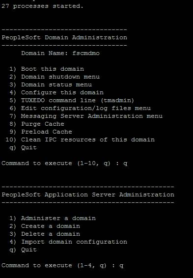

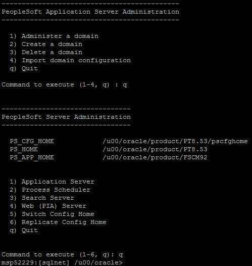

      3. Exit from Configuration
        1. Enter q to exit from Domain Administration menu
        2. Enter q to exit from Application Server Administration menu
        3. Enter q to exit from PeopleSoft Server Administration menu
        Surrounding text describes image010_chap8.jpg.
        Surrounding text describes image011_chap8.jpg.

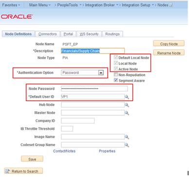

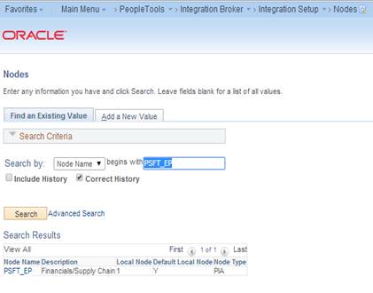

Default Node
Each database involved in integration must contain a default local node definition which needs to be Active. The default authentication option to be set as required. In case of Password Node's UserId and Password values need to be configured.
Navigation: PeopleTools -> Integration Broker -> Integration Setup à Nodes
  1. Search and Open the default node (e.g. PSFT_EP).
    Figure 8-1 Nodes
    Surrounding text describes Figure 8-1 .
  2. Make the changes and Save the page.
    Figure 8-2 Default Node
    Surrounding text describes Figure 8-2 .

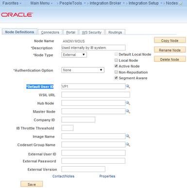

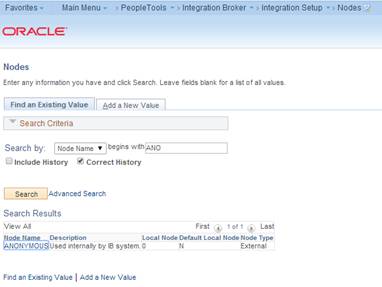

ANONYMOUS Node - Default User ID
PeopleSoft uses the Anonymous node when receiving messages from third party system. The user need to verify the default user ID configured for this node is valid.
Navigation: Main Menu à PeopleTools -> Integration Broker -> Integration Setup -> Nodes
  1. Search for ANONYMOUS node and open it.
    Figure 8-3 Anonymous Node
    Surrounding text describes Figure 8-3 .
  2. Verify the Default User ID is valid. E.g. VP1
    Figure 8-4 Verify
    Surrounding text describes Figure 8-4 .

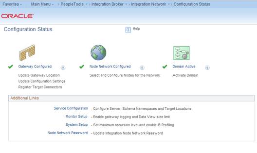

Activating Pub/Sub Server Domains
Prerequisites for Activating the Pub/Sub Server Domain:
To activate the pub/sub server domains, the pub/sub server option in the PSADMIN domain configuration, 1.) Pub/Sub Servers, must be set to Yes.
For more information on Application Server Domain configuration, Please refer to Enterprise 8.5x PeopleBook: Integration Broker Administration section - Activating Pub/Sub Server Domains.

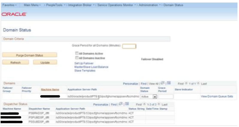

To Activate the Domain:
Navigation: PeopleTools -> Integration Broker -> Service Operation Monitor -> Administration -> Domain Status
  1. Click Purge domain status button.
  2. From the Domain Status drop-down list, select Active.
  3. Click the Update button.
  4. Click the Refresh button.
    Three dispatcher processes should appear in the Dispatcher Status grid with the status of active (ACT).
    On occasion it may take a few moments for the processes to start. If the processes don't immediately appear in the grid, wait a few moments and click the Refresh button again.
    If the three processes appear in Dispatcher Status grid, but with the status of inactive (INACT), click the Update button.
    Figure 8-5 Domain Status
    Surrounding text describes Figure 8-5 .

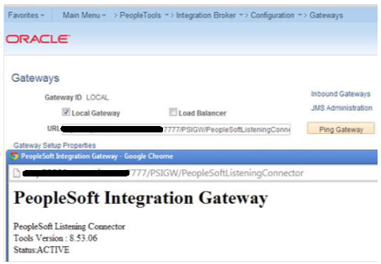

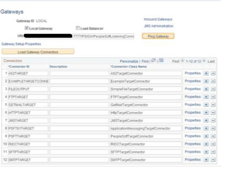

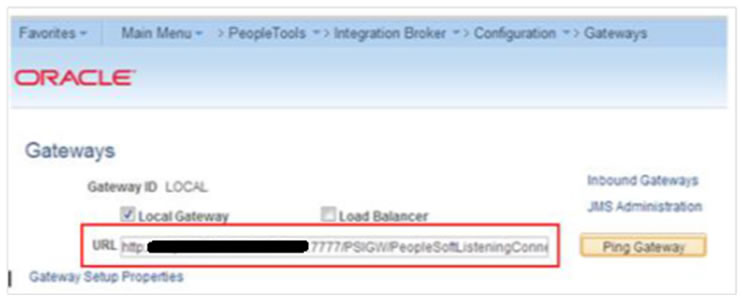

  1. Set up the Gateway.

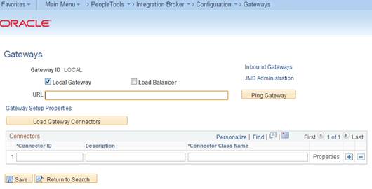

    1. Define the gateway URL and load Target Connectors.
      The integration gateway URL specifies the location of the PeopleSoft listening connector used to "listen" for inbound request/integrations. The target connectors handle outbound requests/integrations.
      Navigation: PeopleTools -> Integration Broker -> Configuration -> Gateways.
    2. Configure URL field value.
      Enter the gateway URL in the following format
      http://<machinename>:<port>/PSIGW/PeopleSoftListeningConnector
      The machine name is the name of the machine where PIA is installed. By default the port number is 80 for HTTP and 443 for HTTPS. If using the default port number, no need to specify it in the URL. (Ensure to have the correct port numbers specified at the time of PeopleSoft installation.
      Figure 8-6 Gateways
      Surrounding text describes Figure 8-6 .
      Figure 8-7 Enter URL
      Surrounding text describes Figure 8-7 .
      For example:
      http://peoplesofthost.example:7777/PSIGW/PeopleSoftListeningConnector
    3. Check the Gateway Communication.
      Click on "Ping Gateway" button and check the status. A successful ping means that the system can properly communicate with the gateway. If the ping is not successful, check that the correct URL is entered and that it is entered in the proper format.
      Figure 8-8 Ping Gateway
      Surrounding text describes Figure 8-8 .

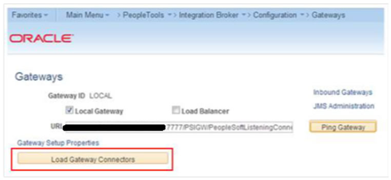

    4. Load Gateway Connectors.
      Click the Load Gateway Connectors button. A message appears that indicates the connectors were successfully loaded.
      Figure 8-9 Load Gateway Connectors
      Surrounding text describes Figure 8-9 .
      Figure 8-10 Load Gateway Connectors
      Surrounding text describes Figure 8-10 .

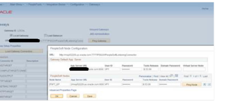

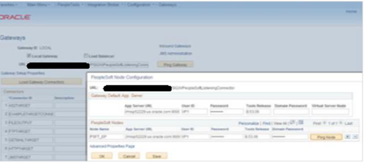

  2. Register Nodes on the Local Gateway.
    To register nodes on the local gateway:

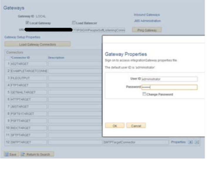

    1. On the Gateways page, click the Gateway Setup Properties link. The Gateway Properties page appears.
      Figure 8-11 Gateway Setup Properties
      Surrounding text describes Figure 8-11 .
    2. Enter the user ID and password for the integration gateway. These credentials were defined when PIA was installed.
      • In the User ID field, enter the gateway user ID.
      • In the Password field, enter the gateway password.
      • Click the OK button.
      The PeopleSoft Node Configuration page appears.
      In the Gateway Default App Server grid, define the following:
      • In the App Server URL field enter the machine name and Jolt port of the application server.
        The format is //<machinename>:<port>.
        For Example: //peoplesofthost.example:9000.
      • In the User ID field, enter the application server user ID.
      • In the Password field, enter the application server password.
      • In the Tools Release field, enter the release number of the PeopleTools version installed. For example: 8.53.06.
      • In the Domain Password field, enter the domain password if one was defined when the application server was configured.
    3. In the PeopleSoft Nodes grid, define the following fields for the local default node.
      Depending on the technology you're using, you may need to define other PeopleSoft nodes in the grid.
      • In the Node Name field, enter the name of the local default node.
        An example is //peoplesofthost.example:9000.
      • In the Tools Release field, enter the release number of the PeopleTools version installed. For example, 8.53.06.

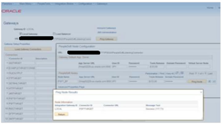

    4. Click the Ping Node button.
      A successful ping means that the integration gateway can communicate with the node. If the ping is not successful, PSAdmin needs to check the installation details regarding the gateway.
      Figure 8-12 Ping Node
      Surrounding text describes Figure 8-12 .
      Figure 8-13 Ping Node
      Surrounding text describes Figure 8-13 .

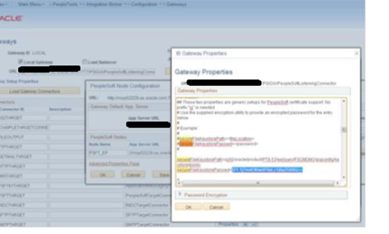

  3. Define Integration Gateway Keystore Values
    The keystore password value in the integration gateway properties file needs to be encrypted. The path to the keystore is populated during the PIA installation process, but it's good practice to confirm that the path is accurate during this task.
    Integrations will fail if you do not enter an encrypted keystore password for the secureFileKeystorePasswd property.
    For example: The following code snippet shows an example of the keystore values before they are configured:
    secureFileKeystorePath= /u00/oracle/product/PT8.53/webserv/FSCMDMO/piaconfig/keystore/pskey
    #secureFileKeystorePasswd=
    To configure these settings confirm that the path to the keystore is correct. Next, encrypt the keystore password with the provide encryption utility, uncomment the secureKeystorePasswd property, and set the property equal to the encrypted password.
    For example: The following code snippet shows an example of the keystore values after they are properly configured:
    secureFileKeystorePath= secureFileKeystorePath=/u00/oracle/product/PT8.53/webserv/FSCMDMO/piaconfig/keystore/pskey
    secureFileKeystorePasswd={V1.1}7m4OtVwMGDyLc1j6pZG69Q==
  4. Define integration gateway keystore values.
    1. From the PeopleSoft Node Configuration page, click the Advanced Properties Page link.
    2. Scroll to the ## Integration Gateway CERTIFICATE Section of the file.
    3. Locate the secureFileKeystorePath property.
    4. Confirm the keystore path setting:
      1. Uncomment the secureFileKeystorePath property if it is not already uncommented.
      2. Confirm that the path defined for the keystore path is accurate.
    5. Enter an encrypted keystore password.
    6. Expand the Password Encryption utility at the bottom of the page.
      1. In the Password field, enter the keystore password.
        Password should be the domain password set at time of
      2. In the Confirm Password field, enter the password again.
      3. Click the Enter button to encrypt the password.
        The encrypted password appears in the Encrypted Password field.
      4. Copy the value in the Encrypted Password field to the clipboard.
      5. Navigate back to the secureFileKeystorePasswd property in the file.
      6. Uncomment the property and paste the encrypted value, setting the property equal to the encrypted value.
    7. Click the OK button

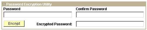

  5. Encrypt a password using the Password Encryption Utility.
    1. On the page where you are working, click the Password Encryption Utility arrow to display the dialog box.
    2. In the Password field, enter a password.
    3. In the Confirm Password field, enter the password again.
    4. Click the Encrypt button. The encrypted password displays in the Encrypted Password field.
    5. From the Encrypted Password field, cut the encrypted password and paste it into the appropriate location
    Figure 8-14 Password Encryption Utility

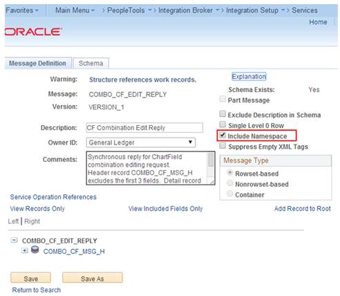

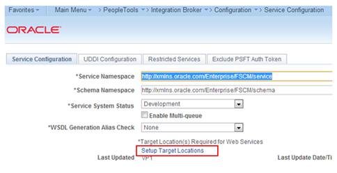

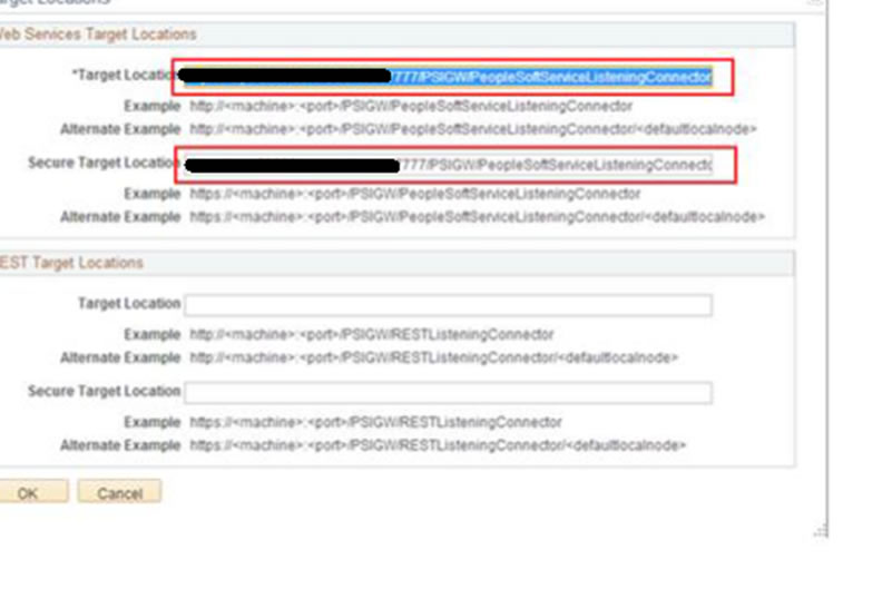

  6. Add the Target Location.
    1. Define the schema namespace and the service namespace
      Namespaces provide a method for qualifying element and attribute names that are used in XML documents and are identified by Uniform Resource Identifier (URI) references.
      To define the schema namespace and the service namespace, use the Service Configuration page. To access the page selectPeopleTools, then selectIntegration Broker, then selectIntegration Network WorkCenter, then selectIB Configure Network and click theAdd Target Location(s) link in the left navigation pane.

      To define the schema namespace and the service namespace:
      1. Access the Integration Broker Configuration activity guide (selectPeopleTools, then selectIntegration Broker, then selectIntegration Network WorkCenter, then selectIB Configure Network).
      2. In the left navigation pane click Add Target Location(s).
      3. The Service Configuration page appears.
      4. In the Service Namespace field, enter the service namespace.
      5. In the Schema Namespace field, enter the schema namespace.
      6. Click the Save button.
    2. Configure Target and Secure Target Location
      Target locations are URLs that PeopleSoft Integration Broker uses to build and validate XML message schemas, export WSDL documents, and as the SOAP endpoint. For REST services, target locations are URLS that PeopleSoft Integration Broker uses to export WADL documents and as the REST endpoint.
      In general, the URL you specify as a target location should be an unsecured URL. If you need to enter secure target URLs, please see the product documentation for additional information before proceeding. You need to set the REST target location only if performing integrations with REST-based services.
      Use the Target Locations page to define target locations. To access the page, click the Set Target Locations link on the Service Configuration page or
      Navigation: PeopleTools -> Integration Broker -> Configuration -> Service Configuration
      The Target Locations page provides examples of the format to enter for the target location.
    3. The primary example shows how to enter the target location if you are using a dedicated integration gateway.
    4. The alternate example shows the format to use if the default local node points to a different gateway where WSDL documents and XSD schemas are available. Providing an alternate example is always optional
  7. Define target locations.
    1. On the Service Configuration page, click the Set Target Locations link.
    2. The Target Locations page appears.
    3. In the Web Services Target Locations box, in the Target Locations field enter the target location, following the example format shown. Note that the port value you enter is the HTTP port.
      Port should be the port number referred in application URL
    4. If REST Services are used: In the REST Target Locations box, in the Target Locations field enter the target location of REST services, following the example format shown. Note that the port value you enter is the HTTP port.
    5. Click the OK button.

Verifying IB Configuration
Navigation: Main Menu -> PeopleTools -> Integration Broker -> Integration Network -> Configuration Status
All Status should be active.
  • Gateway Configured
  • Node Network configured
  • Domain Active
Figure 8-19 Configuration Status
Surrounding text describes Figure 8-19 .

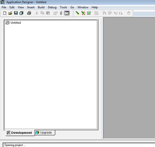

Importing the project can be done using Application Designer tool. Open the application designer from any windows work station. Refer the below screenshots.
Navigation: All Programs -> PeopleTools 8.x -> Application Designer
Figure 8-20 Application Designer
Surrounding text describes Figure 8-20 .

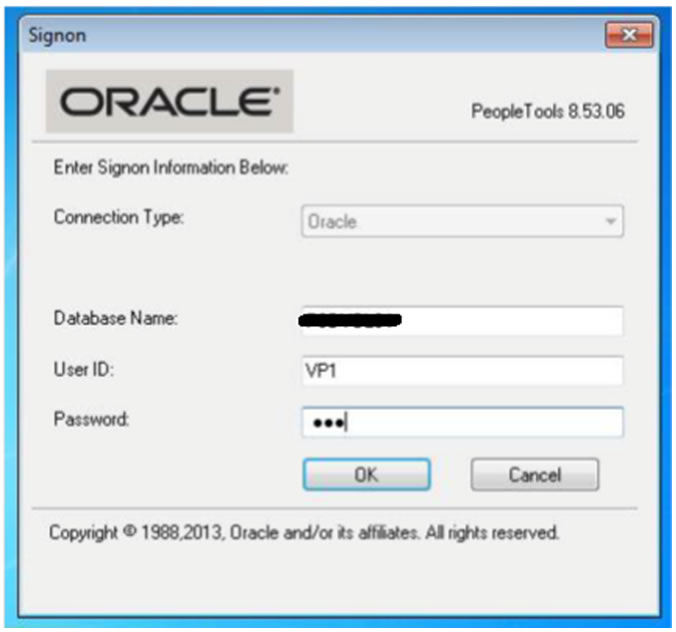

  1. Enter the PeopleSoft DB name (E.g. PSDVOLS1), Application User Id and Password (E.g. VP1/VP1)
    Figure 8-21 Signon
    Surrounding text describes Figure 8-21 .
    Figure 8-22 Application Designer
    Surrounding text describes Figure 8-22 .

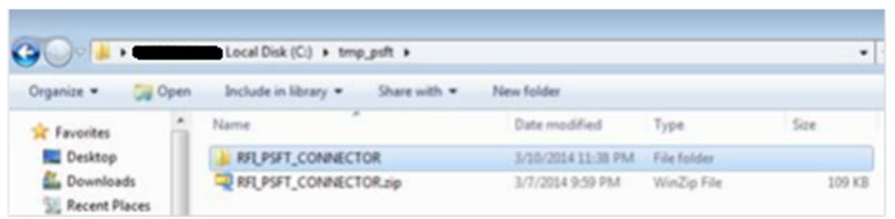

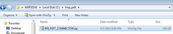

  2. Copy the project file (zip file) in any folder in the workstation available under the <INSTALL_DIR>/psft-financial/psft-integration-broker/src/main/resources/RFI_PSFT_CONNECTOR
    Figure 8-23 Copy Project File
    Surrounding text describes Figure 8-23 .
  3. Unzip the file in any folder as required
    Figure 8-24 Unzip File
    Surrounding text describes Figure 8-24 .

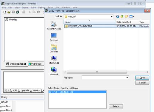

    1. Copying Project from a File

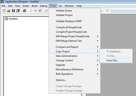

      The Copy Project From File command in the Tools menu imports PeopleTools definitions and the project definition from a file that was previously copied by using the Copy To File feature.
      – Copy a project that does not exist in the database from a file.
      – Copy a project that does exist in the database from a file.
    2. Copy a project that does not exist in the database from a file.
      1. Select select Tools, then select Copy Project, then select From File.
      2. The Copy From File: Select Project dialog box appears.
      3. Browse to locate the project file or select the file from the Projects list.
        You can use the Open button to open folders while browsing. It does not open the project file and begin the copy process.
        You can copy only one project from a file at a time.
        Figure 8-25 Copy Project From File
        Surrounding text describes Figure 8-25 .
      4. Select the Project File Folder
        Figure 8-26 Select Project File Folder
        Surrounding text describes Figure 8-26 .

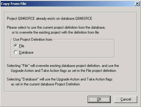

    3. Copy a project that does exist in the database from a file.
      The process for copying a project from a file when a project of the same name exists in the database is slightly different. After selecting Tools, Copy Project, From File and a project of the same name already exists in the database to which you are currently signed on, the following dialog box appears.
      Figure 8-28 Copy From File
      Surrounding text describes Figure 8-28 .
      This prompt enables you to specify which project definition to use, the one stored in the database to which you are signed on or the one stored in the file from which you intend to copy. Keep in mind that the project definition is the metadata of the project and determines which definitions (pages, fields, records, and so on) are members of the project.

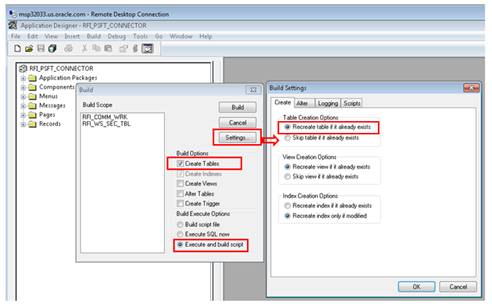

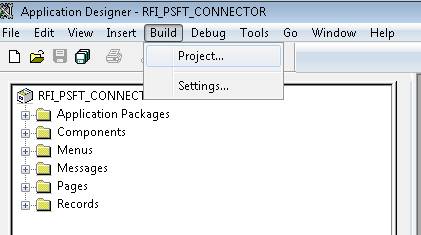

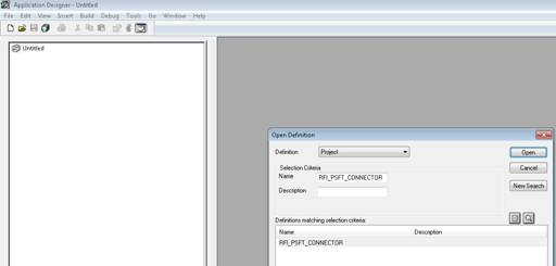

  4. Build Project Objects.
    After importing the project, all record objects [Tables and Views] need to be built from Application Designer.
    1. a.Open [Ctrl + O] project definition - RFI_PSFT_CONNECTOR
      If RFI_PSFT_CONNECTION project is already opened, skip this step. Same can be checked on the left side panel.
      Figure 8-29 Build Project Objects
      Surrounding text describes Figure 8-29 .
    2. All record objects in project RFI_PSFT_CONNECTOR needs to be built. Select Build à Project menu.
      Figure 8-30 Project
      Surrounding text describes Figure 8-30 .

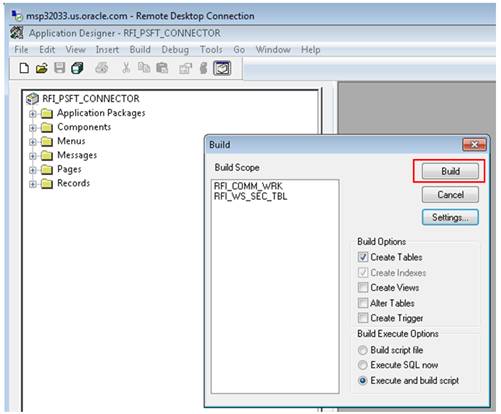

    3. App Designer will list all the record objects to build. Select options as below.
      Figure 8-31 Build Settings
      Surrounding text describes Figure 8-31 .

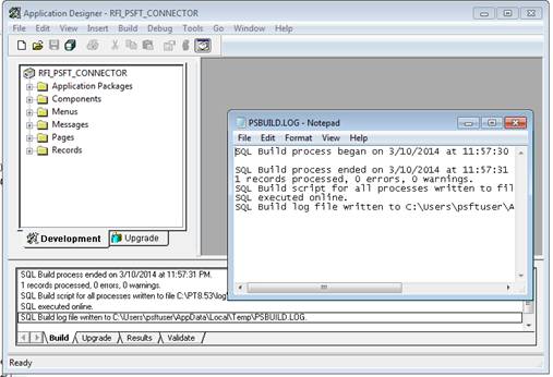

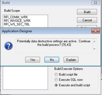

    4. Click on Build button to build the records.
      Figure 8-32 Build
      Surrounding text describes Figure 8-32 .

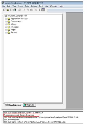

      The following system message appears: "Potential data destructive settings are active. Continue the build process?"
    5. Click yes to continue.
      Figure 8-33 Build
      Surrounding text describes Figure 8-33 .
      The log file should show one record processed, o errors, o warnings. If any error, click on PSBUILD.log to know more details.
    6. If the system throws any error during Build process, refer the Error Handling / Validation section [Error When Building the Project Objects] for solution.
      Figure 8-34 Build Error
      Surrounding text describes Figure 8-34 .
    7. After checking the log details close the log file.
      Figure 8-35 Log File
      Surrounding text describes Figure 8-35 .
      Log shows only one record processed because system will build only physical records and views. For more detail refer Enterprise PeopleTools 8.4X, 8.5X PeopleBook: PeopleSoft Application Designer > Creating Record Definitions

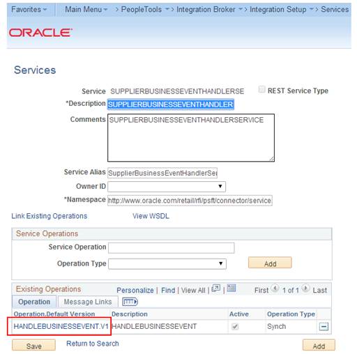

Service: SUPPLIERBUSINESSEVENTHANDLERSE
Service Operation: HANDLEBUSINESSEVENT
Navigation: Main Menu ->PeopleTools -> Integration Broker -> Integration Setup -> Services
  1. Search for service - SUPPLIERBUSINESSEVENTHANDLERSE and click on Service Link.
    Figure 8-36 Service Link
    Surrounding text describes Figure 8-36 .
  2. From the Service Definition page, click on Service Operation link to open Service Operation.
    Figure 8-37 Service Operation
    Surrounding text describes Figure 8-37 .

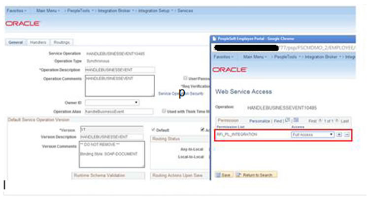

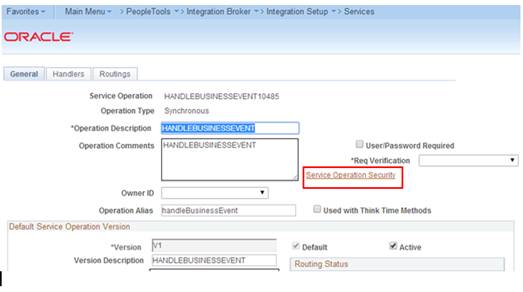

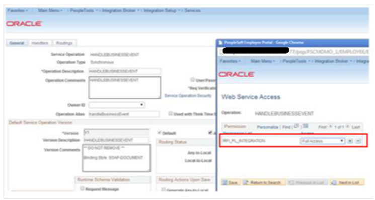

  3. From the Service Operation Definition page, click on Service Operation Security link. This will open a popup window.
    Figure 8-38 Service Operation Security
    Surrounding text describes Figure 8-38 .
  4. From the Service Operation Web Service Access page, add the permission list - RFI_PL_INTEGRATION (if not available already) to WebService access with full access and click Save.
    Figure 8-39 Permission List
    Surrounding text describes Figure 8-39 .

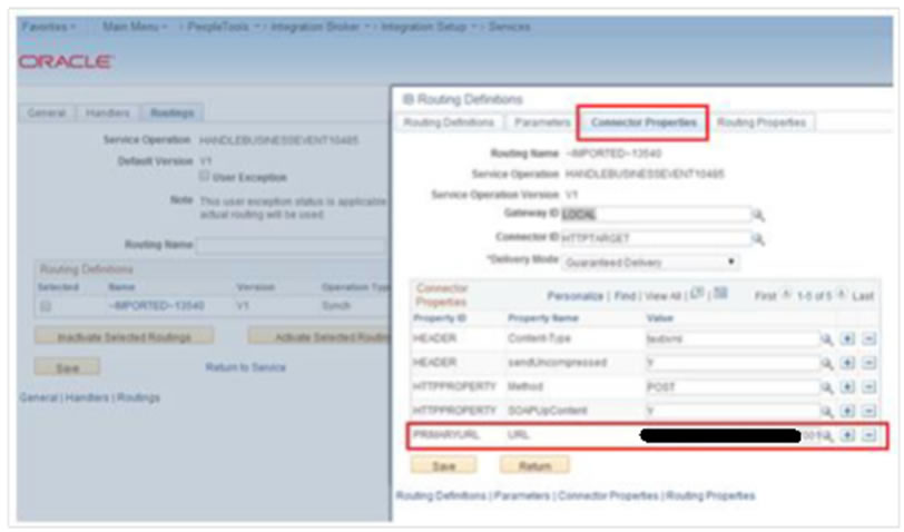

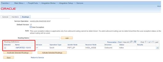

  5. From the Routing Definition tab, go to the Routing Definition tab and click the Routing Definition Link. [Name: ~IMPORTED~10419].
    Figure 8-40 Routing Definition
    Surrounding text describes Figure 8-40 .
  6. From the IB Routing Definitions page, click on the Connector Properties tab and change the Primary URL value based on the Target system. The primary URL is to point to the RFI service URL that needs to be invoked from PeopleSoft. Click Save.
    Figure 8-41 Primary URL
    Surrounding text describes Figure 8-41 .

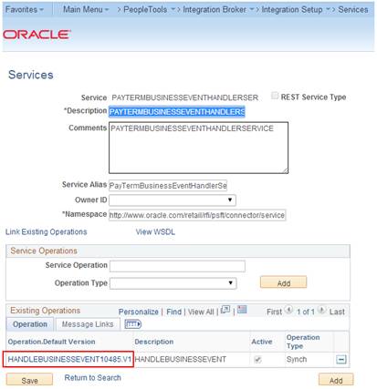

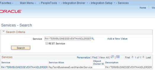

Payment Terms
Service: PAYTERMBUSINESSEVENTHANDLERSER
Service Operation: HANDLEBUSINESSEVENT10485
  1. From the Service Definition page, search for service - PAYTERMBUSINESSEVENTHANDLERSER and click the Service Link.
    Figure 8-42 Services
    Surrounding text describes Figure 8-42 .
  2. Click the Service Operation link to open the Service Operation.
    Figure 8-43 Service Operation
    Surrounding text describes Figure 8-43 .
  3. From the Service Operation Definition page, click the Service Operation Security link. This will open a popup window.
    Figure 8-44 Service Operation Security
    Surrounding text describes Figure 8-44 .
  4. From the Service Operation Web Service Access page, add Permission list - RFI_PL_INTEGRATION (if not already available) to WebService access with full access and click on Save.
    Figure 8-45 Permission list
    Surrounding text describes Figure 8-45 .

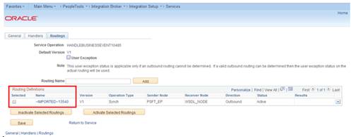

  5. From the Routing Definition tab, go to the Routing Definition tab and click the Routing Definition Link. Routing Definition Name: ~IMPORTED~13540
    Figure 8-46 Routing Definition Link
    Surrounding text describes Figure 8-46 .

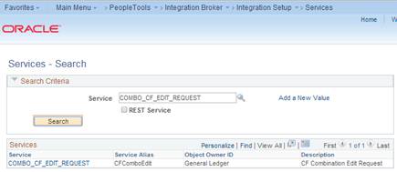

Providing Web Service - GL Account Validation
PeopleSoft should provide GL Account Validation WSDL to third party system to consume. It needs to be generated because the WSDL is not delivered by default.
Navigation: Main Menu -> PeopleTools -> Integration Broker -> Integration Setup -> Services

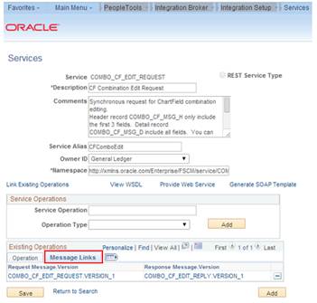

Service Name: COMBO_CF_EDIT_REQUEST
Service Operation Name: CF_EDIT_REQUEST
Prerequisite to Provide Web Service
  1. Verify the Request and Response messages have schemas.

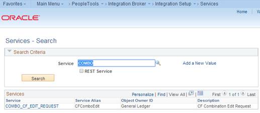

    1. Open the service definition: COMBO_CF_EDIT_REQUEST.
      Figure 8-48 Services
      Surrounding text describes Figure 8-48 .

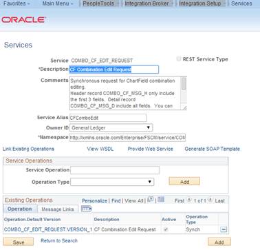

    2. Click the Service - COMBO_CF_EDIT_REQUEST link.
      Figure 8-49 Service Link
      Surrounding text describes Figure 8-49 .

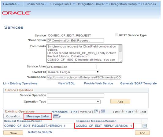

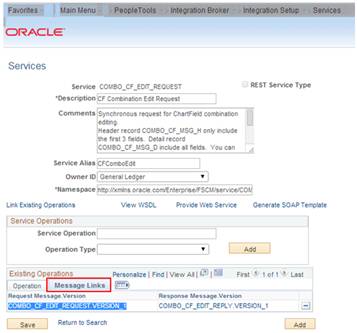

    3. Click the Message Links tab.
      Figure 8-50 Message Link
      Surrounding text describes Figure 8-50 .

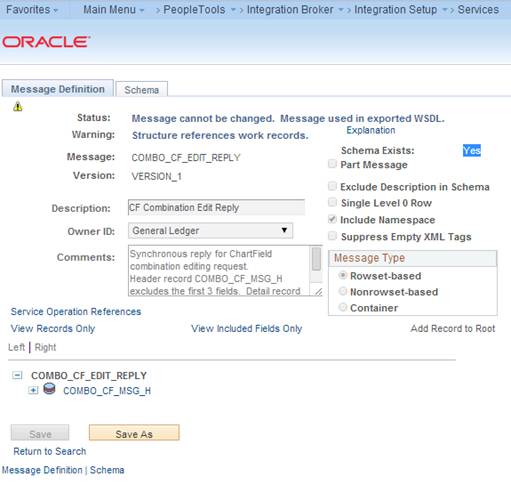

    4. Click the Request Message - COMBO_CF_EDIT_REQUEST.VERSION_1 link. It will open a popup window.
      Figure 8-51 Request Message
      Surrounding text describes Figure 8-51 .

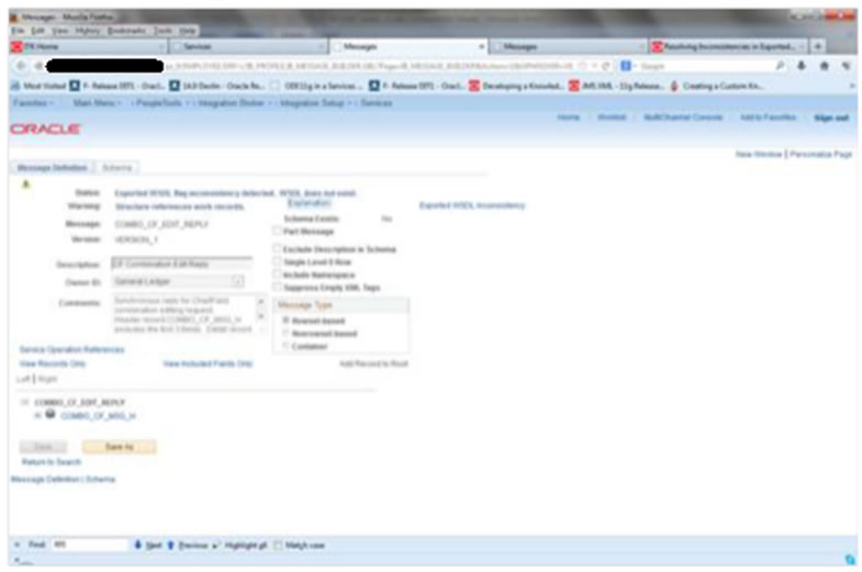

    5. Verify the Schema Exist option is yes. If the value is No, save the message definition without any changes. It will generate the schema. A confirmation message will be displayed.
      Figure 8-52 Schema Exist
      Surrounding text describes Figure 8-52 .

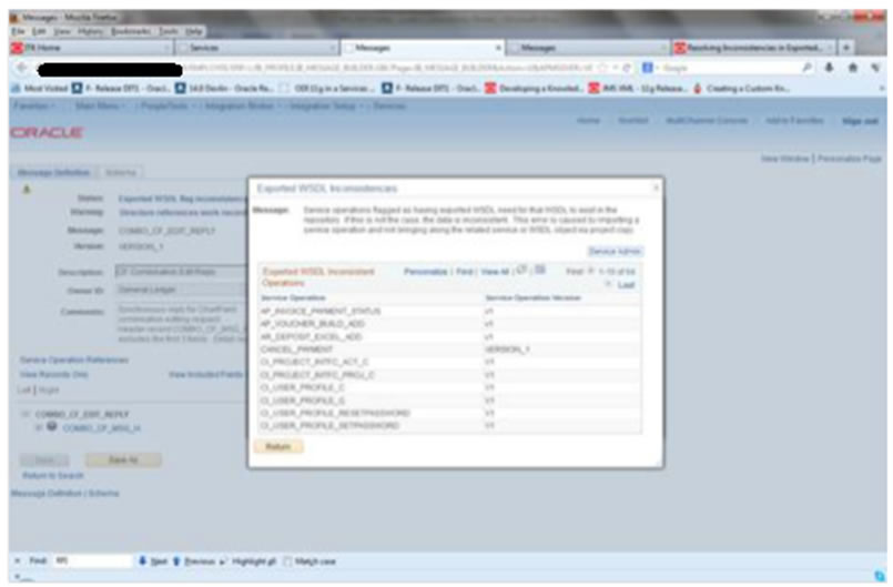

  2. To provide the Web Service, the Include Namespace option needs to be enabled at the Service Operation level.
    For more details refer to E-IB: Service Response Message Namespace Does Not Match Description in WSDL (Doc ID 1147654.1).
    1. Open Service and click the Response Message link- COMBO_CF_EDIT_REPLY.VERSION_1
      Figure 8-53 Response Message Link
      Surrounding text describes Figure 8-53 .
    2. Click the Service link - COMBO_CF_EDIT_REQUEST.
      Figure 8-54 Service Link
      Surrounding text describes Figure 8-54 .
    3. Check the Include Namespace option and click Save. If the Include Namespace option is disabled with an inconsistency, a few settings need to be completed [For more details refer http://docs.oracle.com/cd/E38689_01/pt853pbr0/eng/pt/tibr/task_ResolvingInconsistenciesinExportedWSDLandWADLDocuments-067f83.html
      Figure 8-55 Include Namespace
      Surrounding text describes Figure 8-55 .
    4. Click the Service Admin link on top of this window. This will open a window, which has the clear wsdl export status link. After doing this, the Include Namespace option will be enabled on the Service - Message Definition page.
      Figure 8-56 Service Admin
      Surrounding text describes Figure 8-56 .
      Figure 8-57 Exported WSDL Inconsistencies
      Surrounding text describes Figure 8-57 .

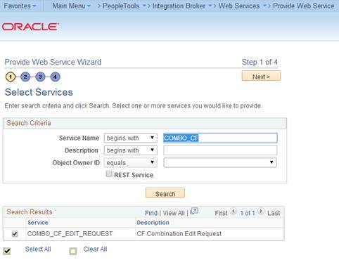

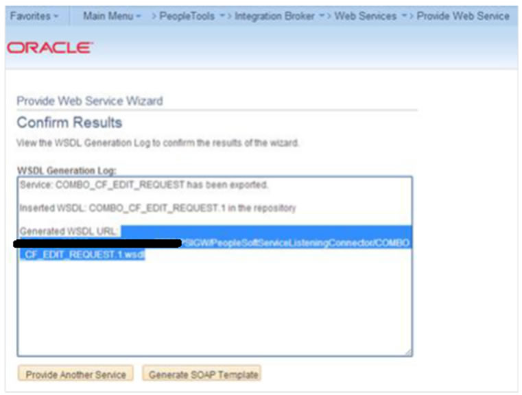

Provide Web Service
Navigation: Main Menu -> PeopleTools -> Integration Broker -> Web Service -> Provide Web Service
  1. Open COMBO_CF_EDIT_REQUEST and click Next.
    Figure 8-58 Provide Web Service
    Surrounding text describes Figure 8-58 .

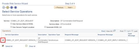

  2. Select the Service Operation - COMBO_CF_EDIT_REQUEST.VERSION_1 and click Next.
    Figure 8-59 Service Operation
    Surrounding text describes Figure 8-59 .

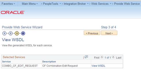

  3. View WSDL and click Next.
    Figure 8-60 View WSDL
    Surrounding text describes Figure 8-60 .

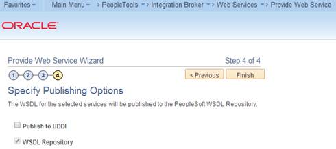

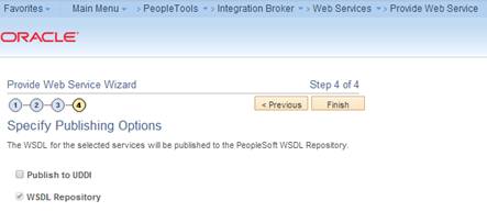

  4. Click Finish and the WSDL will be generated.
    Figure 8-61 Finish
    Surrounding text describes Figure 8-61 .
  5. Consume the WSDL or make the changes as required in third party system.
    Figure 8-62 Consume WSDL
    Surrounding text describes Figure 8-62 .
    For example:
    http://hostname:portno/PSIGW/PeopleSoftServiceListeningConnector/COMBO_CF_EDIT_REQUEST.1.wsdl

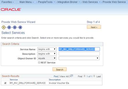

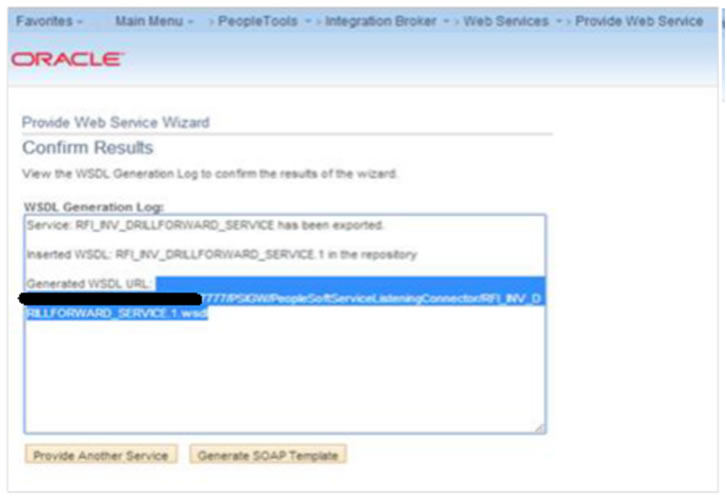

Provide Web Service
Navigation: Main Menu -> PeopleTools -> Integration Broker ->Web Service -> Provide Web Service

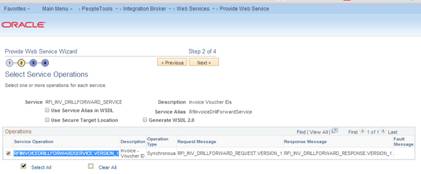

  1. Open RFI_INV_DRILLFORWARD_SERVICE and click Next.
    Figure 8-63 Provide Web Service
    Surrounding text describes Figure 8-63 .
  2. Select the Service Operation - RFIINVOICEDRILLFORWARDSERVICE.VERSION_1 and click Next.
    Figure 8-64 Service Operation
    Surrounding text describes Figure 8-64 .

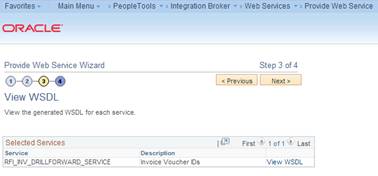

    Figure 8-65 View WSDL
    Surrounding text describes Figure 8-65 .
  4. Click Finish. The WSDL is generated.
    Figure 8-66 Finish
    Surrounding text describes Figure 8-66 .
  5. Consume the WSDL or make the changes as required in RFI.
    Figure 8-67 Consume WSDL
    Surrounding text describes Figure 8-67 .
    For example:
