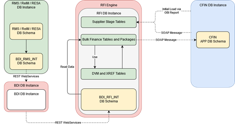

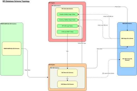

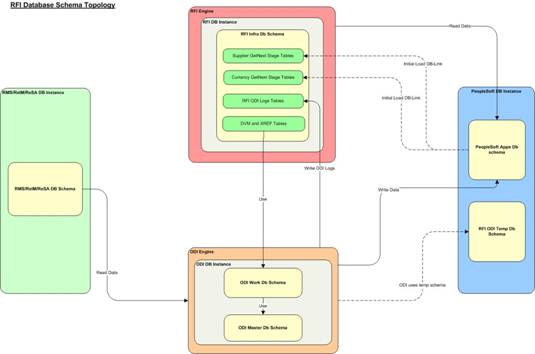

Database Schema Topology
This topology diagram shows how different schemas are integrated with each other. There are three diagrams; one with EBS as the integrating financial system, one for Oracle PeopleSoft as the integrating financial system and the last one with Cloud Financials (CFIN) as the integrating financial system.
Figure 3-1 RFI Database Schema Topology (EBS)
Surrounding text describes Figure 3-1 .
Figure 3-2 RFI Database Schema Topology (PeopleSoft)
Surrounding text describes Figure 3-2 .
Figure 3-3 RFI Database Schema Topology (Cloud Financials)
