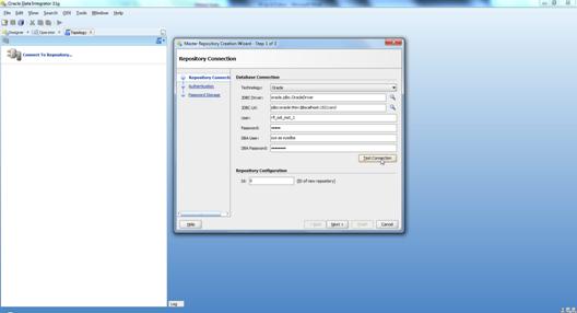

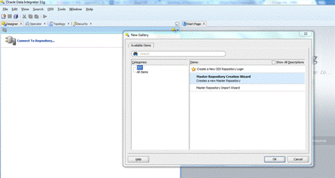

  1. Launch Oracle Data Integrator (ODI) Studio to create a Master Repository:
    Click File->New and select "Master Repository Creation Wizard" and click OK.
    Figure 10-1 Master Repository Creation Wizard
    Surrounding text describes Figure 10-1 .
  2. Enter the Master Repository Database connection details and click Next.
    • Database Connection - Enter valid Master Repository schema details.
      In JDBC url field, use the OdiMasterDataSource/ jdbcUrl entered in rfi-deployment-env-info.json file. You have to enter sysdba credentials in DBA User and DBA Password fields.
    • Repository Configuration - Enter any ID other than 804 or 805 in the Id field.
      Figure 10-2 Repository Configuration
      Surrounding text describes Figure 10-2 .

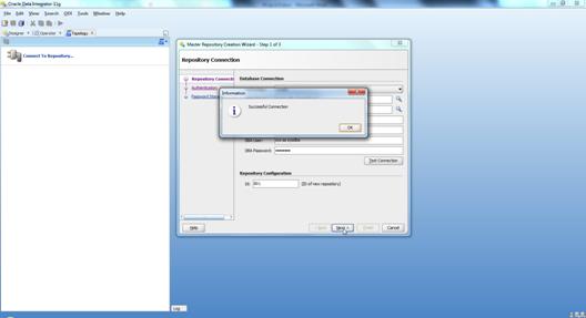

  3. Test your credentials information using the Test Connection button. If you are successful, click OK in the Information popup and then click Next.
    Figure 10-3 Test Connection
    Surrounding text describes Figure 10-3 .

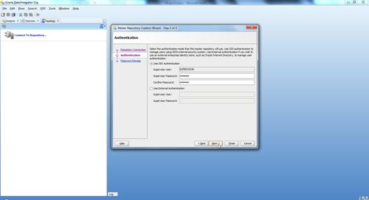

  4. Enter <supervisor password> and click Next.
    This password will be used in further installation steps, so keep a record of it.
    Figure 10-4 Authentication
    Surrounding text describes Figure 10-4 .

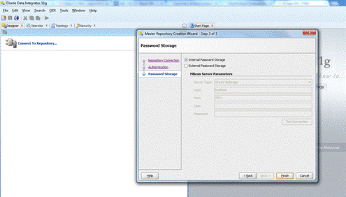

  5. Click Finish.
    Figure 10-5 Password Storage
    Surrounding text describes Figure 10-5 .

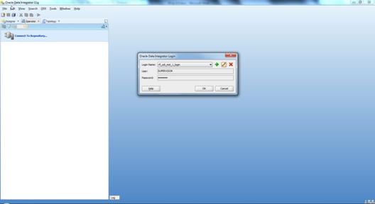

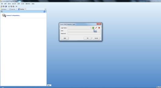

  1. Select the ODI Menu->Connect option to log in to the Master Repository in Oracle Data Integrator (ODI) Studio to create a Work Repository.
  2. Create Master Repository login credentials by selecting the + button from the Oracle Data Integrator Login dialog.
    Figure 10-6 Oracle Data Integrator Login
    Surrounding text describes Figure 10-6 .

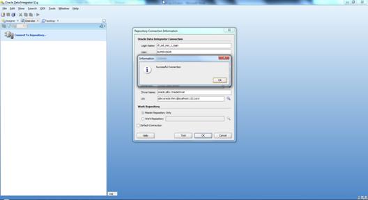

  4. Test your credentials information using the Test button. If you are successful then click OK.
    Figure 10-8 Test
    Surrounding text describes Figure 10-8 .

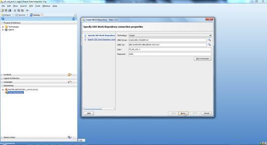

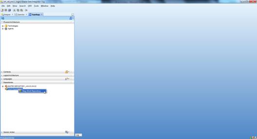

  6. From the Topology tab, select Repositories and then right-click on the Work Repositories. Select the New Work Repository option.
    Figure 10-10 Repositories
    Surrounding text describes Figure 10-10 .
  7. Enter the work repository database credentials details.
  8. Test your credentials information using the Test button. If you are successful then click Next.
    Figure 10-11 Test
    Surrounding text describes Figure 10-11 .

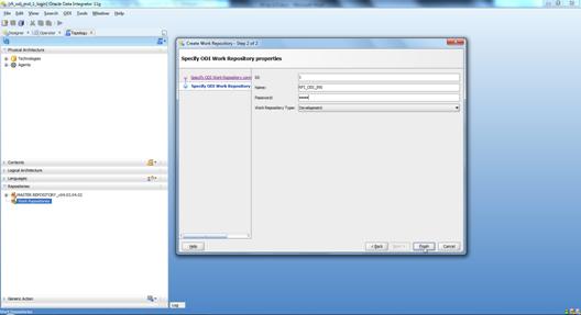

  9. Update ODI Work Repository properties:
    1. Enter any ID other than 804 or 805 (For EBS integration) / 501 or 502 (For PeopleSoft Integration) in the Id field.
    2. Enter Name and Password (should be SUPERVISOR user and <supervisor password>) for work repository and click Finish.
      Figure 10-12 ODI Work Repository
      Surrounding text describes Figure 10-12 .

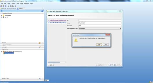

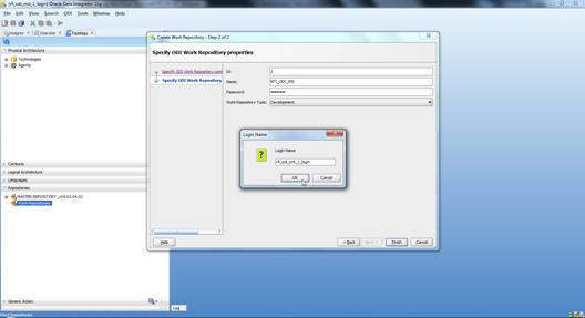

  10. Click Yes to create an ODI login for the work repository.
    Figure 10-13 Confirmation
    Surrounding text describes Figure 10-13 .
  11. Enter the ODI work repository login name in the dialog.
    Figure 10-14 Login Name
    Surrounding text describes Figure 10-14 .

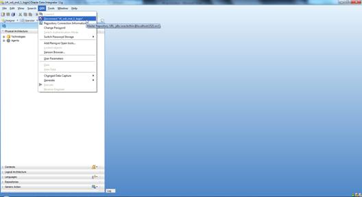

  12. Select the ODI Menu->Disconnect option to connect to the Work Repository.
    Figure 10-15 Disconnect
    Surrounding text describes Figure 10-15 .

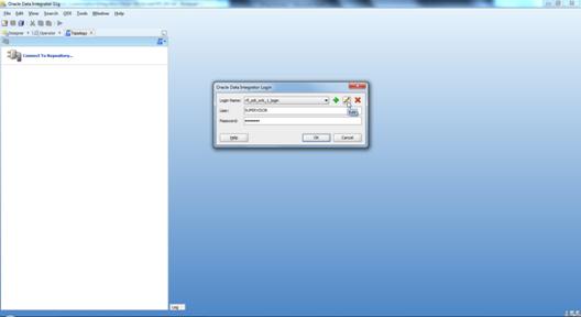

  13. Select the ODI Menu->Connect option.
    1. From the ODI Login popup, select Login Name from dropdown list (select the name you created in step7).
    2. Enter user as "SUPERVISOR".
    3. Enter <supervisor password>.
    4. Select the Edit option.
      Figure 10-16 Connect
      Surrounding text describes Figure 10-16 .

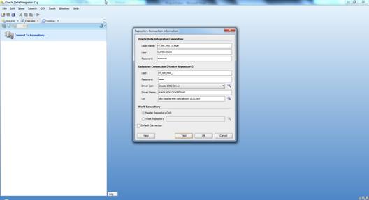

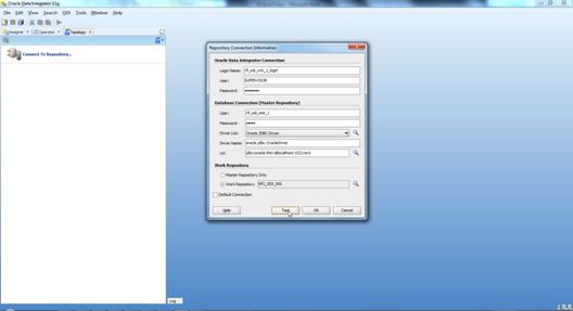

  14. Validate the Repository Connection Information:
    1. Oracle Data Integrator Connection
      • Login Name: <work repository login name>
      • User: <"SUPERVISOR">
      • Password: <supervisor password>
    2. Database Connection (Master Repository)
      • Validate the Master Repository database details.
    3. Work Repository
      • Select the Work Repository option and select the repository you just created.
        Figure 10-17 Repository Connection Information
        Surrounding text describes Figure 10-17 .

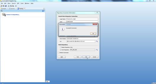

  15. Test your credentials information using the Test button. If you are successful then click OK.
    Figure 10-18 Test
    Surrounding text describes Figure 10-18 .

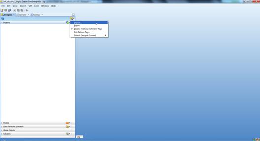

  1. Log in to the Work Repository in Oracle Data Integrator (ODI) Studio to import all the interfaces:

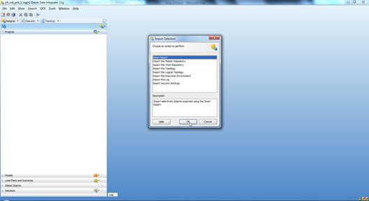

  2. Select the Import option from the Designer tab.
    Figure 10-20 Import
    Surrounding text describes Figure 10-20 .

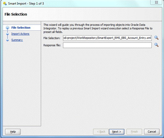

  3. Select the Smart Import option on the Import Selection dialog and click OK.
    Figure 10-21 Smart Import
    Surrounding text describes Figure 10-21 .
  4. If integration is with EBS, then
    Select SmartExport_RMS_EBS_Account_Entry.xml file in the File Selection Field and click Next. This file can be found in $INSTALL_DIR/retail-financial-integration-solution/etl-based-integration/retail-to-ebsfin-etl-flows/retail-to-ebsfin-odi-project/WorkRepository/.
    If integration is with PeopleSoft, then
    • Select SmartExport_RMS_PSFT_Account_Entry.xml file in the File Selection Field and click Next. This file can be found in $INSTALL_DIR/retail-financial-integration-solution/etl-based-integration/retail-to-psftfin-etl-flows/retail-to-psftfin-odi-project/WorkRepository/.

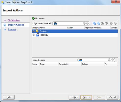

  5. Click Next.
    Figure 10-23 Smart Import - Step 2 of 3
    Surrounding text describes Figure 10-23 .

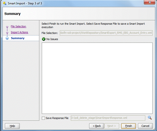

  6. Click Finish.
    Figure 10-24 Smart Import - Step 3 of 3
    Surrounding text describes Figure 10-24 .

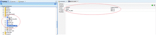

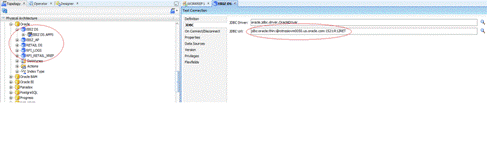

In Topology, under Physical Architecture, Technologies -> Oracle, update the Database Connection details in the Physical Server and Physical schema as shown in the table below.
Figure 10-25 Database Connection Details
Surrounding text describes Figure 10-25 .
Table 10-1 Database Connection Details - Physical Server and Physical Schema
Physical Server (Data Server) Physical Schema
Name
Definition > Connection
JDBC
Schema (Schema)
Schema (Work Schema)
EBIZ DS
User: <APPS Schema Name>
Password: <APPS Schema Password>
Update EBS JDBCUrl
APPS Schema
RFI_ODI_TEMP Schema
EBIZ_AP
User: <AP Schema Name>
Password: <AP Schema Password>
Update EBS JDBCUrl
AP Schema
RFI_ODI_TEMP Schema
RETAIL DS
User: <RMS User Schema Name> Or <BDI RFI Schema Name>(On Hybrid Cloud)
Password: <RMS User Schema Password> Or <BDI RFI Schema Password>(On Hybrid Cloud)
Update RMS Or BDI RFI (On Hybrid Cloud) JDBCUrl
RMS Schema Owner Or BDI RFI Shema Owner (On Hybrid Cloud)
RFI_LOGS
User: <ORFI Schema Name>
Password: <ORFI Schema Password>
Update ORFI JDBCUrl
ORFI Schema
ORFI Schema
RFI_RETAIL_XREF

  1. For EBIZ DS, EBIZ_AP, provide the E-Business Suite database connection.
  2. For RETAIL DS, provide the Retail database connection.
  3. For RFI_LOGS, RFI_RETAIL_XREF provide the ORFI Infrastructure database connection.
  4. Click Test Connection on the physical server to verify that the connection information is correct.
  5. In the physical schema, verify that the context (Global and RETL_TO_EBIZ) is mapped to the logical schemas as shown in the table below. If the mapping is missing, map the logical schemas as shown in the table below.
    Figure 10-26 Verify

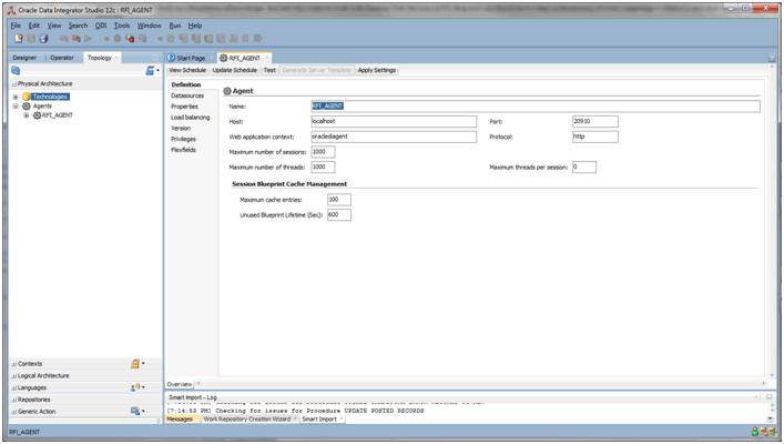

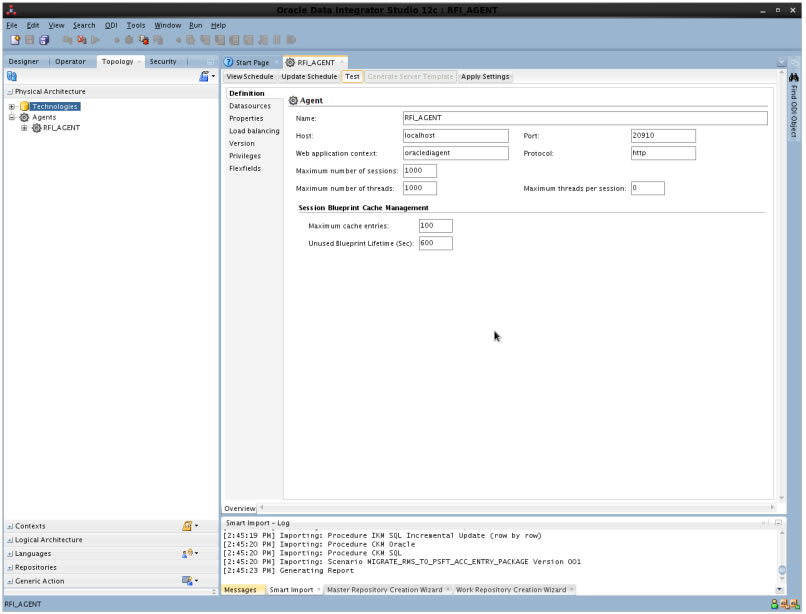

In ODI Topology, navigate to Physical Architecture -> Agents.
Make sure the RFI_AGENT is available and default to port 20910
Figure 10-27 Agents
Surrounding text describes Figure 10-27 .

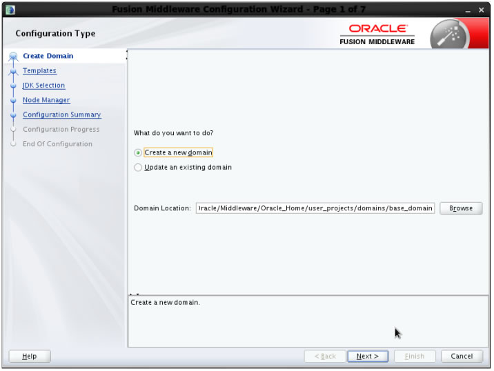

    The configuration wizard pops up. Select the "Create a new domain" option.
    Figure 10-28 Configuration Type Window
    Surrounding text describes Figure 10-28 .

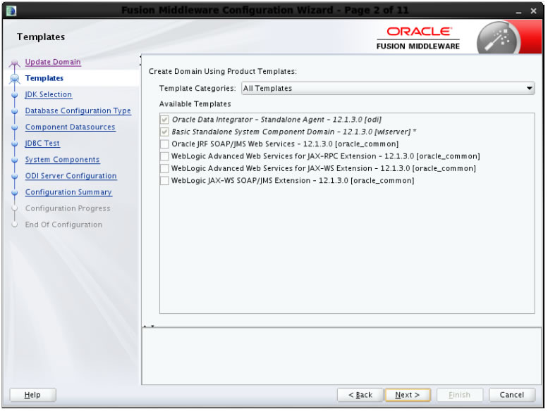

  2. After providing/choosing the domain location, Click Next.
    Figure 10-29 Templates Window
    Surrounding text describes Figure 10-29 .

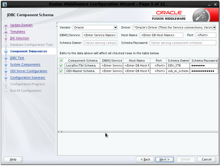

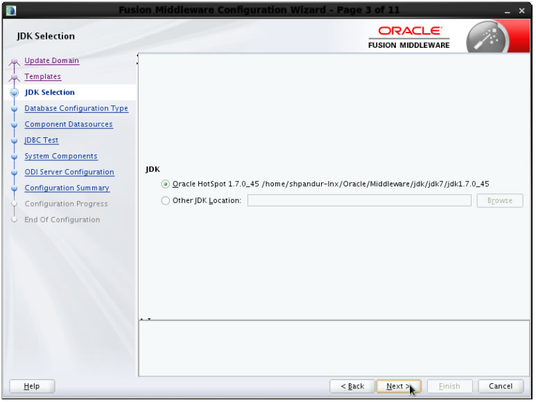

  3. Chose the first checkbox, Oracle Data Integrator-Standalone Agent -12.2.1.4.0.
    Figure 10-30 JDK Selection Window
    Surrounding text describes Figure 10-30 .
  4. Chose the JDK path.
  5. Enter DBMS/Service information (not a database instance) example orcl.example.com and enter DB host name, port information.
    Figure 10-31 JDBC Component Schema Window
    Surrounding text describes Figure 10-31 .

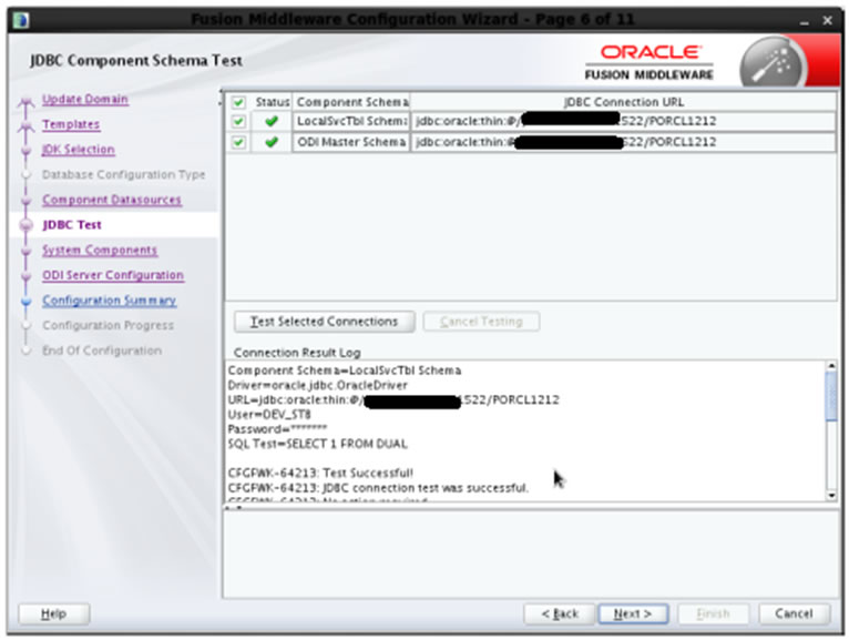

  6. Enter dev_stb schema hostname, service and port information and also password, this is the services related table that would be been created using RCU. Enter similar information for ODI master schema.
    Figure 10-32 JDBC Component Schema Test Window
    Surrounding text describes Figure 10-32 .

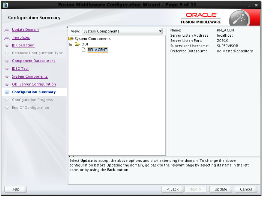

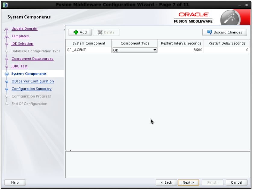

    Figure 10-33 System Components Window
    Surrounding text describes Figure 10-33 .

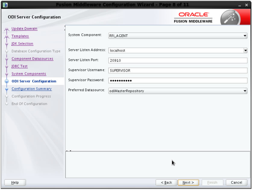

    Figure 10-34 ODI Server Configuration Window
    Surrounding text describes Figure 10-34 .
    Figure 10-35 Configuration Summary Window
    Surrounding text describes Figure 10-35 .

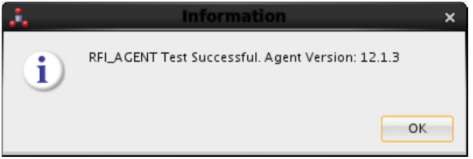

To test if the agent is successfully running:
Log into ODI with appropriate credentials and navigate to Topology tab. On the physical agent section, expand Agents, and click on RFI_AGENT. On the right pallet, click on 'Test' tab.
Figure 10-36 Test Tab
Surrounding text describes Figure 10-36 .
You should see this message.
Figure 10-37 Test Message
Surrounding text describes Figure 10-37 .

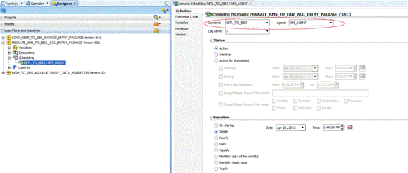

Generate Scheduler
  1. In ODI designer, navigate to Load Plans and Scenarios, and select scenario MIGRATE_RMS_TO_EBIZ_ACC_ENTRY_PACKAGE if integrating with EBS. While integrating with PeopleSoft then MIGRATE_RMS_TO_PSFT_ACC_ENTRY_PACKAGE
  2. Select Existing Scheduling. Make sure the context is set to RETL_TO_EBIZ and the agent is selected as RFI_AGENT
  3. You need to select an Execution option based on the ORFI requirement and then save the changes.
    Figure 10-38 Scheduling
    Surrounding text describes Figure 10-38 .
