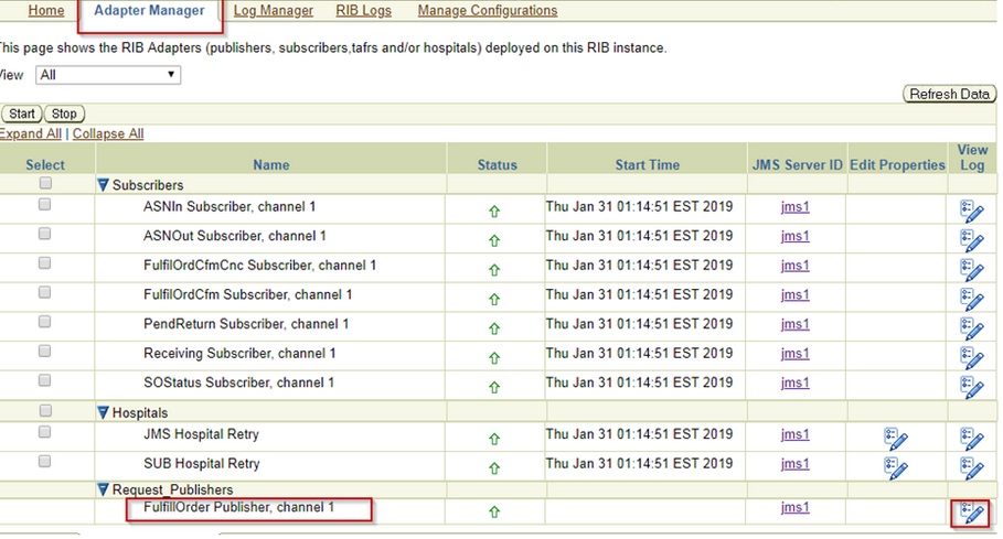

Q4. Where can see the RIB logs for the messages I published?
A4. You can login to RIB-<app> admin GUI and look at the logs as you test to see the messages, errors, and so on. See below.
RIB Administration GUI
