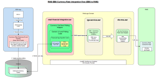

The diagram illustrates the currency exchange rate integration flow with EBS:-
The integration flow uses the following services:
CurrencyRateBES - Business Event Subscriber
Currency EJB Service
IGS Currency Service
RIBforRMS CurRate Subscriber
When the process is initiated, the following steps would occur:
Oracle E-Business Suite invokes the Business Event Subscriber Java class CurrencyRateBES whenever a currency exchange rate is created or loaded into Oracle E-Business Suite.
The Business Event Subscriber Java class CurrencyRateBES extracts all the currency exchange rates from the Oracle E-Business Suite Business Event object and moves the currency exchange rates into RFI Database Staging table RFI_CURR_RATE_STAGE.
A Configured Timer for Currency service invokes the Currency EJB service.
The Currency EJB service picks up the records from the RFI Database Staging table RFI_CURR_RATE_STAGE and transforms the Currency Code and Currency Exchange type using the CURR_CODE_DVM and CURR_CONV_TYPE_CODE_DVM respectively.
Then IGS Currency Service is invoked with the transformed currency rate record.
If there are any errors in Currency EJB service, the errors are added to the logs file. The Currency logs can be viewed using the RFI Adapter Manager screens in RFI Administration GUI.

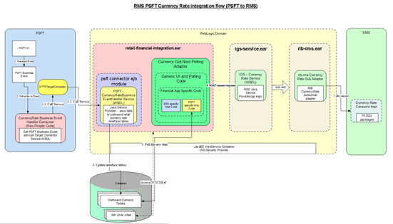

The diagram illustrates the currency exchange rate integration flow with PeopleSoft:-
CURRENCYRATEBUSINESSEVENTHANDL- Business Event Handler
Currency Web Service
PeopleSoft invokes the Business Event Handler service whenever a currency exchange rate is created or loaded into PeopleSoft E-Business Suite.
The Business Event Handler service "CURRENCYRATEBUSINESSEVENTHANDL "extracts currency exchange rates created from the PeopleSoft invokes Currency Web Service in RFI.
The RFI Service moves the currency exchange rates into RFI Database Staging table RFI_CURR_RATE_STAGE and sends back a response to PeopleSoft

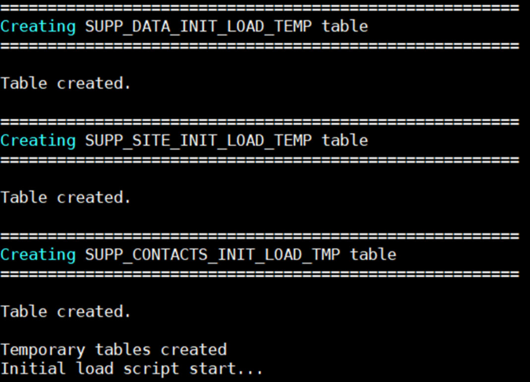

A wrapper script currency_initial_load.sh is provided to load the existing currency rates from E-Business Suite to the RFI Staging table. This file is available in the RFI pack, folder - $INSTALL_DIR/retail-financial-integration-solution/<$FINANCIAL>-integration/install/setup-data/dml. Here $ FINANCIAL should be replaced with value ebs-financial or psft-financial based on the Oracle financials application that is being integrated with RFI
Use the database link to load the currency data from Oracle Financials (EBS or PeopleSoft) to the RFI database. A database link either EBS_RFI_DBLINK or PSFT_RFI_DBLINK should be created between Financials Schema (E-Business Suite APPS schema or PeopleSoft SYSADM schema) and RFI staging schema in RFI Database (created as part of RFI installation step).
Skip this step if the database link is created with default (EBS_RFI_DBLINK or PSFT_RFI_DBLINK) name. If not , Open the sql script currency_initial_load.sql in a text editor and change the database link values created in the above step.
Run the currency_initial_load.sh (available $INSTALL_DIR/retail-financial-integration-solution/<$FINANCIAL>-integration/install/setup-data/dml) script to load data from Oracle Financials (EBS or PeopleSoft) to RFI staging area. This script considers the required environment variables (ORACLE_HOME, INSTALL_DIR) are present.
Note: $FINANCIAL should be replaced with ebs-financial or psft-financial based on your integration financial applications. |
The script takes two arguments on the command line: Financials system schema database login credentials and conversion_date (from when the currency rates have to be pushed to Retail system).
For example:
sh currency_initial_load.sh <username>/<password>@<sid> 02-AUG-2013

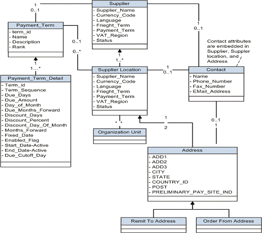

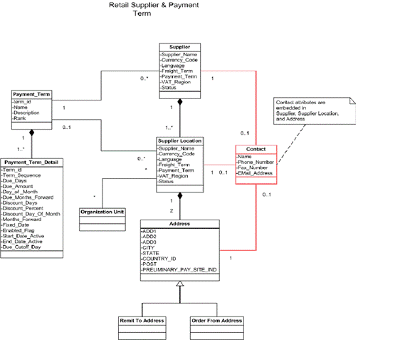

In the integrated environment, Oracle Payables acts as a payable, and RMS handles supplier payments, merchandise write-offs, and prepaid adjustments.
Merchandise suppliers are suppliers of goods and services that the retailer sells to customers. Oracle Payables and RMS require sharing of suppliers' information between them. RMS requires the supplier information for several key functions including creation and management of items and purchase orders. Oracle Payables requires suppliers' information for supplier payment. For end-to-end business integration, same supplier instance and related information must be shared between these two systems.
Between the two systems, Oracle Payables is the source of valid suppliers (vendors in Oracle Payables) and their Remit to Location and Order from addresses
The supplier integration synchronizes supplier's information from Oracle Payables to RMS through these integration flows:
Load initial suppliers from Oracle Payables to RMS: Enables the loading of all active merchandise suppliers, the current effective supplier locations and their current effective remit and order to addresses.
Incremental creation and updates of suppliers from Oracle Payables to RMS: Enables the synchronization of incremental creation and updates of the active suppliers from Oracle Payables to RMS.
Note: For incremental loads, Oracle Payables doesn't propagate deleted suppliers information to Retail. |

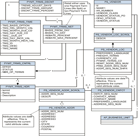

Freight terms synchronization between both the systems is a manual process. The Supplier XREF, Supplier Site XREF and Supplier Site Name XREF data are populated by a Supplier Integration Adapter; the values are required during the Supplier Update flow.
The integration design assumes that:
Oracle Payables is the source system for merchandise suppliers, their contacts, locations, addresses and other attributes.
You can create suppliers and suppliers' locations in Oracle Payables.
You can maintain the relationship between suppliers, suppliers' locations in Oracle Payables. This integration is a one-way synchronization. Any update to supplier information in RMS is not synchronized with Oracle Payables. The volume of data that is handled by the process depends on the server configuration.
Oracle sends the suppliers in batches based on different criteria.

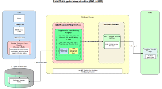

This diagram illustrates the supplier integration flow with EBS:
These services are specific to sync supplier integration flows:
SupplierBES - Business Event Subscriber
Supplier EJB Service
RMS Supplier Service
RIBforRMS Vendor Subscriber
When you initiate the process:
Oracle Payables invokes the SupplierBES Business Event Subscriber whenever a supplier is created or updated.
The Business Event Subscriber Java class SupplierBES extracts all the supplier, supplier sites and supplier contacts from the Oracle E-Business Suite Business tables and moves the supplier, supplier sites and supplier contacts into RFI Database Staging tables RFI_SUPP_STAGE, RFI_SUPP_SITES_STAGE, RFI_SUPP_CONTACTS_STAGE respectively.
A Configured Timer for RFI Supplier service invokes the Supplier EJB service.
The Supplier EJB service picks up the records from the RFI Database Staging tables RFI_SUPP_STAGE, RFI_SUPP_SITES_STAGE, RFI_SUPP_CONTACTS_STAGE and transforms the Organization id using ORG_ID_XREF, Currency Code using CURR_CODE_DVM, Language using LANGUAGE_DVM, Payment terms and Freight terms using PAYMENT_TERMS_XREF and FREIGHT_TERMS_XREF respectively.
Then RMS Supplier Service is invoked with the transformed supplier records. If there are any errors in Supplier EJB service, the errors are added to the logs file. The Supplier logs can be viewed using the RFI Adapter Manager screens in RFI Administration GUI.
If the transaction is successful, Retail Id cross references for supplier, supplier site are stored in the cross reference table RFI_XREF_DVM. The cross references updated is SUPPLIER_XREF, SUPPLIER_SITE_XREF and SUPPLIER_SITE_NAME_XREF respectively.
Note: Transformation applies the DVM and invokes create or update web service from RMS. It also updates the cross-reference table after the Retail web service call. |

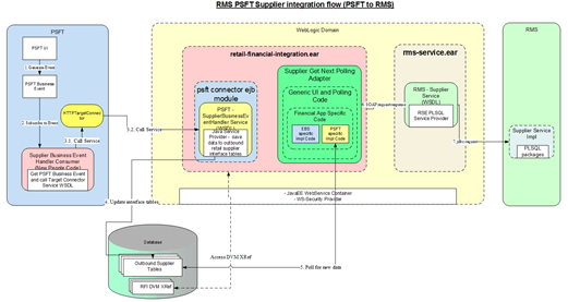

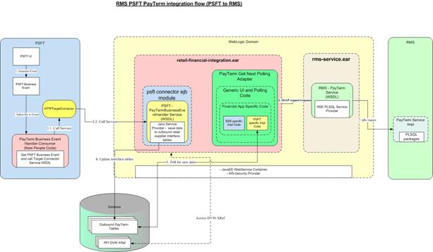

This diagram illustrates the supplier integration flow with PeopleSoft:
SUPPLIERBUSINESSEVENTHANDLERSE - Business Event Handler
Oracle Payables invokes the "SUPPLIERBUSINESSEVENTHANDLERSE" Business Event service whenever a supplier is created or updated.
The Business Event service extracts all the supplier, supplier sites and supplier contacts from the PeopleSoft Business tables and moves the supplier, supplier sites and supplier contacts into RFI Database Staging tables RFI_SUPP_STAGE, RFI_SUPP_SITES_STAGE, RFI_SUPP_CONTACTS_STAGE respectively.

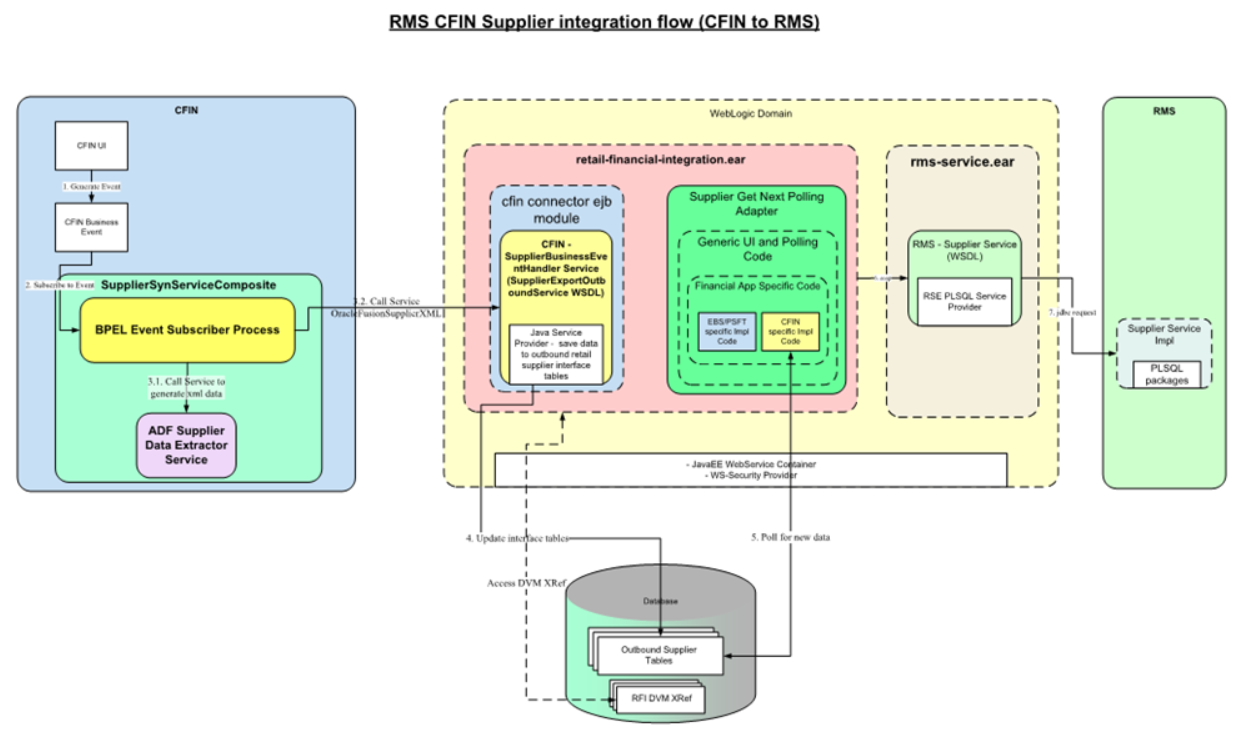

This diagram illustrates the supplier integration flow with Financials Cloud:
SUPPLIEREXPORTOUTBOUNDSERVICE - Supplier Export Outbound Service
Supplier Sequence Incremental Load
Oracle Payables invokes the "SUPPLIEREXPORTOUTBOUNDSERVICE" Business Event service with Supplier payload message whenever a supplier is created or updated (by passing complete supplier extract for updated/new supplier). Any errors during service call could be found on notification section on CFIN UI. This RFI Export Service URL needs to be configured in CFIN side so that CFIN can invoke it.
The Business Event service extracts all the supplier, supplier sites and supplier contacts from incoming Cloud Financials message and moves the supplier, supplier sites and supplier contacts into RFI Database Staging tables RFI_SUPP_STAGE, RFI_ SUPP_SITES_STAGE, RFI_SUPP_CONTACTS_STAGE respectively. Any error during stage data load could be found on RFI_ODI_LOGS table (rfi app schema).
A Configured Timer for RFI Supplier service invokes the Supplier EJB service. By Default this service runs at every 10 mins.
The Supplier EJB service picks up the records from the RFI Database Staging tables RFI_SUPP_STAGE, RFI_SUPP_SITES_STAGE, RFI_SUPP_CONTACTS_STAGE and transforms the Organization id using ORG_ID_XREF, Currency Code using CURR_CODE_DVM, Language using LANGUAGE_DVM, Payment terms and Freight terms using PAYMENT_TERMS_XREF and FREIGHT_TERMS_XREF respectively. Any error for missing DVM/XREF will be reported in RFI supplier.log. Check Adapter log for such details. Only when Supplier fails with any data error then 'is_data_processed ind' of that supplier turns to 'E'.
For valid data, RFI then invokes the RMS Supplier Service is invoked -with the transformed supplier records. This RMS service creates the actual supplier in RMS. If there are any errors in Supplier EJB service, the errors are added to the logs file and also the RFI_ODI_LOGS table. The Supplier logs can be viewed using the RFI Adapter Manager screens in RFI Administration GUI and Logs table can be viewed from View Logs screen.
If the transaction from RMS is successful, Retail Id cross references for supplier, supplier site and supplier site name are stored in the cross reference table RFI_XREF_DVM. The cross references updated is SUPPLIER_XREF, SUPPLIER_SITE_XREF and SUPPLIER_SITE_NAME_XREF respectively.
Note: Transformation applies the DVM and invokes create or update web service from RMS. It also updates the cross-reference table after the Retail web service call. This RMS service URL needs to be configured in RFI side. |

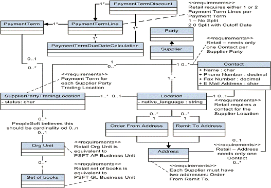

The process integration for supplier information requires the following data:
Suppliers must be assigned to at least one GL business unit (set of books)
For this integration, Oracle suppliers must be created with these status attributes:
Classification of supplier. Other type of vendors such as attorneys, employees, and HCM are not synchronized with Oracle Retail. All suppliers except employee are synced.
The Open for ordering option is selected. If the supplier is approved but is not open for ordering, the RFI layer on the RMS side changes its status to inactive. CFIN and EBS do not have an approval status.
Note: Only contacts associated with supplier sites or addresses will be synchronized from Oracle Payables to RMS. |

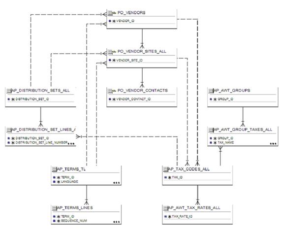

The following diagrams show supplier relation in E-Business Suite and Retail:

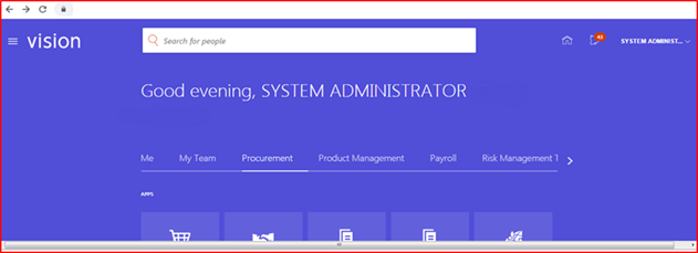

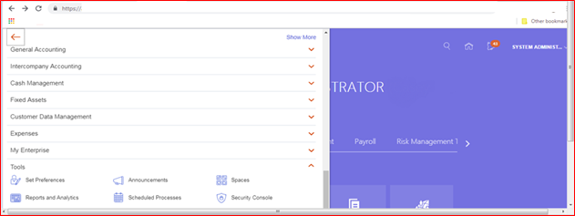

Login to CFIN. You need to have access to the Oracle ERP Cloud Procurement module and to the Oracle Business Intelligence module to perform this task.

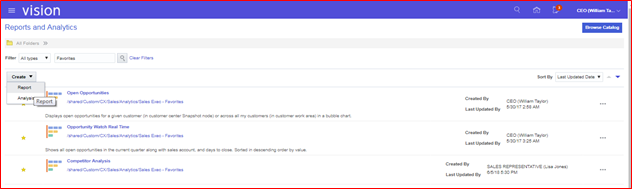

On the left-hand side menu go to Tools and then Reports and Analysis.
There is no standard repost in CFIN to extract the required supplier data. Therefore you need to create a new report for this purpose.
The system will then open the Oracle Business Intelligence on the Create Report screen. Click Cancel on the wizard dialog.

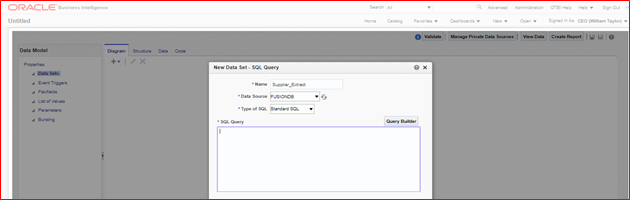

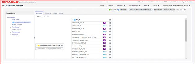

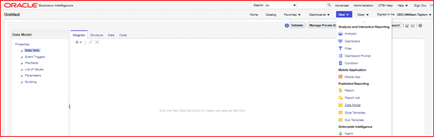

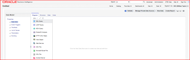

To start the extraction process, click New on the Oracle Business Intelligence home page and then, on the drop-down menu Data Model. Please note you need to have the right access privileges to access the creation of new Data Models in Oracle Business Intelligence.

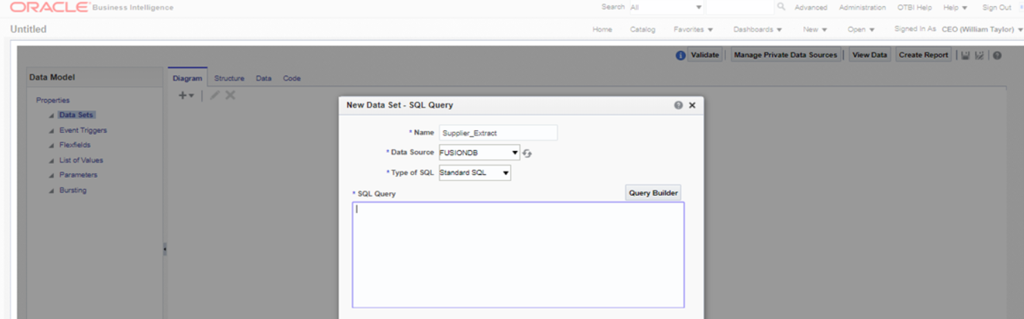

On the Data Model screen, tab Diagram, click SQL Query.
Then, give a name to your Data Model, choose the Data Source which in a standard implementation would be FUSIONDB. Please note that in your implementation this maybe have a different name so choose the Data Source where your Oracle Procurement Cloud module is implemented.
Then, on the SQL Query text area copy and paste the following SQL statement and click OK.

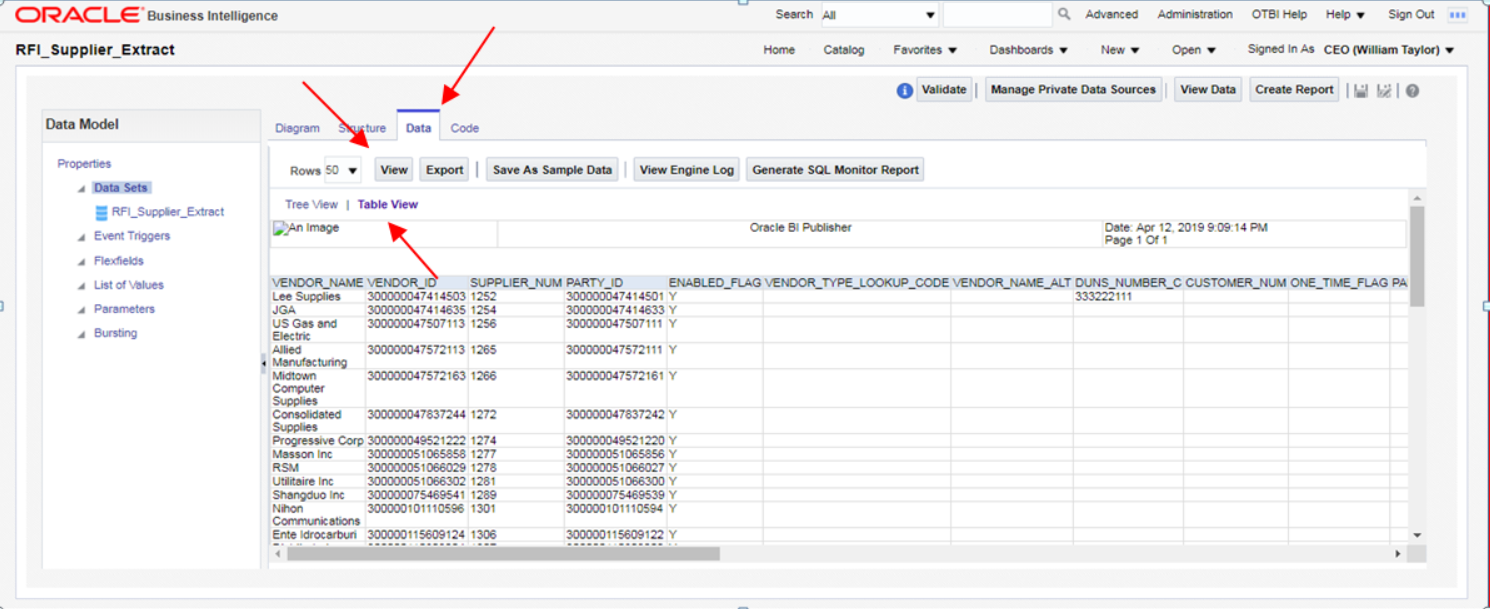

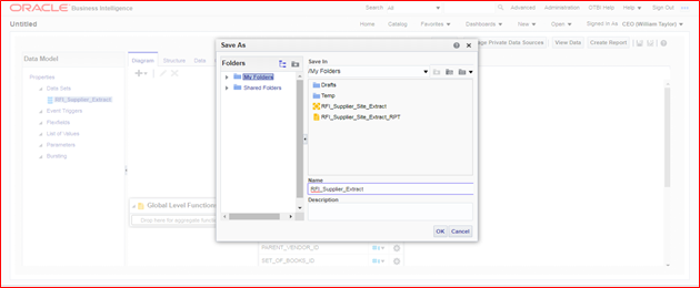

The system will generate the data model and display it on the screen. Save the data model to your personal folder.

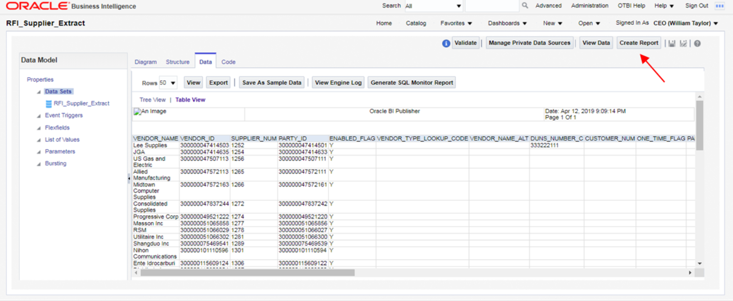

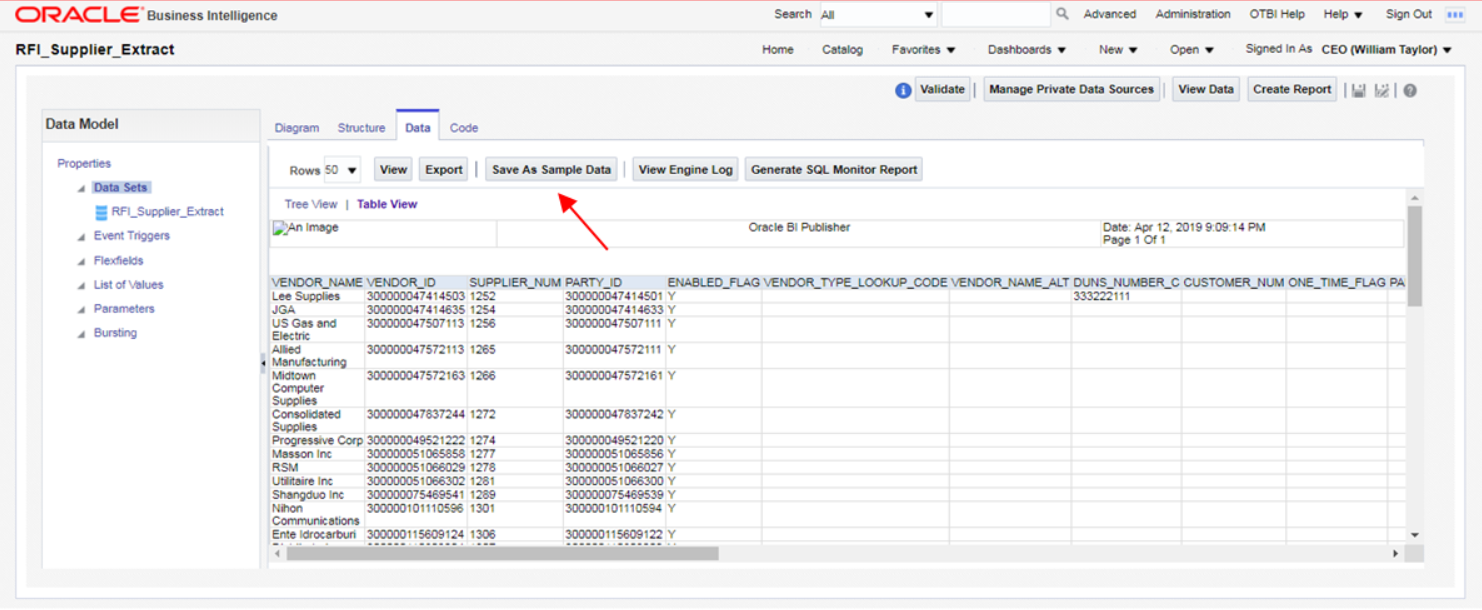

Click on the Data tab, option View and the option Table View.
Save the sample data by clicking on Save As Sample Data.
Then, save the data model again and click the option Create Report.

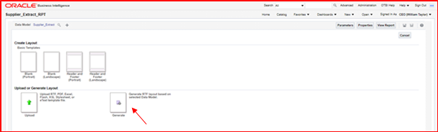

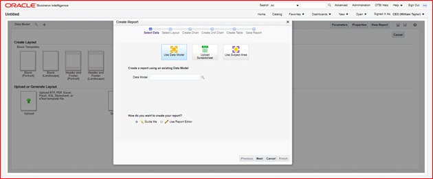

Then, the system will display the Create Report screen. The data model you just created will appear in the Data Model field. Then click on the option Use Report Editor option and then Finish. At this point the system will ask you to save your report.

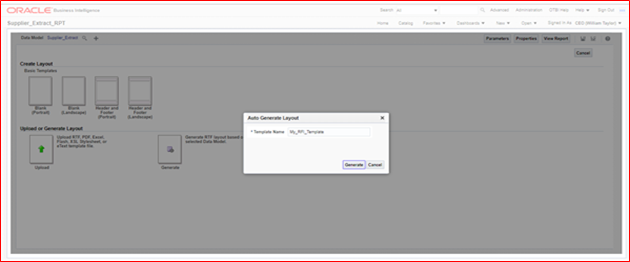

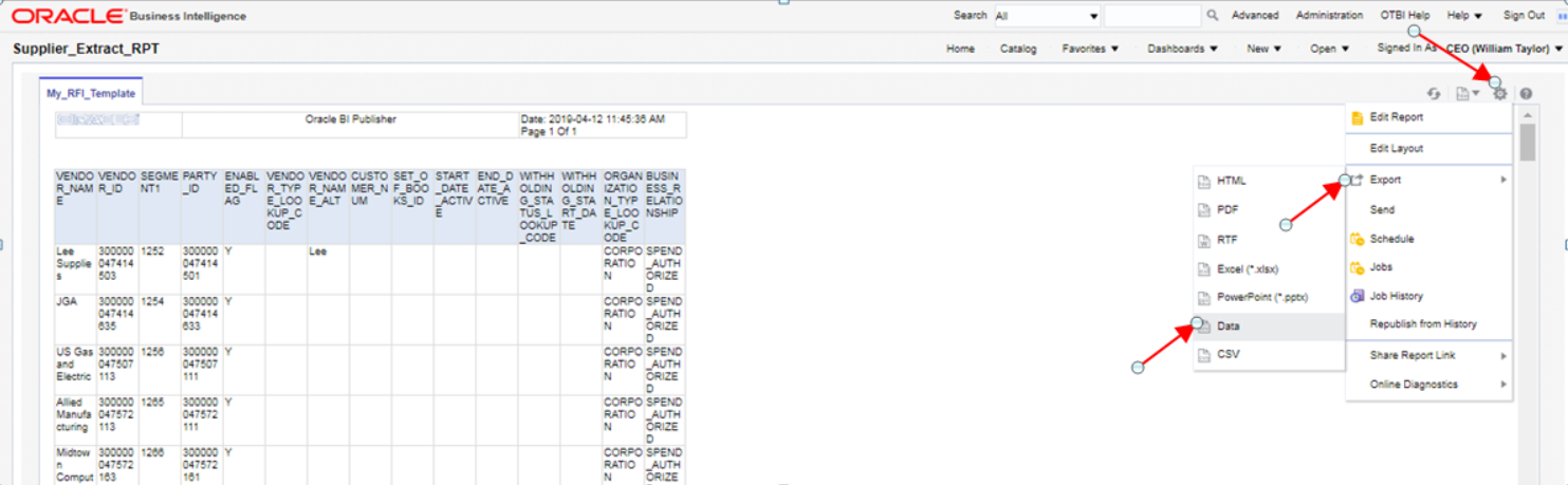

After you save the report, the system will display the Report Editor. Choose the option Generate RTF layout based on selected Data Model.
Generate this layout as your template (give it a name and click Generate).

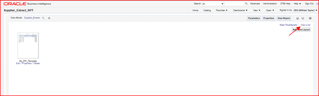

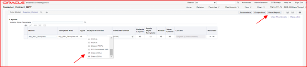

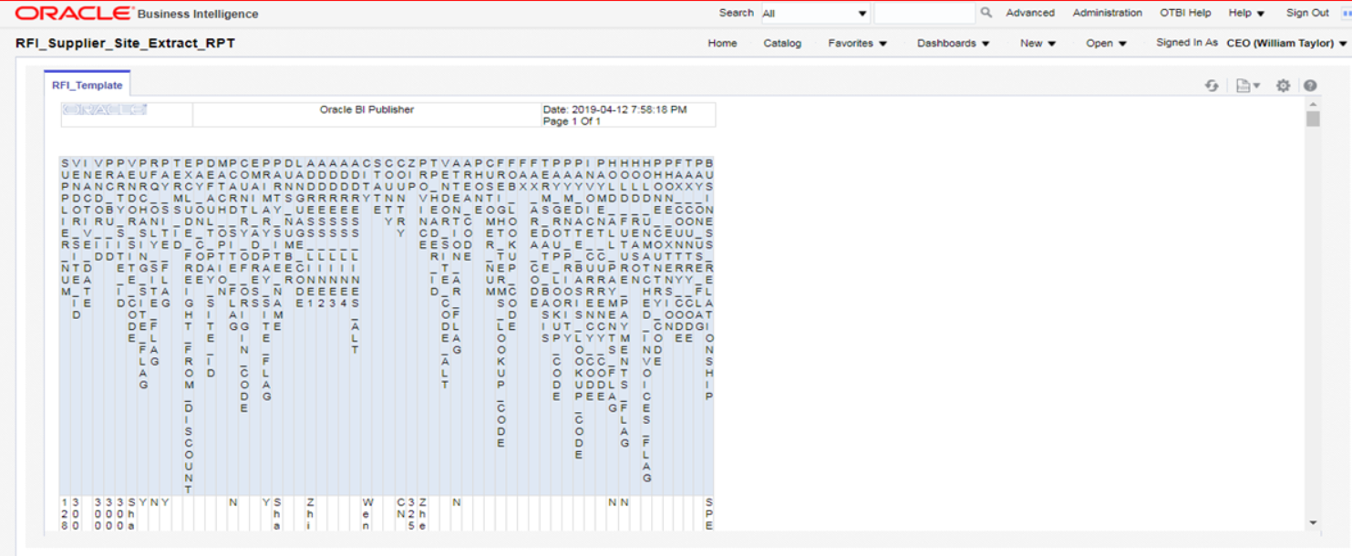

The system will generate the report template. Click on the option View List.
On the Output Formats column tick the Data option and also the Apply Style Template option.
Save the report and then click on the View Report option. The system will display the report and the related data. Then export the data by clicking on the option Export and then Data.
The system will generate a XML file and will prompt you to save it to your localhost. For this extraction the procedure is concluded.

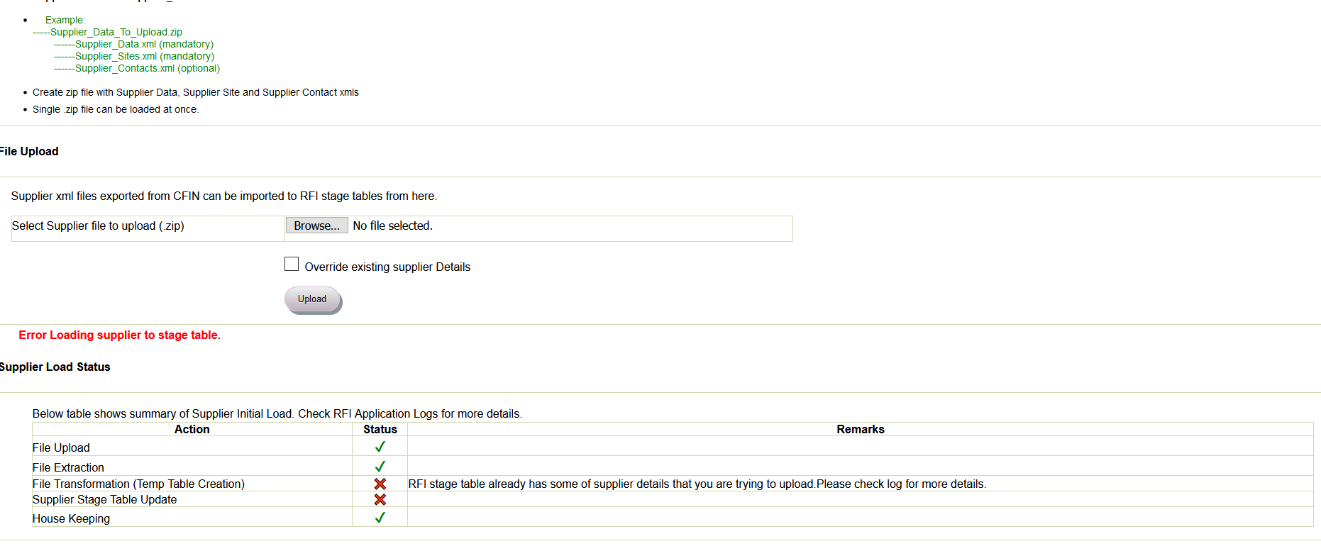

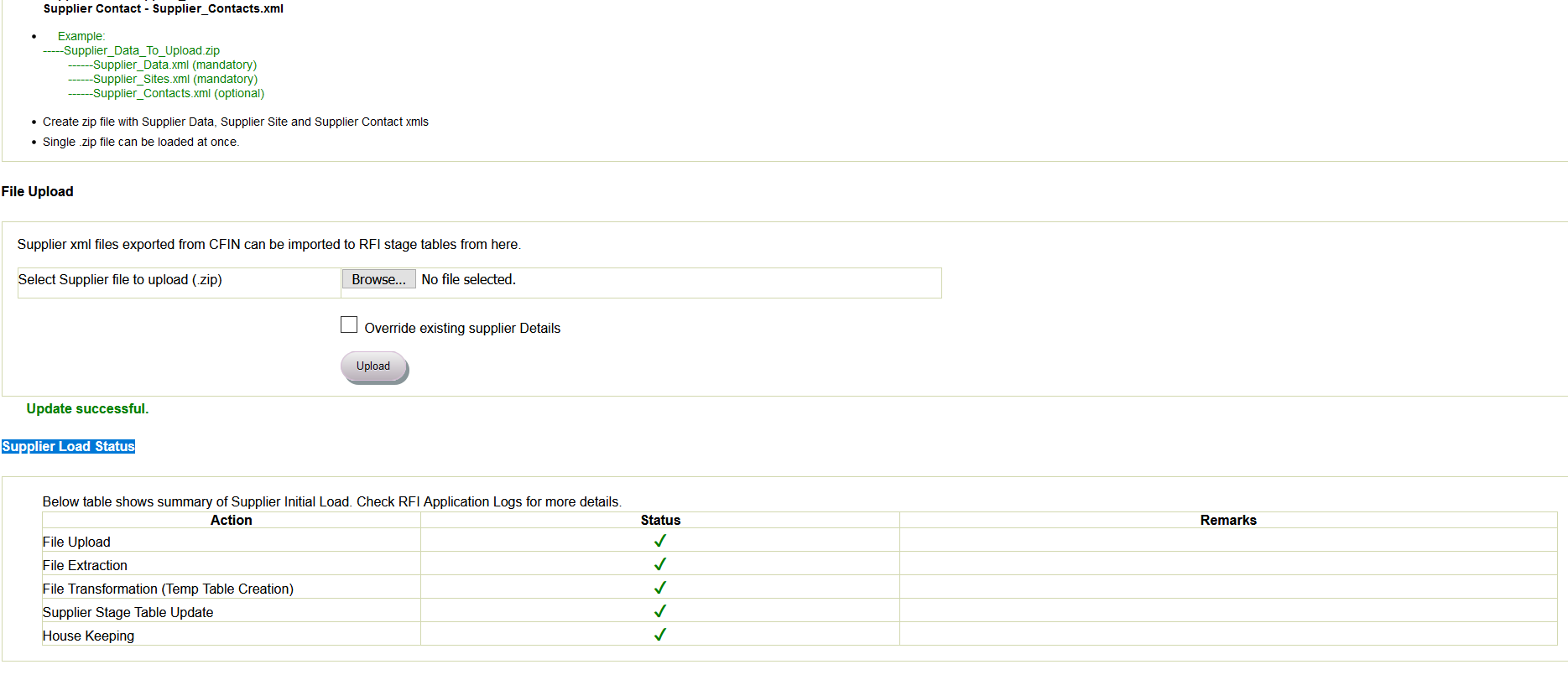

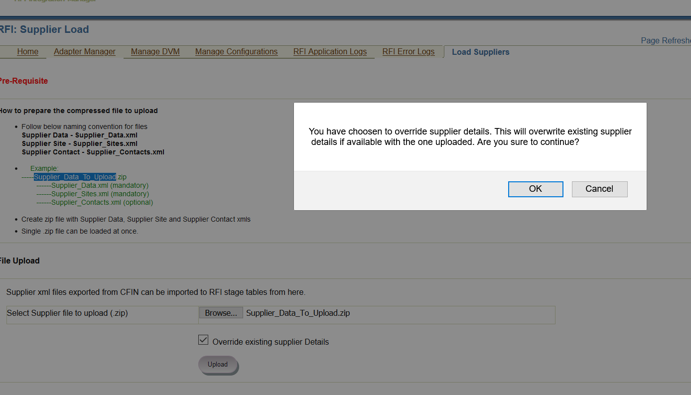

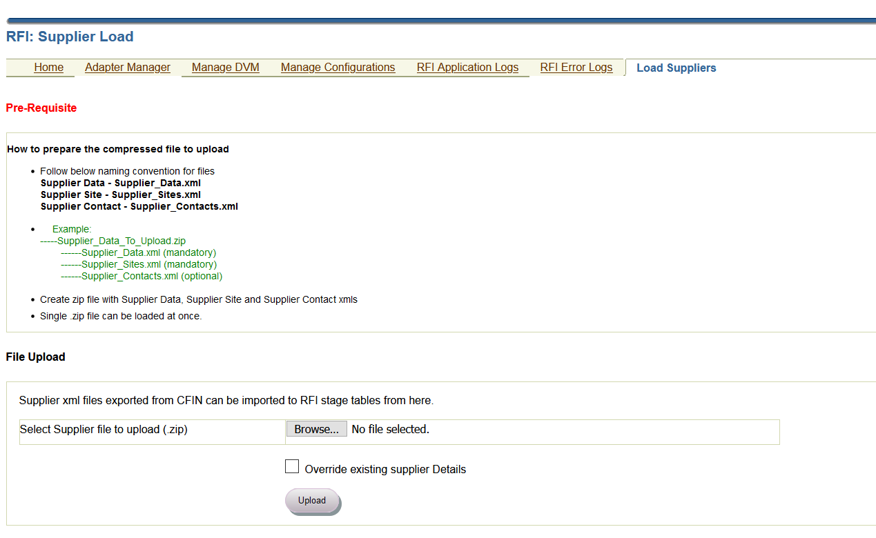

Upload Suppliers data to RFI: CFIN initial supplier data can be uploaded in RFI either by:
Running the scripts (By AMS via SR or by on premise customers having full permission and access) or
By using the RFI UI screen - Supplier Upload

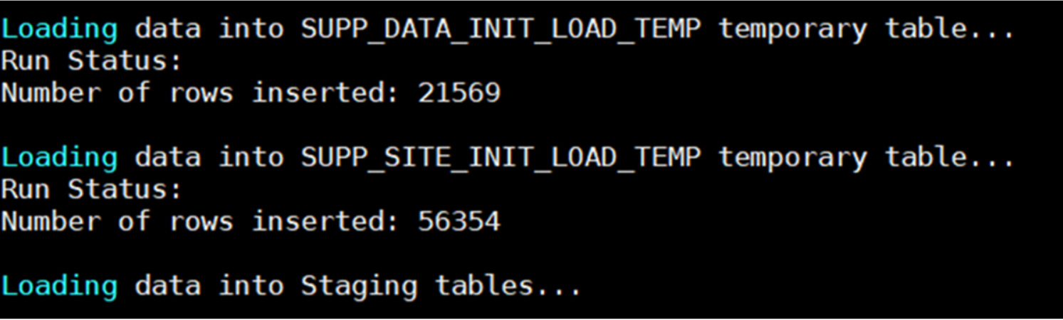

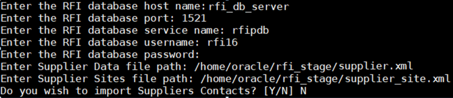

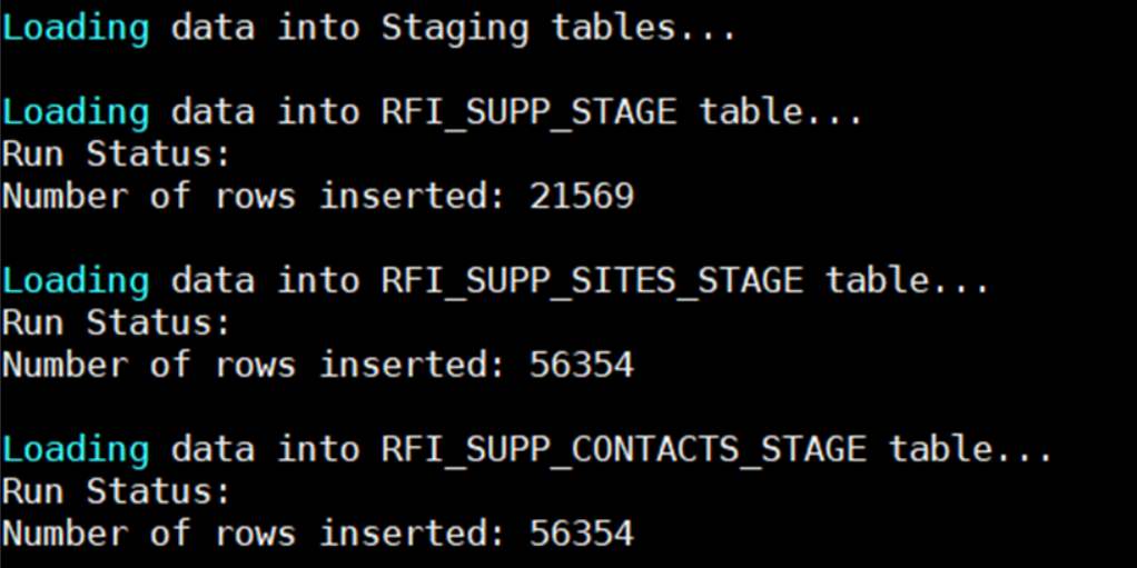

Supplier upload by Scripts: A wrapper script supplier_initial_load.sh is provided to load the existing Suppliers, Suppliers Sites and Contacts from flat files previously extracted from Cloud Financials to RFI staging tables. This file is available in the RFI pack, folder $INSTALL_DIR/etl-based-integration/retail-to-cfin-etl-flows/setup-data/dml.
Before running the supplier_initial_laod.sh script you should take into consideration the following notes:
If the previous version of supplier_inital_load.sh have been executed perform the following commands into your RFI database:
o ALTER TABLE RFI_SUPP_STAGE MODIFY VENDOR_ID VARCHAR2(50); o ALTER TABLE RFI_SUPP_SITES_STAGE MODIFY VENDOR_ID VARCHAR2(50);
The staging tables RFI_SUPP_STAGE, RFI_SUPP_SITES_STAGE and RFI_SUPP_CONTACTS_STAGE should be present in the RFI database and empty.
INSTALL_DIR and JAVA_HOME (JDK 1.8 or above) environment variables needs to be set.
Ex. INSTALL_DIR=/home/unix_user/staging_dir/retail-financial-integration-solution
This script is meant to be executed one time and one time only, if for some reason the loading process into RFI fails, the following steps need to be performed to run the script again:
Drop all temporary tables that are created during script runtime.
Truncate the staging tables if for some reason only part of the data were loaded.
Correct any errors in data set that you may encounter during load.
As previously mentioned, this script will load Suppliers, Suppliers Sites and Contacts into RFI being Supplier Sites Contacts the only data set optional to be imported. Since some Site Contacts information is mandatory in Oracle Retail, if you choose to do not import them into RFI, default ones will be created for each site.
Run supplier_initial_load.sh (./supplier_inital_load.sh).
The script will request some information to perform correctly:
Oracle RFI database server hostname (rfi_db_server)
Oracle RFI database port (1521)
Oracle RFI database service name (rfipdb)
Oracle RFI database username (rfi_db_user)
Oracle RFI database password
File path for Supplier data extracted from CFIN (No white spaces should be present in the file path)
File path for Supplier Sites data extracted from CFIN (No white spaces should be present in the file path)
If you chose to integrate Contacts, file path for Supplier Site Contacts data extracted from CFIN (No white spaces should be present in the file path)
Temporary tables will be created.
Data will be loaded into Temporary tables.
Suppliers, Supplier Sites, Supplier Contacts records are pushed to RFI Staging tables RFI_SUPP_STAGE, RFI_SUPP_SITES_STAGE, and RFI_SUPP_CONTACTS_STAGE respectively and temporary tables dropped.
The number of rows inserted into Temporary tables should be the same for staging tables.
Once the initial supplier details are moved to RFI Staging tables, the records are sent to Retail similar to the Supplier Incremental Loading process.
RFI Supplier upload by UI screen: Follow below steps to upload the supplier through UI-
Login to the RFI UI with valid credentials. Navigate to the Load Suppliers tab.
Create a compressed file (.zip) with Supplier xmls exported from CFIN. It is mandatory to follow below naming convention for suppliers to be loaded successfully.
Read the Pre-Requisite section carefully before uploading files.
Click the Browse button under the File upload section. Browse for the .zip file created in the above step.
Click the Override existing supplier Details check box to override existing suppliers (if found) with the details specified in the xml. A confirmation window appears asking to confirm selections.
Click OK to continue with the current selection or Cancel to reselect.
Note: RFI does not support partial update of supplier details. |
If the supplier ID that you are trying to upload is already available in RFI stage tables and the Override existing supplier Details check box is checked, then all details about that supplier are deleted from the RFI stage tables and the new details specified in the xml are loaded into the stage table.
If the supplier ID that you are trying to upload is already available in RFI stage tables and the Override existing supplier Details check box is NOT checked, then the supplier load process is terminated with an exception and no data gets loaded into the RFI stage tables.
The status of the supplier upload process is displayed in the Supplier Upload Status section. Navigate to the RFI Application Logs section for detailed logs.

This section provides an overview of the process integration for initial loading and incremental synchronization of payment terms between Oracle General Ledger (GL) and the Oracle Retail Merchandising System (RMS) and discusses:
Payment Terms integration details
Data requirements
Extensions
This section is applicable only if your Oracle GL system is PeopleSoft and not when it is Oracle E-Business Suite.
This integration is not supported by RFI for CFIN/EBS. Instead, users are expected to upload any incremental changes to exchange rates using the RMS Foundation Data Load functionality.

The diagram illustrates the Payment terms integration flow:-
PAYTERMBUSINESSEVENTHANDLERSER- Business Service Handler
Payment Terms EJB Service
RMS Payment Terms Service
RIBforRMS Payterms Subscriber
PeopleSoft invokes the Business Event service "PAYTERMBUSINESSEVENTHANDLERSER" whenever a payment terms is created or loaded into PeopleSoft which in turn calls the service in RFI.
The Business Event service extracts all the payment terms details from PeopleSoft tables and moves the details into RFI Database Staging table RFI_TERMS_HEAD and RFI_TERMS_DETAIL.
A Configured Timer for payment terms service invokes the Payment Terms EJB service.
The Payment Terms EJB service picks up the records from the RFI Database Staging table RFI_TERMS_HEAD & RFI_TERMS_DETAIL.
Then RMS Pay terms Service is invoked with the payment terms record.
If there are any errors in Payment terms EJB service, the errors are added to the logs file. The Payment terms logs can be viewed using the RFI Adapter Manager screens in RFI Administration GUI.

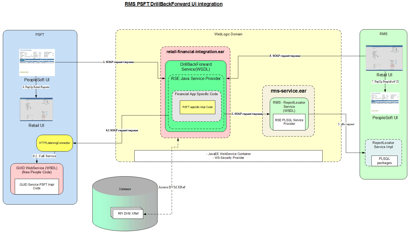

The diagram illustrates the drill forward and drill backward flow:-
The integration discusses uses the following services:
Drill Back Service
Drill Forward Service
Overall Flow
The drill back enables the user to:
Query ReIM using the payment voucher ID from the PeopleSoft Payables user interface (UI) to find invoices, credit notes, and debit memos that are used to generate the payment voucher.
Query RMS and ReSA from the PeopleSoft GL UI to find the source transactions that generated the journal entry in the ledger for revenue recognition and cash deposit postings.
Query RMS stock ledger from the PeopleSoft GL UI to find the source transactions for inventory valuation postings.
Query ReIM from the PeopleSoft GL UI to find the source transactions for aged receipt write-offs, manually paid invoices, and matched pre-paid invoices.
This integration uses the DrillBackForwardURLService.
The drill forward enables the user to:
Query PeopleSoft Payables from the ReIM UI using the invoice, credit note, debit memo, or document ID to query the resulting payment voucher.
Query the PeopleSoft GL from ReIM UI for aged receipt write-offs and prepaid invoices to audit the impact on the ledgers. For aged receipt write-offs, the receipt ID is used to access the PeopleSoft GL transaction. For prepaid invoices, the document ID is used.
Query PeopleSoft GL from the ReSA UI using the sales transaction document ID to audit the journal entry impact of the financials.
Query PeopleSoft GL from RMS UI using the stock ledger document ID or fixed deal reference ID to audit the journal entry impact of the financials.
When the drill back or drill forward process in initiated:
The source application calls the DrillBackForwardURLService web service to create a URL for the target system.
The source application passes an array of parameter name and value pairs and the name of the web service requestor (RETAIL or PSFT).
The web service invokes the DrillBackForwardURL Service hosted in RFI
The RFI Service based on the input parameter name and the web service requestor name looks up the RFI configuration properties file to construct the URL
If the target system is PSFT, the client implementation-specific information (host, port) file is fetched. A URL with retrieved information is constructed.
If the target system is RETAIL, then Oracle Retail web service is called to obtain the URL. The URL is returned to the caller of the service.
If an error occurs, a fault message is generated.
