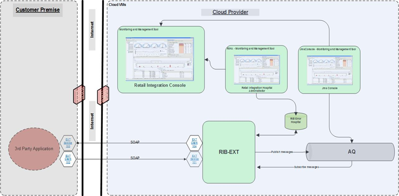

Integration Diagram
Implementing RIB-EXT
RIB-EXT is an Oracle Retail Integration Application that provides necessary communication channel for external applications to publish and consume message from RIB's JMS on cloud and premise.
How to Send/Receive Messages to/from the RIB System
There are two solutions for connecting the RIB-EXT with third party:

External Application as a Publisher (soap-app)
For external applications to publish to the RIB JMS on cloud, it needs to use a publishing webservice provided by rib-ext. This webservice is secured with PolicyA.
The end point of publishing service follows the pattern below:

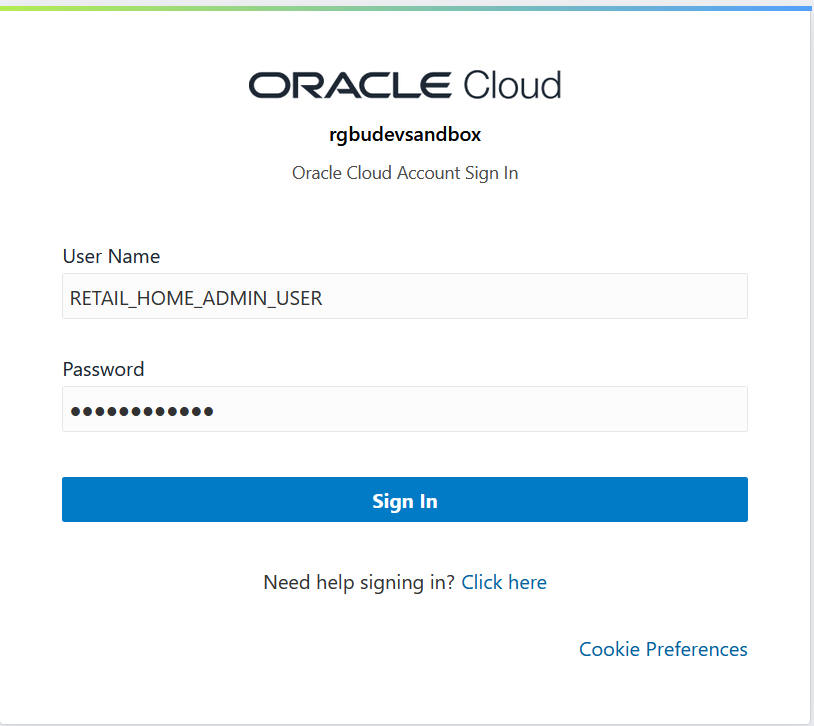

  1. Login into retail home as retail home administrator.
    login

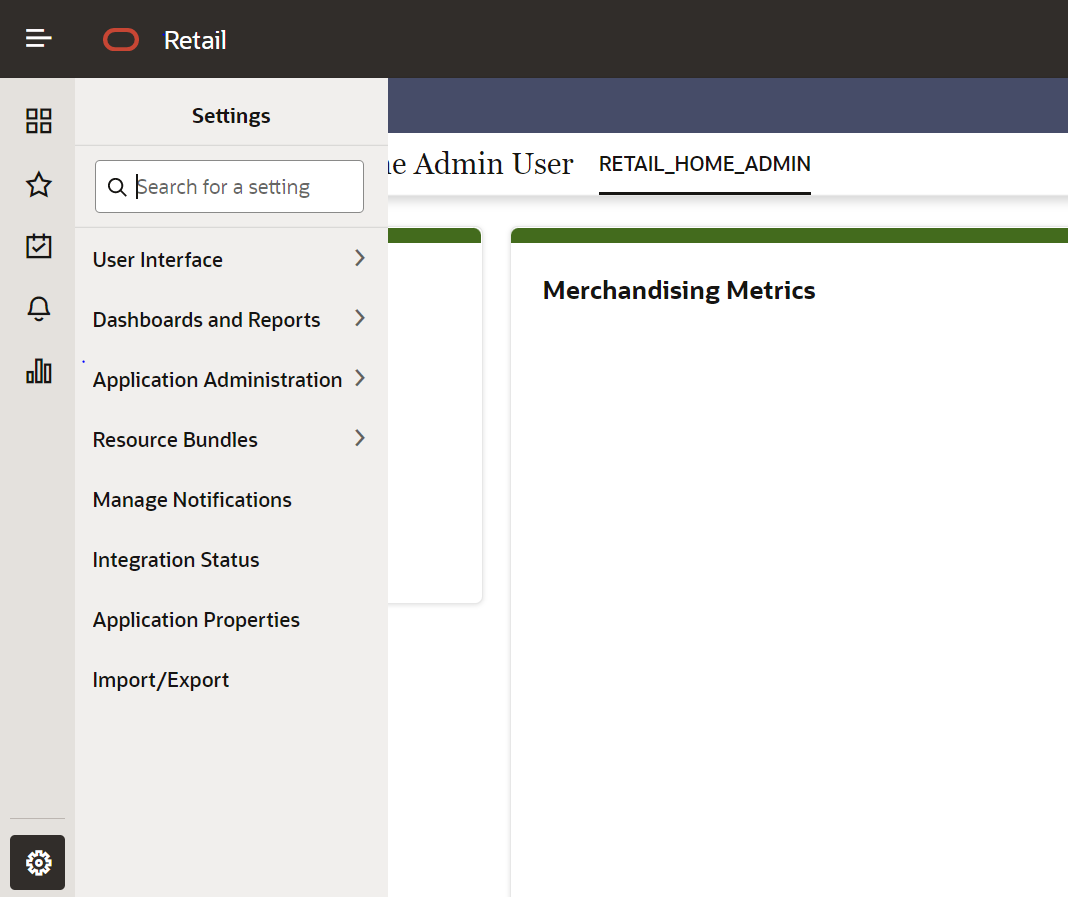

  2. In retail home screen click on Settings menu icon on the left and then click on Application Administration.
    application administration

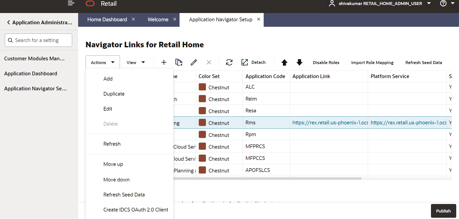

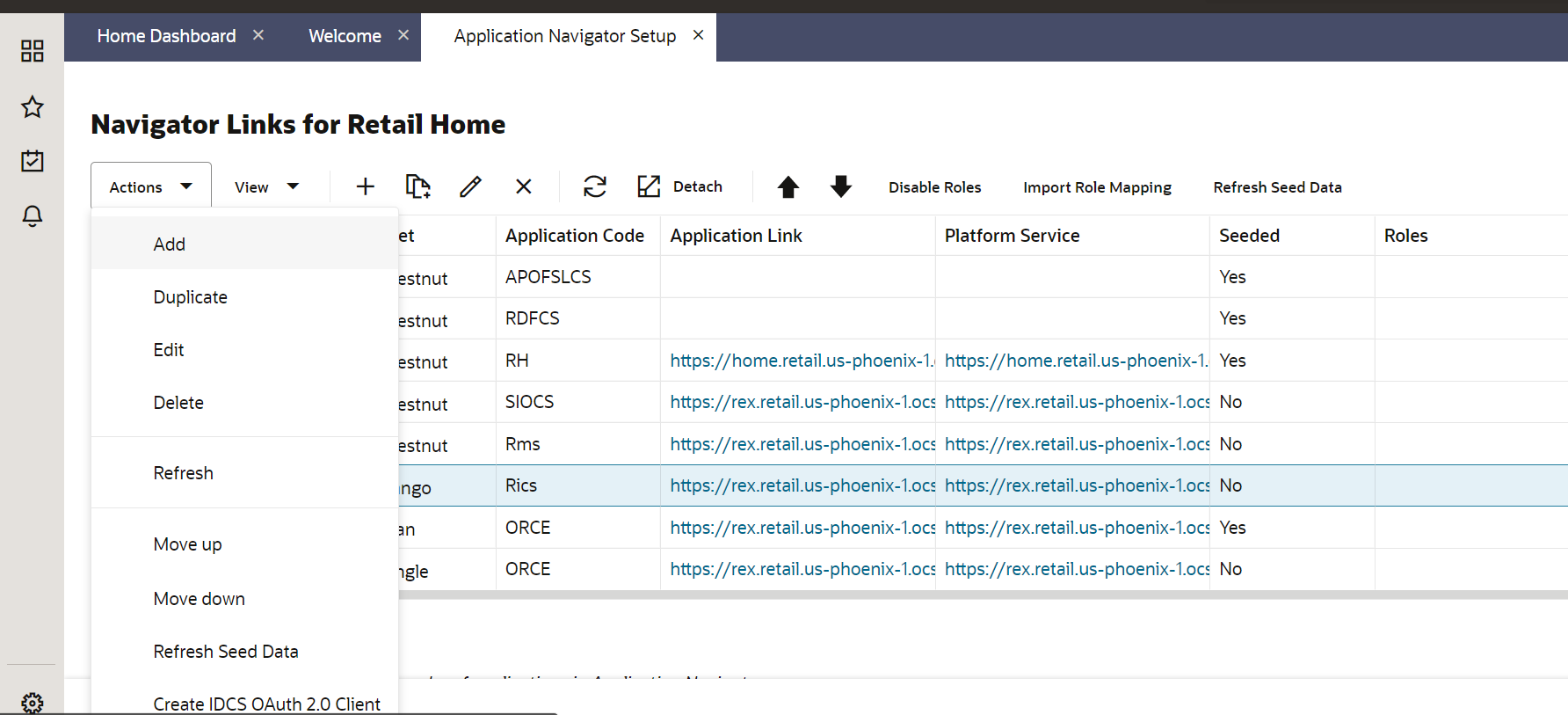

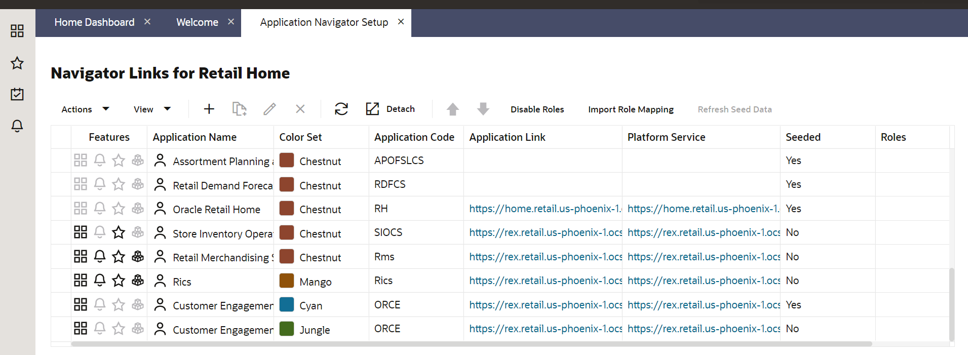

  3. On the Application Administra-tion menu click on Application Navigator Setup. Notice all the hosted applications are listed here with their application and plat-form service url.
    Settings -> Application Administration->Application Navigator Settings
    application navigator setup
  4. Look for application with name RICS. If you are not seeing RICS application try refreshing seed. Steps
    1. Select the row with the application code as Rms.
    2. Click the Refresh Seed Data button on top right corner of the menu.
    3. Wait for some time and refresh the screen.
    4. RICS should reflect now.
    RICS application name
  5. If RICS application is not reflecting even after following step 4. Select the row with the application code as Rms and click on the Actions menu on top left. Select Create IDCS OAuth 2.0 Client. A dialog will open for entering oauth2 client details.
    Create IDCS OAuth 2.0 Client option is available only for applications those have platform service URL mentioned. RICS is making use of merch platform service as both the apps are sharing same IDCS tenancy.
    application code RMS
  6. Skip this step if RICS application is not showing up. One of either Step 5 or Step 6 needs to be followed.
    Select a row with application code as RICS. Click on the Actions menu on top left and select Create IDCS OAuth 2.0 Client. A dialog will open for entering oauth2 client details.
    navigator links for retail Home

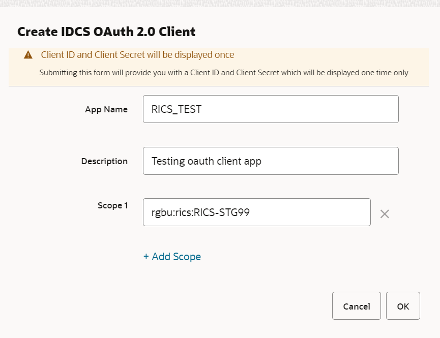

  7. This dialog takes the following values:
    App Name is 2-100 characters and will be used as the name in IDCS. Provide unique application name.
    Description is a detailed description of the application.
    Scope: <Custom environment-specific scope>
    The scope pattern that is used in the RICS IDCS app creation template is rgbu:rics:<SERVICETYPE>-<ENVIRONMENT> where SERVICETYPE is RICS and ENVIRONMENT is the environment type (STG, PRD, UAT, DEV1, DEV2, and so on).
    For example:
    "scope": "rgbu:rics:RICS-PRD""scope": "rgbu:rics:RICS-STG"
    create idcs oauth client
  8. When the application is created, another dialog will open to show the client ID and client secret of the new application. These values should be copied down to a safe location, as they will only be shown once. Retail Home cannot retrieve the credentials again after the dialog is closed.

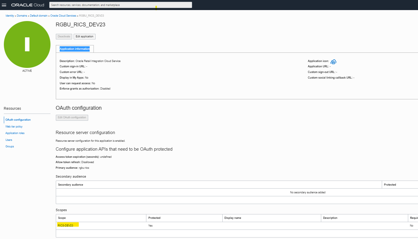

Prerequisites
  • IDCS should be same as RICS.
  • Use Client Credentials grant type with scope to provide access to resource.
  • Following is the screen shot of a sample IDCS app with scope added
IDCS app with scope
Follow IDCS documentation for detailed instruction on setup.

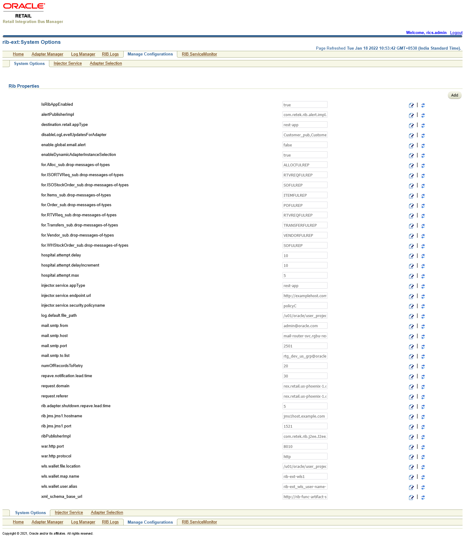

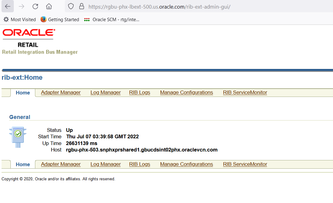

Access RIB Admin GUI
Access the rib admin GUI at https://<external-load-balancer>/rib-ext-admin-gui
Log in with the admin user.
login
Verify Configuration and update
Navigate to Manage Configurations -> System options
Search for and verify the following:

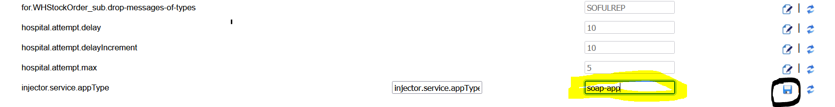

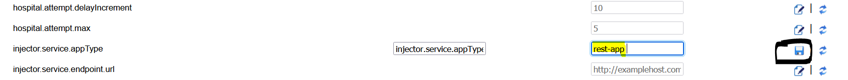

  1. destination.retail.appType: rest-app

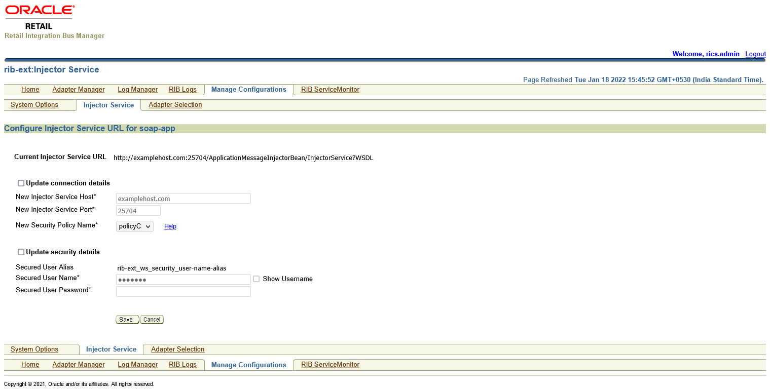

  2. Update the value for InjectorService URL (injector.service.endpoint.url). URL should point to inject service provided by external application. (e.g.- https://<host:port>/rib-injector-services-web/resources/injector/inject
  3. Security Policy (injector.service.security.policyname) : policyA
  4. IDCS OAuth Server URL (oauth2.default.authorizationServerUrl): https://<idcs-tenant>/oauth2/v1/token
  5. OAuth2 Token Scope: Default (i.e.- urn:opc:idm:__myscopes__)

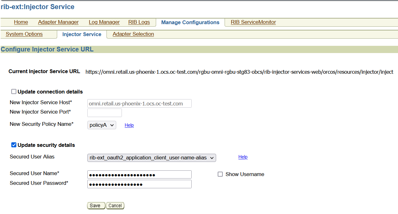

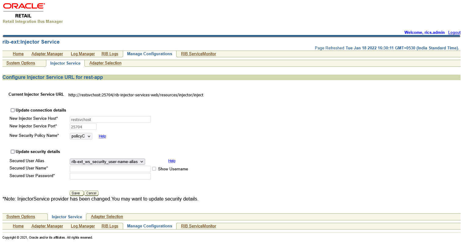

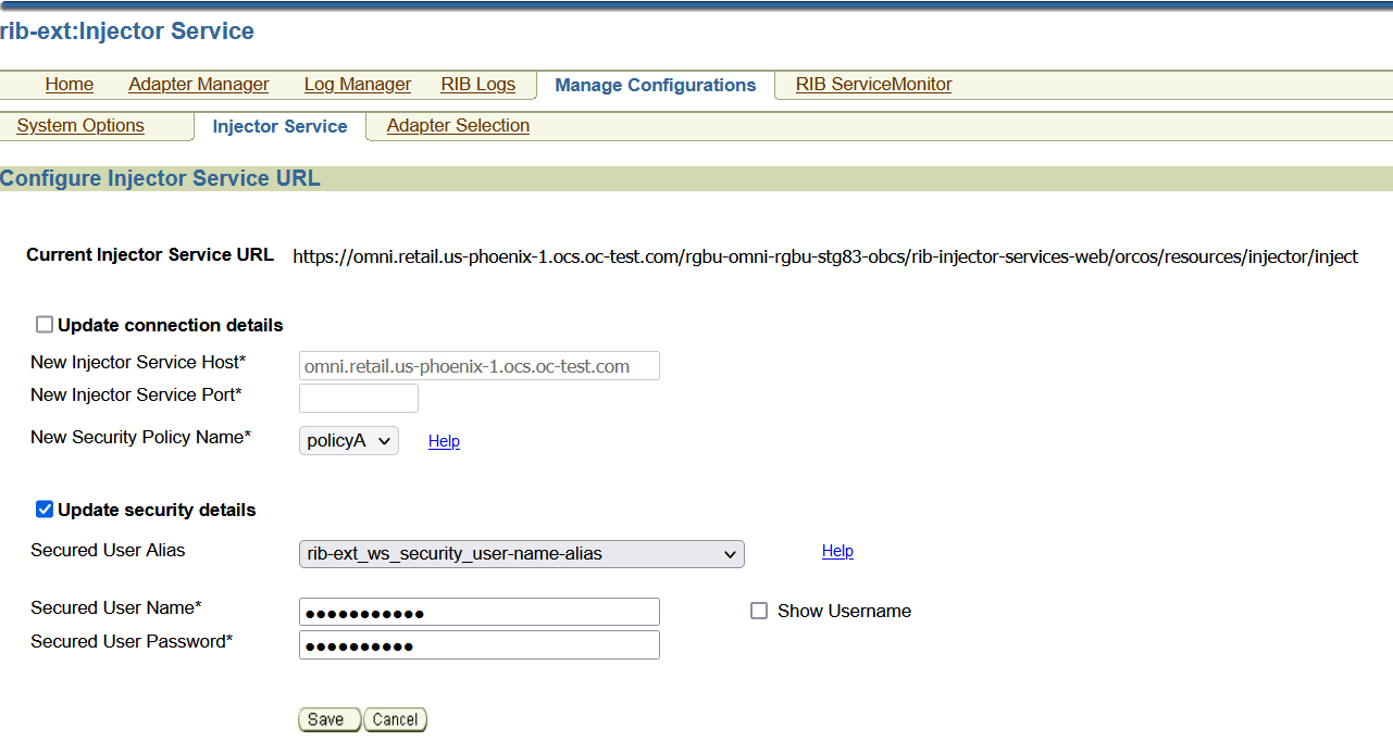

Steps for grant_type as password
Update username and password
Navigate to Manage Configurations - > Injector Service
Update details
  1. Choose rib-ext_ws_security_user_name_alias from drop down.
  2. Update rib-ext_ws_security_user_name_alias with valid username/password.
  3. Click on Save.
Surrounding text describes rib_ext3.png.

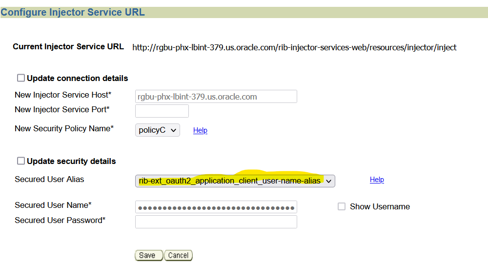

Update ClientID/Secret needed for token generation
Choose rib-ext_oauth2_application_client_user-name-alias from drop down and update details
  1. Provide a valid Client ID in username.
  2. Provide a valid Client Secret in password.

Steps for grant_type as client credentials
Update username and password to empty
Update details.
  1. Choose "rib-(app)_ws_security_user-name-alias" as Secured User Alias.
  2. Update the Secured User Name with a blank userName.
  3. Update the Secured User Password with a blank password.
  4. Click on Save.
Surrounding text describes rib_ext5.png.
Update details
  1. Choose "rib-(app)_oauth2_application_client_user-name-alias" as Secured User Alias.
  2. Update the Secured User Name with clientID.
  3. Update the Secured User Password with clientSecret.
Surrounding text describes rib_ext6.png.

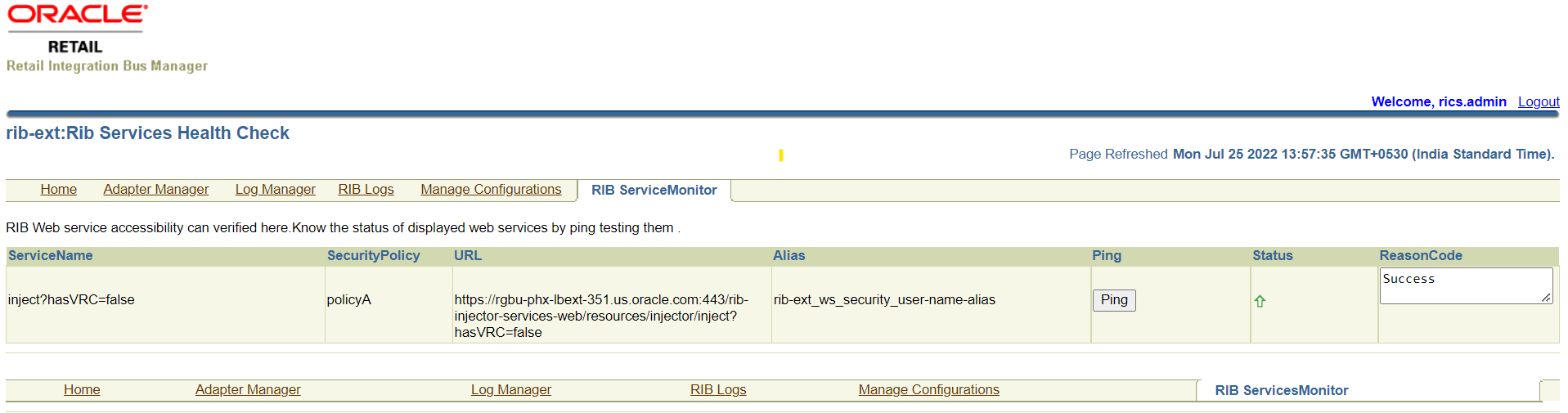

Ping Test
Navigate to Manage Configurations -> RIB Service Monitor
  1. Click on ping
  2. It should return success
Surrounding text describes rib_ext7.png.

How to switch Injector Service app Type at Runtime
RIB-EXT is a rest-app by default for CFS and expects injector service also to be of ResT type. ONLY for egress/migration customers who already have injector service SOAP implementation in GBUCS they should follow these steps to switch from rest to soap based injector calls and vice-versa.
How to Change rib-ext injector-service-app-type from REST to SOAP
  1. Open rib-ext admin gui. Go to Manage Configurations > System Options, observe new prop-erty i.e. injector-service-appType added to allow switching injector service app-type at runtime.
    By default rib-ext is deployed as rest-app so injector-service-appType is defaulted to.
    default rib-ext
  2. Edit injector-service-appType and update this to soap-app. Save the changes.
    soap app
  3. Navigate to Manage Configurations > Injector Service tab. Check for the correctness of injector service URL, ensure it points to correct ext-app injector service.
    Update rib-ext_ws_security_user-name-alias with correct username/password needed to make inject call.
  4. Setup is ready now. Do a ping test from RIB ServiceMonitor tab.
How to change rib-ext injector-service-app-type from SOAP to ReST
  1. Navigate to Manage Configurations > System Options from admin GUI. Look for injector-service-appType, update this property to switch from SOAP to ReST.Save the changes.
    system options
  2. Navigate to Injector Service tab. Update host/port and security credentials (rib-ext_ws_security_user-name-alias) if needed.
  3. Setup is ready now. Do a ping test from RIB Service Monitor tab.
