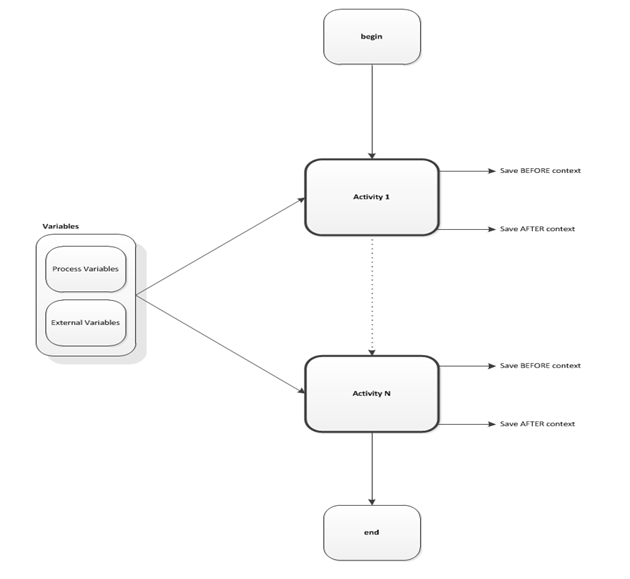

6 Process Flow
A process flow is a composition of one or more activities. It is written in a DSL script that contains all the activities that make a data flow from source to destination complete.
A process flow is a generic concept and is not limited to BDI. However all the out-of-box process flows are for data transfers from a retail application to one or more retail applications.
A process flow encapsulates a sequence of activities. An activity can be synchronous or asynchronous. In BDI some of these activities are invocations of batch jobs.
Figure 6-1 Process Flow
Surrounding text describes Figure 6-1 .

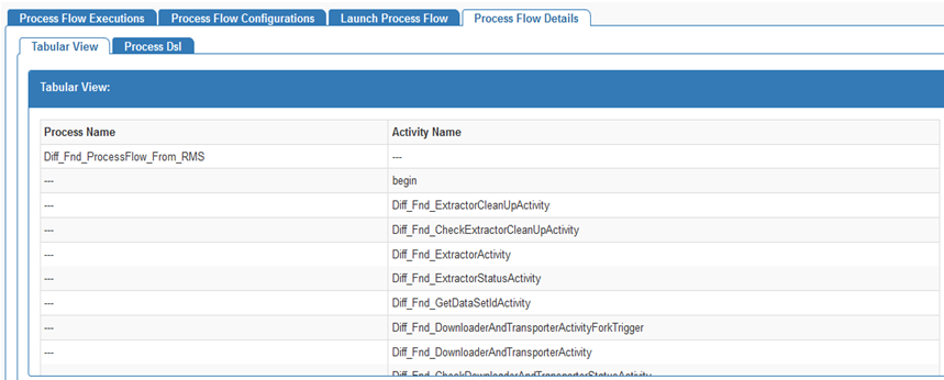

Process Flow DSL
This section describes the process flow DSL.
Process Flow DSL characteristics
The following are the characteristics of the Process Flow DSL:
  • Every process flow must have a name. The process flow name must match with the filename that the process flow is saved into.
  • Process flows are written in a DSL and saved as .flo files.
  • Process flow is made up of two special activities called ”begin” and ”end” and bunch of user defined activity nodes.
  • The ”begin” and ”end” activity will always run.

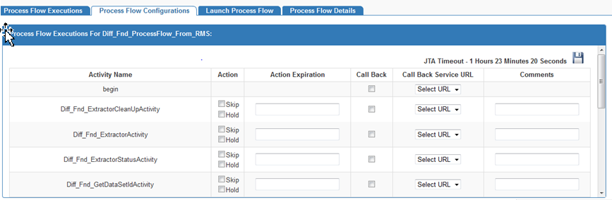

  • Built in activity SKIP functionality.
  • Built in activity HOLD and RELEASE functionality
  • Built in bulk skip and Hold functionality.
  • Built in SPLIT and JOIN functionality between process flows
    • SPLIT - one to many
    • JOIN - many to one

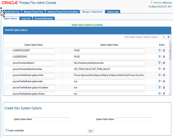

persistGlobalUserData(Str ing key, String value) persistGlobalUserData("key", "value") Method to persist data to be shared with other processes. Persists key value pairs in BDI_ SYSTEM_OPTIONS table.
String findGlobalUserData(Strin g key) findGlobalUserData("key") Gets value from BDI_ SYSTEM_OPTIONS table for a given key.
Map findAllGlobalUserData(Str ing key) findAllGlobalUserData() Returns a Map with all user data.
removeGlobalUserData(St ring key) removeGlobalUserData("key") Removes data for given key.

externalVariables Implicit def myVar = externalVariables['myKe y'] These are global variables that apply to all process flows. It comes from System Options table. Installation specific key values will be here.
processVariables Implicit var([ "myVar1":"prq", "myVar2":"xyz", "myVar3":"mno" ])

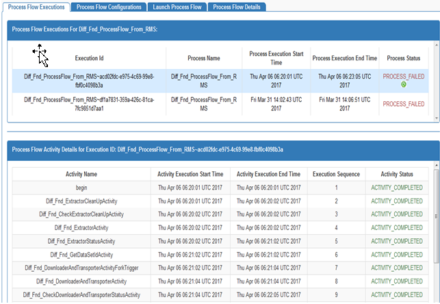

Process Flow Instrumentation
When the process engine executes the process flow, the before and after snapshots of the activity are recorded in the process schema.
The information is reported through the Process Flow Admin application. Process Flow Admin is a web application that provides a GUI to manage task workflows. This is useful for tracking the process flows as well as troubleshooting. The snapshots also help when restarting a failed process. From the schema, the process engine can recreate the context to execute a restart and can resume execution from the activity that failed in the previous run.
Process Flow Monitor Web Application
Process Flow (Admin UI) is a web user interface provided by Process Flow where users can view and execute processes, including managing, updating process flow, manually running processes, viewing process executions and process flow logs.
The following describes various functions available in the Process Flow UI in the current release.
It is recommended to use the Chrome web browser to access Process Flow UI since the calendar widget for datetime fields are supported by Chrome browser and not by Firefox or IE as of now.

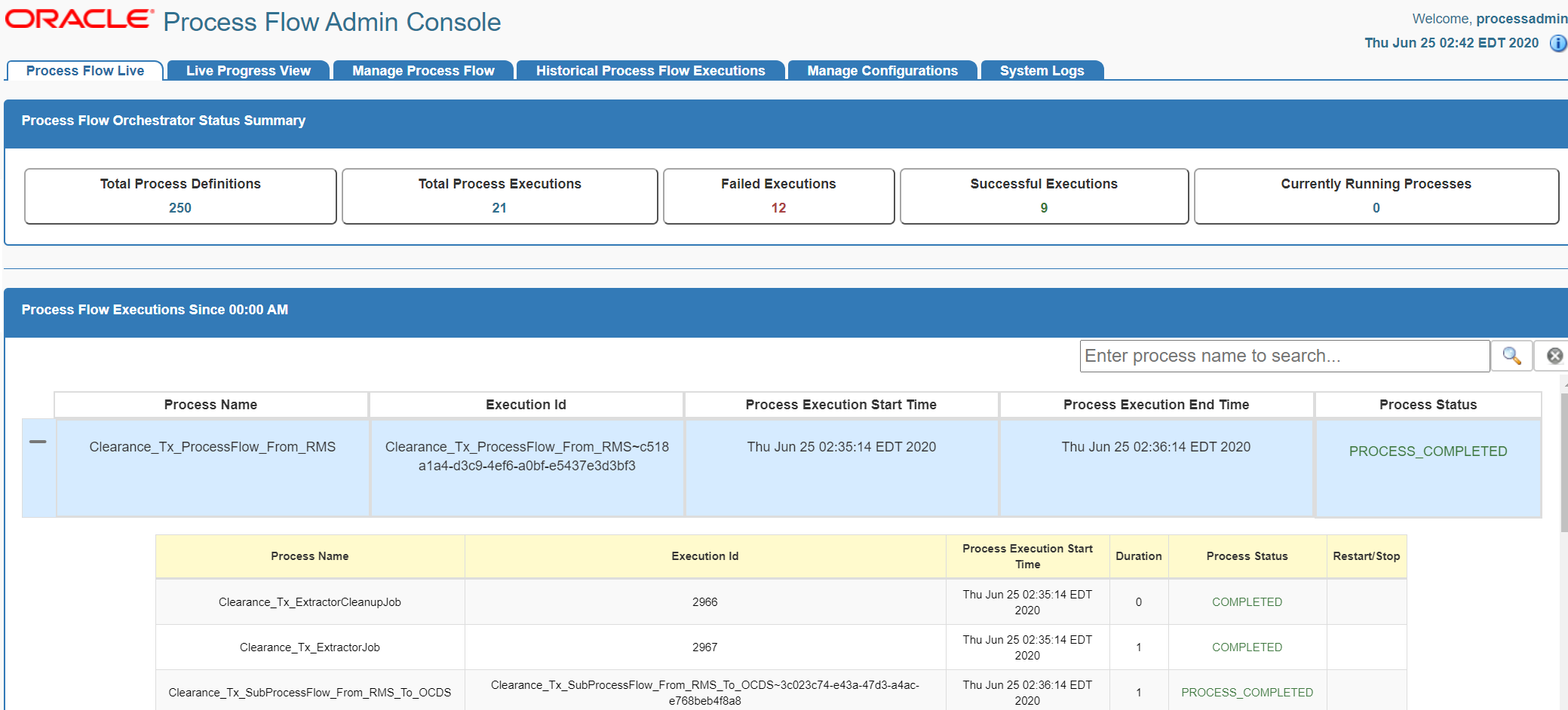

The Process Flow Live tab shows the details of the currently running processes. The first section shows the summary of all processes running in the system. The next section shows the list of all processes running since midnight. The last section shows the activity details of the selected process. Users also have the option to search for a process by its name.
Build version and date is displayed on the info icon when a user selects the same. The icon is on the extreme right top corner of the page.

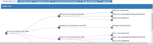

Execution Trace Graph
The Execution Trace Graph is also part of Process Flow Live tab. Execution trace graph shows the sub processes and jobs called from a process. The arrows show the relationship between the caller and the callee. The circular nodes of the graph represent the process or the job that was invoked. On hovering over the node, the details of the execution like name of the process or job, invocation time, status etc. are displayed.
Figure 6-3 Execution Trace Graph

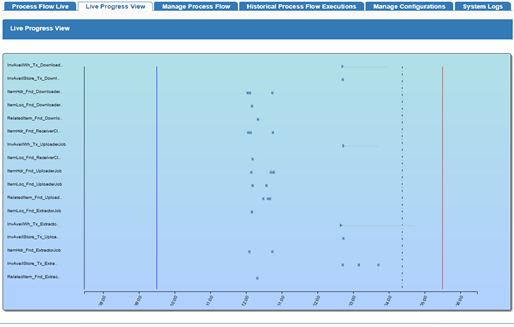

Live Progress View Tab
Figure 6-4 Live Progress View Tab
Live progress graph shows the batch status for a time window. Here are the details of the graph.
  • It shows all the jobs from all the JobAdmins configured in the process flow.
  • Currently the time window is 10 hours before the current time and one hour ahead of the current time.
  • Current time is the dotted line axis. The batch start time is the blue axis and batch end time is the red axis
  • The graph will refresh itself every second. So the axis, jobs and all related information will update
  • The time window will move as the current time axis nears the end of the graph
  • Each job is represented by an arrow. The color of the arrow will be red (errored jobs), blue (running jobs) or green (completed jobs). The length of the arrow will be same as the time taken for the job.
  • Same jobs will appear in the same line.

Process Flow Executions
Figure 6-6 Process Flow Executions
Surrounding text describes Figure 6-6 .
This tab shows the executions of the selected process. It can be used to restart the failed executions of a process. The Restart button is available only for restartable executions in the status column. When the user clicks the restart button it is redirected to the process launch tab.
Process Flow Configurations
Figure 6-7
Surrounding text describes Figure 6-7 .
This tab provides various features for activity configurations for the selected process like Skip, Hold, Callback. Admin and operator have permissions to update activity configurations.

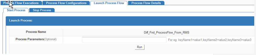

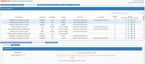

Launch Process Flow
Figure 6-8 Launch Process Flow
Surrounding text describes Figure 6-8 .
This tab can be used to start or stop process the selected process. Start Process subtab used to launch Process. Only enabled processes can be launched. The run button is disabled for the disabled processes. Process Parameters is an optional input from the user to launch the process. Process parameter acts as query parameter and refers to a key value pair. Multiple process parameters can be entered in comma separated value format. Stop Process subtab is used to Stop a process execution. Stop will be a graceful stop, which means current executing activity will be first completed and then process will be stopped. If activity is not running, Stop will not bring any action.
Process Flow Details
Figure 6-9 Process Flow Details
Surrounding text describes Figure 6-9 .
This tab shows process definition in form of a DSL file configured during deployment of the selected process. The Admin user also has the option to modify process DSL. Once updated the process DSL from the UI, changes will take into effect into the BDI_PROCESS_DEFINITION table and no need for process redeployment.

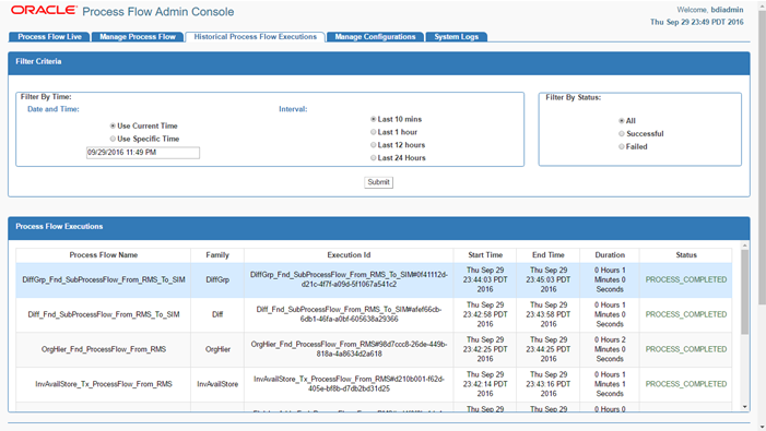

Historical Process Flow Executions Tab
Figure 6-10 Historical Process Flow Executions Tab
Surrounding text describes Figure 6-10 .
The Historical Process Flow Execution tab allows the user to look at the history of process flow executions. The user can specify a date, a time interval and process status. The application will list all the process flow executions matching the criteria. The User can select any of the flow to see the activities details of that execution instance. The page also provides the option to view the before and after values of all process variables for each activity.

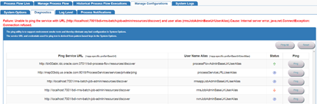

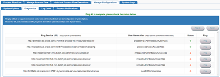

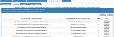

Ping Feature: The ping utility is to support environment smoke tests and thereby eliminate any bad configuration in System Options.
  • The service URL and credentials used for ping test is derived from pattern based keys in the System Options.
  • The default Ping Service URL is combination of App specific BaseUrl + Discover service as suffix. POAM ping service URL is combination of BaseUrl + Default ping service as prefix (services/private/ping)
  • User can ping individual app URL and see the success/failure message on the TOP. Also, there will be a status column which shows UP Arrow image for success and DOWN arrow image for failure.
  • User can also use Ping All feature to ping all the URLs at one time and the responses will be shown on the status column against each URL.
  • Reset button is to reset the cache and do a fresh service call.
  • All roles are able to ping services i.e. MonitorRole, OperatorRole and AdminRole users.
Figure 6-12 PING with Success Message
PING with success message
Figure 6-13 PING with Failure Message

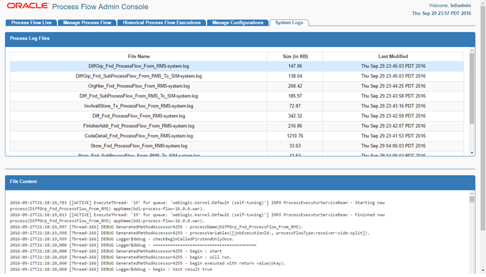

System Logs Tab
Figure 6-15 System Logs Tab
Surrounding text describes Figure 6-15 .
The System Logs tab shows all the log files created by the process flow execution. Clicking on the View icon will show the log file contents in the screen.

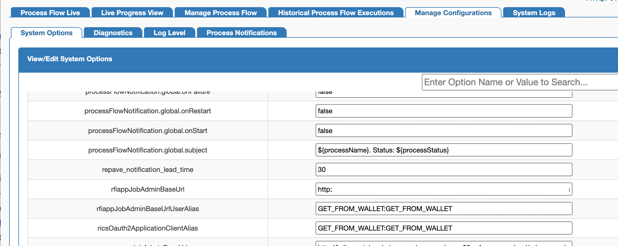

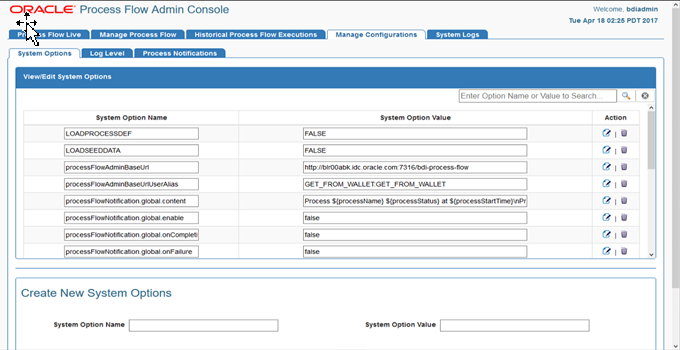

The Process Flow notification options can be set in the System Options of the Process Flow. This can be done either at deployment time (through seed data) or at runtime (through the Manage Configuration tab of the Process Flow Monitoring application)
The options available for notification are:
  • processFlowNotification.<scope>.enable - value must be True or false. This is for global enabling or disabling of process flow notification.
  • processFlowNotification.<scope>.onStart - value must be True or false. True means notification will be sent at the start of the process.
  • processFlowNotification.<scope>.onRestart - value must be True or false. True means notification will be sent at the restart of the process.
  • processFlowNotification.<scope>.onCompletion - value must be True or false. True means notification will be sent at the completion of the process.
  • processFlowNotification.<scope>.onFailure - value must be True or false. True means notification will be sent when the process fails.
  • processFlowNotification.<scope>.recipients - list of recipient email ids
  • processFlowNotification.<scope>.subject – Template of the email subject line
  • processFlowNotification.<scope>.content – template of email content
where <scope> value is global or the Process Name.
If Process Name is specified, the global notification option is ignored for that process. For Subject and Content, if nothing is specified either at the global or process scope, an internal default format is used.
If Mail Session is not setup in WebLogic, notifications will not be sent. If processFlowNotification.<scope>.recipients is not set, the value from mail.to property in the WebLogic Mail Session is used.
For Subject and Content template, following variables can be used. The variable is case sensitive and the format must match exactly as given below. For multi-line content, \n can be used to indicate line breaks.

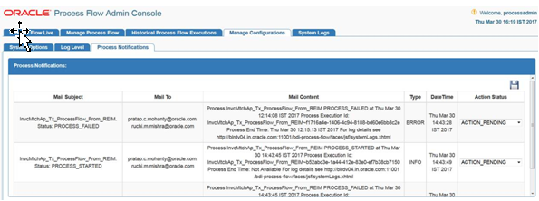

Persisting Process Notifications
All process notifications are persisted to the BDI_EMAIL_NOTIFICATION table. There is a subtab Process Notifications added in Manage Configurations tab which displays all the notifications.
One notification icon appears right top corner of the screen adjacent to the user if there is any notification in PENDING status. User will be navigated to the Process Notifications subtab by clicking on the image.
User can modify the status to COMPLETED after going through the notification and click on save button so that next time it doesn't appear on the screen.
Figure 6-16 Persisting Process Notifications
Surrounding text describes Figure 6-16 .
Repave.Notification lead time by default is 30. It can be modified by the user through System Options by editing the repave_notification_lead_time.
Figure 6-17 Repave Notification Lead Time

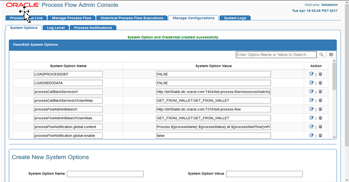

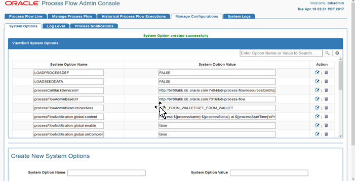

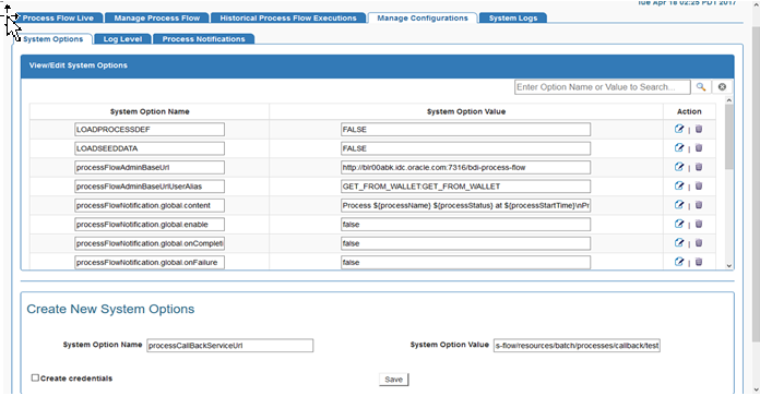

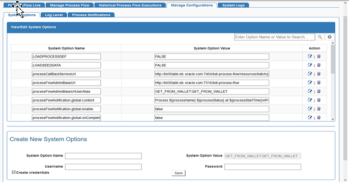

  • Setup the callback URL in processflow system options. To configure a callback URL you should add system options like <serviceName>CallbackServiceUrl, for eg., processCallbackServiceUrl.
    • In Process Flow admin console, navigate to Manage Configurations tab and System Options sub-tab.
      Figure 6-18 System Options Tab
      Surrounding text describes Figure 6-18 .
    • Scroll down to Create New System Options, enter System Option Name and System Option Value. Url should be a valid ReST Service.
      Figure 6-19 Create New System Option Value
      Surrounding text describes Figure 6-19 .
    • Click Save.
      Figure 6-20 View/Edit System Options
      Surrounding text describes Figure 6-20 .

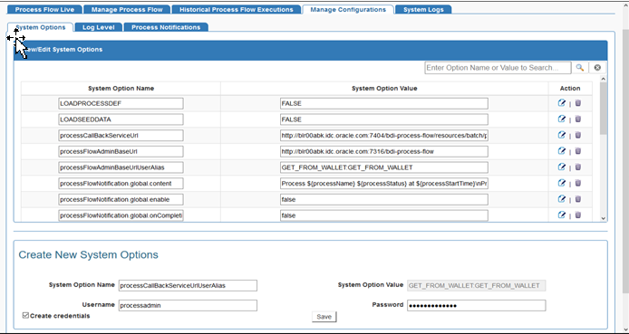

  • Setup the callback URL credential alias in process flow. To add callback URL credential alias you should add credential alias like <serviceName>CallbackServiceUrlUserAlias, for eg., processCallbackServiceUrlUserAlias.
    • In the Create New System Options section, select Create Credentials checkbox.
      Figure 6-21 Create Credentials
      Surrounding text describes Figure 6-21 .
  • Enter System Option Name, Username and Password for the URL provided in the previous step. If the System Option Name for the URL is processCallbackServiceUrl then System option name for credential should be processCallbackServiceUrlUserAlias.
    Figure 6-22 View/Edit System Options
    Surrounding text describes Figure 6-22 .
  • Click Save.
    Figure 6-23 Save System Options and Credentials
    Surrounding text describes Figure 6-23 .
    Credentials created through UI are available after server restart, but after redeployment of the application credentials have to be created again.

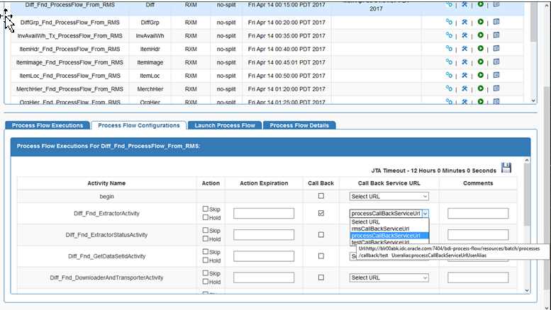

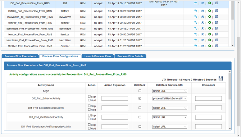

  • Navigate to Manage Process Flow tab and select process flow, go to Process Flow Configurations sub-tab.
  • Select Callback checkbox for the activities you want callback to be enabled. Select Callback URL from drop down list.
    Figure 6-24 Process Flow Configurations
    Surrounding text describes Figure 6-24 .
  • Click Save.
    Figure 6-25 Save Process Flow Configuration
    Surrounding text describes Figure 6-25 .

Process Execution Trace
The Process Flow engine keeps track of process execution details in the BDI_PROCESS_CALL_STACK_TRACE table. In order for a sub-process to appear in the trace, the sub-process must be called with the api as shown below.
triggerProcess(<Base URL>, <Sub Process Name>, <credentials>, <Process Parameter Map>)
Example:
triggerProcess("http://host:port/bdi-process-flow", "DiffGrp_Fnd_ProcessFlow_From_RMS", "userid:password", null)
REST end point to get process execution trace
http://<host>:<port>/bdi-process-flow/resources/telemetry/processes/execution-trace/{ProcessExectionId}
Sample Output:
  "executionId": "Diff_Fnd_ProcessFlow_From_RMS~8e1c7c11-1302-409d-9102-c55fffbdc1ab",
  "executionName": "Diff_Fnd_ProcessFlow_From_RMS",
  "activityExecutionId": "",
  "url": "",
  "status": "PROCESS_COMPLETED",
  "duration": 0,
  "type": "PROCESS",
  "invocationTime": "2017-07-19T12:21:20.061-06:00",
  "children": [
      "executionId": "ItemImage_Fnd_ProcessFlow_From_RMS~89f46519-50ab-4a51-a6fb-c6c5395afeca",
      "executionName": "ItemImage_Fnd_ProcessFlow_From_RMS",
      "activityExecutionId": "Activity2~a408b407-c4f0-4137-ba32-6ddd148f0838",
      "url": "http:\/\/msp8917:8001\/bdi-process-flow\/resources\/batch\/processes\/operator\/ItemImage_Fnd_ProcessFlow_From_RMS",
      "type": "PROCESS",
      "invocationTime": "2017-07-19T12:21:20.534-06:00",
      "children": [
      "executionId": "DiffGrp_Fnd_ProcessFlow_From_RMS~bb68a1ea-86a5-4108-aa58-b9e791d1fb8c",
      "executionName": "DiffGrp_Fnd_ProcessFlow_From_RMS",
      "activityExecutionId": "Activity1~602ad027-7946-4820-acd8-cf452f5fc937",
      "url": "http://host:port/bdi-process-flow/resources/batch/processes/operator/DiffGrp_Fnd_ProcessFlow_From_RMS",
      "type": "PROCESS",
      "invocationTime": "2017-07-19T12:21:20.296-06:00",
      "children": [
          "executionId": "ItemHdr_Fnd_ProcessFlow_From_RMS~3886b39f-6268-4895-8e5e-300ded42665b",
          "executionName": "ItemHdr_Fnd_ProcessFlow_From_RMS",
          "activityExecutionId": "Activity2~8e9f9a6a-440a-41dd-a648-f4322102012b",
          "url": "http://host:port/bdi-process-flow/resources/batch/processes/operator/ItemHdr_Fnd_ProcessFlow_From_RMS",
          "type": "PROCESS",
          "invocationTime": "2017-07-19T12:21:20.705-06:00",
          "children": [
          "executionId": "InvAvailWh_Tx_ProcessFlow_From_RMS~6c462406-a991-4754-9d94-73628091114a",
          "executionName": "InvAvailWh_Tx_ProcessFlow_From_RMS",
          "activityExecutionId": "Activity1~e7f8e9fa-7ba6-4a51-81e2-bdcfe752c15e",
          "url": "http://host:port/bdi-process-flow/resources/batch/processes/operator/InvAvailWh_Tx_ProcessFlow_From_RMS",
          "type": "PROCESS",
          "invocationTime": "2017-07-19T12:21:20.538-06:00",
          "children": [

Process Customization
Seed Data
During the deployment of Process Flow, seed data gets loaded. Seed data files are located in "bdi-process-home/setup-data/dml" folder. If seed data is changed, Process Flow needs to be reinstalled and redeployed. For loading seed data during redeployment, LOADSEEDDATA flag in BDI_SYSTEM_OPTIONS need to be set to TRUE.
Process DSL Reload
Along with seed data, the process DSL also gets loaded to BDI_PROCESS_DEFINITION table during the deployment time. Process DSLs are located in "bdi-process-home/setup-data/dsl/flows-in-scope" folder. If you want to load DSLs again after DSLs are added or update, Process Flow needs to be redeployed. For loading DSLs during the redeployment, LOADPROCESSDEF flag in BDI_SYSTEM_OPTIONS table need to be set to TRUE.
Deployment of Process Flow first time loads both seed data and process DSLs.
Redeployment loads seed data depending on the LOADSEEDDATA and LOADPROCESSDEF flag values.
Before redeployment make sure for every install/upgrade one needs to look at /available_process_flow_options/rms_enterprise-sender_side_split_flows i.e. /bdi-process-home/setup-data/dsl//available_process_flow_options/rms_enterprise-sender_side_split_flows, to ensure they have the correct set of flows for that installation, each release would bring in functional changes and flows files define the primary functional definition of a BDI integration flow.

Auto Purge Process Flow Infra Data
A timer thread runs every hour to delete data from process flow infra tables which have crossed specified purge delay.
Below are the steps performed to auto purge process flow execution data.
  • Check if "autoPurgeProcessFlowInfraData" flag is available and is set to true. If yes, continue with next step. Default "autoPurgeProcessFlowInfraData" to true if missing in System options table.
  • Get value of "autoPurgeProcessFlowInfraDataDelay" from System option table. Default delay to 60 days is missing in System Options table.
  • Query table BDI_PROCESS_EXEC_INSTANCE to get "PROCESS_EXECUTION_ID" whose "process_exec_start_time" has exceeded delay configured for process flow executions which are in completed or failed state. This list decides records that can be purged from Process flow infra tables.
  • Create a new method which accepts list of execution ids (List<String> executionIDs).
  • Purge data from BDI_ACTIVITY_EXEC_INSTANCE table if "process_execution_id" field matches ids available in executionIDs.
  • Purge data from BDI_PROCESS_CALL_STACK if "caller_process_exec_id" field matches ids available in executionIDs.
  • Purge data from BDI_PROCESS_EXEC_INSTANCE if "process_execution_id" field matches ids available in executionIDs.
  • Purge data from BDI_EMAIL_NOTIFICATION table whose email_notification_datetime has exceeded delay configured.
Follow below steps to update auto purge configurations.
Turn OFF/ON auto purge:
  1. Login to BDI batch job admin UI with valid Credentials.
  2. Navigate to "Manage Configurations" tab. Select "System Options".
  3. Update value of " autoPurgeProcessFlowInfraData" to true/false to turn off/on auto purge
  4. If " autoPurgeProcessFlowInfraData" is not available add it using "Create New System Options" option.
Update delay:
  3. Update value of " autoPurgeProcessFlowInfraDataDelay" to desired delay.
    If "autoPurgeBatchInfraData" is not available add it using "Create New System Options" option.
Troubleshooting
Since the process flow can be written in Groovy and DSL, it is prone to programmer's mistakes. Any custom DSL must be properly tested before deploying. At present, the process flow engine can detect syntax errors only at runtime. So it is possible to load an incorrect process flow and fail during runtime.
At the end of an activity, the process engine invokes the next activity depending on the result of activity execution (The "moveTo" statement). If you have empty activities (possibly because you commented out the existing invocation statements), make sure the activity result is valid (for example, "okay")
If any activity fails, the process is marked as failed. So in case of process failure, look at the activity details to find out which activity failed. Once the failed activity is identified, the process variables can be inspected to look for any issues. Next step would be to look at the logs, through the Process Flow Monitor application to see the details of the issue. Once the issue is fixed, either restart or a new run of the process flow can be used depending on the requirement.
BDI Process flow runtime XML UnmarshallException
Error
BDI Process Flow fails and GUI is showing this exception:
Runtime Process Flow exception
[Thread-55] ERROR Logger$error$0 - Error calling activity. javax.ws.rs.ProcessingException: Unable to unmarshall json object to java object.
OR
Caused by: javax.xml.bind.UnmarshalException - with linked exception:
[Exception [EclipseLink-25004] (Eclipse Persistence Services - 2.6.1.v20150916-55dc7c3): org.eclipse.persistence.exceptions.XMLMarshalException.
Exception Description: An error occurred unmarshalling the document
Internal Exception: javax.json.stream.JsonParsingException: Unexpected char 73 at (line no=1, column no=1, offset=0)]
Reason
Process flow deployed with wrong credentials for apps.
Solution
Delete existing process flow deployment from weblogic domain. Redeploy process flow with setting up new credentials.
BDI Process flow stuck in running state
Issue:
BDI Process Flow keeps in running status and does not end with failed or completed state. This even does not allow to cancel an existing running process or start a new process.
Reason:
This happens because of default JTA Timeout in domain configuration, and resource connections not able to timeout. There are instructions in BDI installation guide "How to Set JTA Timeout".
Resolution:
Follow the instructions in the BDI Implementation guide and set JTA timeout. Redeploy the processflow app to stop the running flow and rebounce the server.
Process Flow Did Not Start
To address this, verify the logs. It could be due to the missing Credentials Access permission, missing system credentials, or a missing system options or DSL parsing error.
Deleted process flow still listed in the UI
Deleting a process flow from bdi-process-home doesn't deletes it from the process flow application, because the process flow application refers the database entries, so in order to delete a process flow from BDI Process Flow app, the script DELETE_PROCESS_FLOW.sql(bdi-process-home/setup-data/dml/) has to be run in BDI ProcesFlowAdminDataSource Schema.
