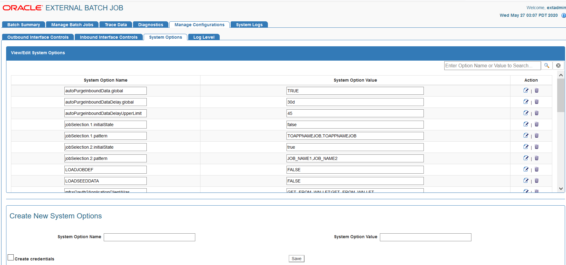

Steps to update values in System Options
Approach 1: Update via UI
Login to the job admin web page with valid credentials.
Click the Manage Configurations tab.
Click the System options tab.
Search for the system option to update. Example: autoPurgeInboundData.global, autoPurgeInboundDataDelay.global, autoPurgeInboundDataDelayUpperLimit etc.
Click the Edit icon to update the value and click the Save icon to save changes.
Approach 2: Update values via REST service endpoints
Below end point can also be used to update System Options via REST service.
URL:
http://<host:port>/<appName>-batch-job-admin/resources/system-setting/system-options
Request Type :
POST
Input Json Example:
"key": "autoPurgeInboundData.global",
"value": "false"
Note: Update key and value in above request with appropriate System Option name and value to be updated. |

Follow below steps to update auto purge configurations.
Turn OFF/ON auto purge:
Login to BDI batch job admin UI with valid Credentials.
Navigate to "Manage Configurations" tab. Select "System Options".
Update value of "autoPurgeBatchInfraData" to true/false to turn off/on auto purge
If "autoPurgeBatchInfraData" is not available add it using "Create New System Options" option.
Update delay:
Update value of "autoPurgeBatchInfraDataDelay" to desired delay.
