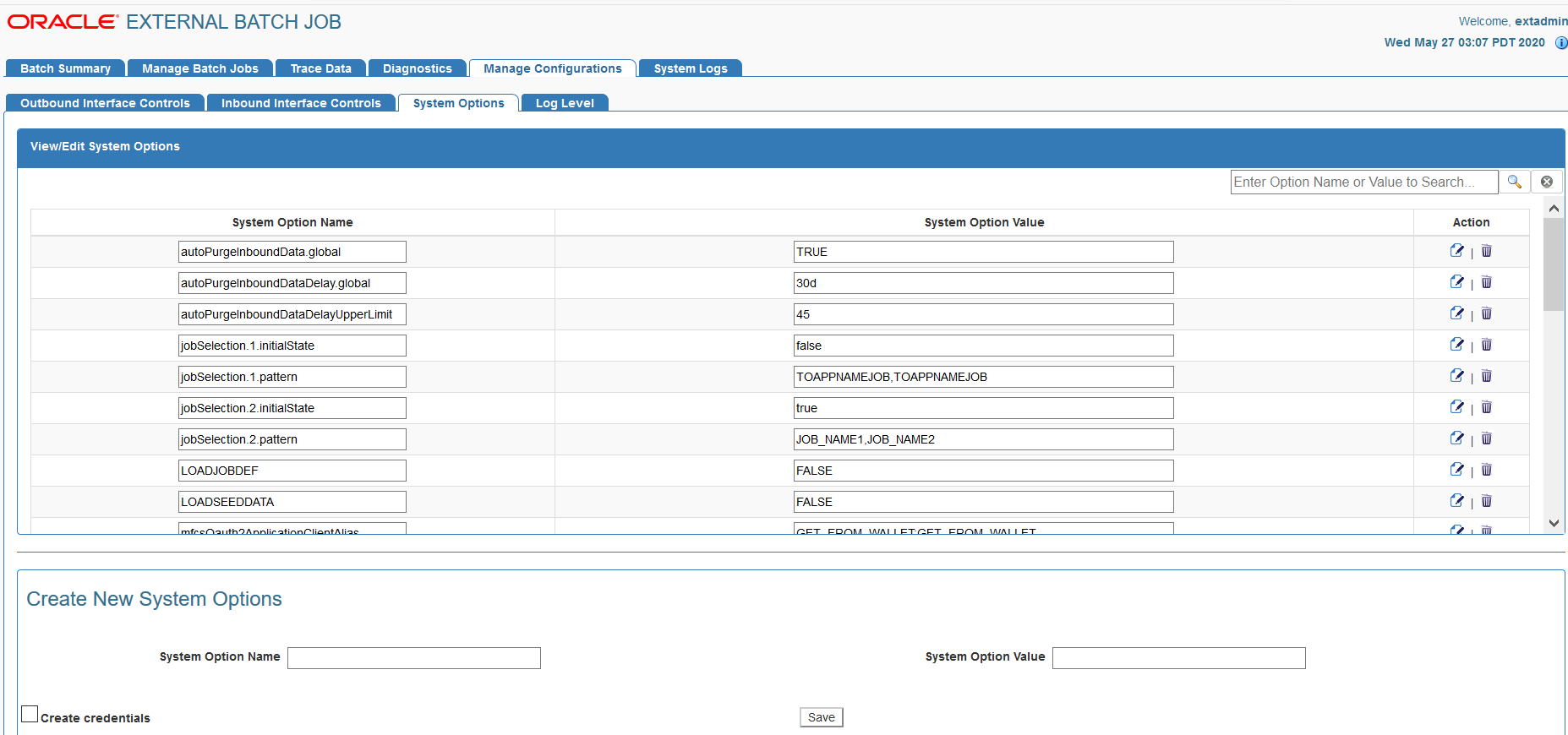

Approach 1: Update via UI
  1. Login to the job admin web page with valid credentials.
  2. Click the Manage Configurations tab.
  3. Click the System options tab.
    system options tab
  4. Search for the system option to update. Example: autoPurgeInboundData.global, autoPurgeInboundDataDelay.global, autoPurgeInboundDataDelayUpperLimit etc.
  5. Click the Edit icon to update the value and click the Save icon to save changes.
