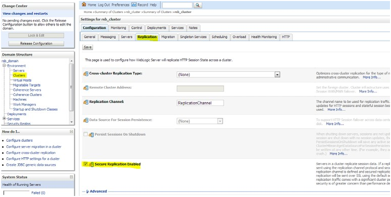

If cluster server is SSL enabled only, enable secure replication.
If secure application is not enabled and if managed server is started, managed server will move to ADMIN mode.
Enable the Secure Replication Enabled option available in Environment --> Clusters --> <cluster name> --> Configuration --> Replication.

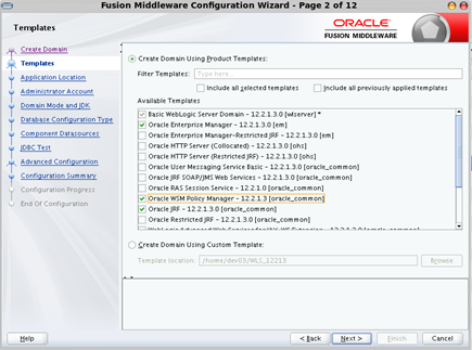

WebLogic 12.2.1.4.0, needs OWSM for Policy A and C to work. The OWSM template choice while creating the wls domian will provide an option to deploy the wsm-pm application to the admin server. This application is required for policies to work. If http ports are disabled in the server, then wsm-pm app will not be reachable , unless its configured to use SSL port. To configure SSL ports for wsm-pm, EM has to be deployed.
Perform the following procedure to configure the RIB domain:
Select the following RIB domain creation template options (check similar option in latest recommended version):

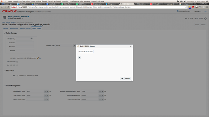

Access the enterprise Manager URL of WebLogic.
For example: https://<host>:<port>/em
From the navigation pane, expand WebLogic Domain and select the domain to be configured.
From the WebLogic Domain menu, select Web Services, then WSM Domain Configuration.
Select the Policy Access tab.
In the Policy Manager section of the page, clear the Auto Discover check box. The PM URL Edit button is enabled.
Click the PM URL Edit button.
In the Edit PM URL Values page, click the sign and enter the URL for the Administration Server, such as t3s://host:admin_port/wsm-pm.
For example, t3s://localhost:9002/wsm-pm.
Click OK to close the window.
Click Apply on the Policy Access page.

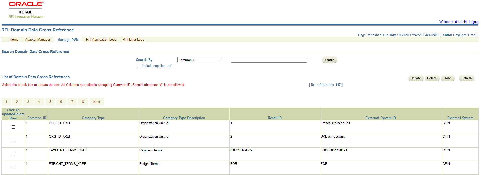

Note: The ORFI console now includes a new page "Manage DVM" for searching, viewing, creating, updating and deleting the Cross References (XREF) and DVM records setup in ORFI.![]() |
