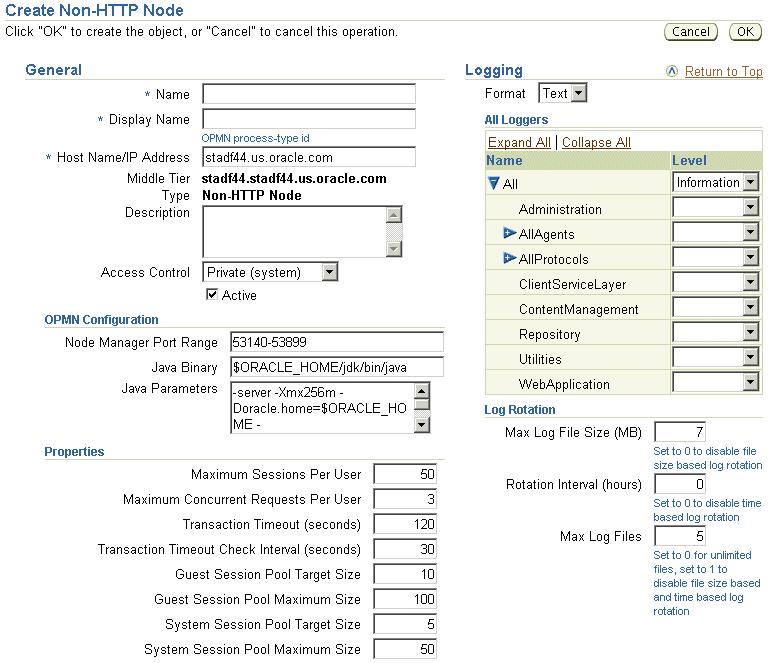

When you create an active, regular node configuration, a corresponding regular node and its OPMN process type are created automatically.
To create a regular node configuration:
If you have multiple Oracle Content DB middle tiers, connect to the Application Server Control on the middle tier where you want to add and run the node.
On the Content DB Home page, in the Administration section, click Node Configurations.
On the Node Configurations page, decide whether or not to create a new regular node configuration based on the properties of an existing node configuration.
Click Create Non-HTTP Node to create the node configuration without basing it on an existing node configuration.
Select a regular node configuration and click Create Like to base the new node configuration on an existing node configuration.
In both cases, the New Node Configuration page appears. If you selected Create Like, some properties have been filled with those of the existing node configuration.
Figure 8-1 shows the Create Non-HTTP Node page.
Provide a name for the node configuration. This name must be unique in the domain.
Provide additional node configuration properties in the General and Logging sections. See Table 8-2 for detailed information about these properties.
If you did not select Create Like, click Add in the Services section to add a default service for the node. Each node must have at least one active service.
On the Add Service page, specify:

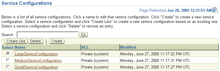

Configuration: Which service configuration object provides the configuration properties of the service.
Active: Whether the service is currently active.
Inactive services are not automatically started by the node. You must have at least one active service to add servers to this node configuration.

Click Add in the Servers section to choose default servers for the node.
On the Add Server page, specify:
Configuration: Which server configuration object provides the configuration parameters of the server. For example, select FtpServerConfiguration if you want to run an FTP server on this node.
Service: Name of the service against which the server will operate.
Initial Priority: Java thread priority of the server.
Active: Whether the server is currently active. Inactive servers are not automatically loaded by the node.
Initially Started: Whether the server is automatically started once loaded.
After you are finished specifying parameters on the Add Server page, click OK.
If you selected Create Like, you may want to edit or remove an existing server.
To change server properties, select the server and click Edit. On the Edit Server page, change the appropriate information and click OK.
If you want a particular protocol server to automatically start when the node is started, on the Edit Server page, select Initially Started.
To remove a server, select it and click Remove.
Click OK on the Create Non-HTTP Node page.

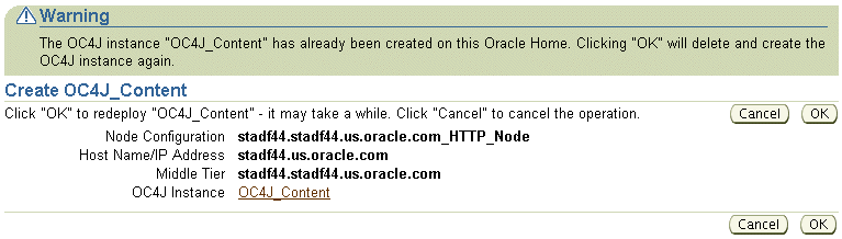

When you create an HTTP node configuration, a corresponding HTTP node and its OC4J instance are deployed automatically. Unlike regular node configurations, you do not specify configuration information when you create HTTP node configurations; the new HTTP node configuration is initially based on default settings. You can edit these default settings later.
To create an HTTP node configuration:
If you have multiple Oracle Content DB middle tiers, connect to the Application Server Control on the middle tier where you want to add and run the HTTP node.
Click Create OC4J_Content to create an HTTP node that supports the Oracle Content DB application. Click Create OC4J_RM to create an HTTP node that supports the Oracle Records DB application.
Figure 8-2 shows the Create OC4J_Content page.
Figure 8-3 shows the Create OC4J_RM page.
On the Create OC4J_Content or the Create OC4J_RM page, click OK. In rare cases, you may need to provide a name for the node, such as middle_tier_name_HTTP_Node or middle_tier_name_RM_HTTP_Node.
Optionally, start the node by selecting it from the Processes list on the Content DB Home page and clicking Start.
If you already have HTTP nodes on this middle tier, this operation removes the currently deployed OC4J_Content or OC4J_RM instance and redeploys the instance again.
You can make changes to existing node configurations, such as changing which protocol servers and agents run on a node. Changes take effect when the node is restarted.
To modify a node configuration:
On the Node Configurations page, click the name of the node configuration you want to change. You can change both HTTP nodes and regular nodes.
Change the node configuration properties, as necessary. The node configuration properties are described in Table 8-2. Some properties apply to regular nodes only.
Table 8-2 Node Configuration Properties

A service configuration holds the default values used when a service is started for an Oracle Content DB node. This section explains how to manage service configurations using the Application Server Control.
Each service configuration specifies values for service properties such as credential manager settings, the sizes of the cache and database connection pools, and the maximum number of sessions. See Appendix D, "Service Configuration Properties" for a complete list of service configuration parameters. Service configurations are uniquely named in a domain.
Whenever a new Oracle Content DB schema is created, three service configuration objects are generated:
SmallServiceConfiguration
MediumServiceConfiguration
LargeServiceConfiguration
These objects are named to reflect the sizes of their data caches.
Use the Application Server Control to create or edit service configuration objects. The services read their service configuration properties only when they start. You must stop and restart the affected nodes for changes to take effect. The changes you make this way are applied each time you start a service and overwrite any changes you make on a service while it is running.
Figure 8-5 shows the Service Configurations page.

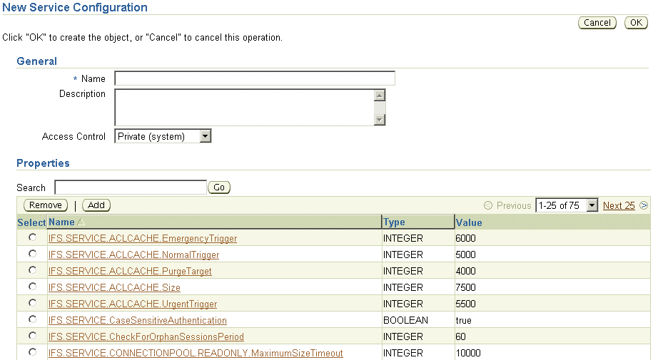

To create a new service configuration:
On the Content DB Home page, in the Administration section, click Service Configurations.
On the Service Configurations page, decide whether or not to create a new service configuration based on the properties of an existing service configuration.
Select a service configuration and click Create Like to base the new service configuration on an existing service configuration (highly recommended).
Click Create to create the service configuration without basing it on an existing configuration.
In both cases, the New Service Configuration page appears. If you clicked Create Like, the service configuration properties have been filled with those of the existing service.
Figure 8-6 shows the New Service Configuration page.
Figure 8-6 New Service Configuration Page
In the General section, enter a name for the new service configuration.
Enter a description of the service.
Assign an access level to the configuration by selecting from the Access Control list.
Add, remove, or update the properties of the new service.
Click OK.

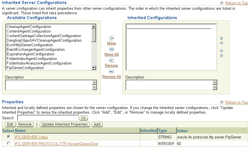

When you create a new server configuration, you can let it inherit the properties from one or more server configurations. You can use the same values as inherited, or use different values.
Inheritance operations are accessed from the New Server Configuration page, shown in Figure 8-7. See "Creating Server Configurations" for more information on creating new server configurations.
Figure 8-7 Inheritance Operations on the New Server Configuration Page
To change the value of an inherited property, create a new property in the inherited server configuration that is identical in name to the one in the parent server configuration, but has values that override those in the parent server configuration.
View the inherited properties to determine whether the property in the current server configuration object is local to this object or taken from a parent server configuration object. You can also differentiate between inherited server configuration objects and those that are local to the server configuration.
Use the Application Server Control to create new server configurations.
To create a new server configuration:
On the Content DB Home page, in the Administration section, click Server Configurations.
On the Server Configurations page, decide whether or not to create a new server configuration based on the properties of an existing server.
Select a server configuration and click Create Like to base the new server configuration on an existing configuration.
Click Create to create the server configuration without basing it on an existing configuration.
In both cases, the New Server Configuration page appears. If you clicked Create Like, the server configuration properties have been filled with those of the existing server.
On the New Server Configuration page, in the General section, enter a name for the new server configuration.
Enter a description of the server.
Keep the default value for Access Control.
Select Abstract to prevent this server from being instantiated. An abstract server configuration is used to set base values for properties, which can then be inherited by another server configuration. You cannot start a server from an abstract server configuration.
In the Inherited Server Configurations section, select the existing configurations from which the new configuration will inherit properties. Select configurations from the Available Configurations list and move them to the Selected Configurations list.
If you change the list of inherited server configurations, click Update Inherited Properties in the Properties section to display the properties of the inherited server configurations.
The order of the items in the Inherited Configurations list determines which configuration takes precedence.
