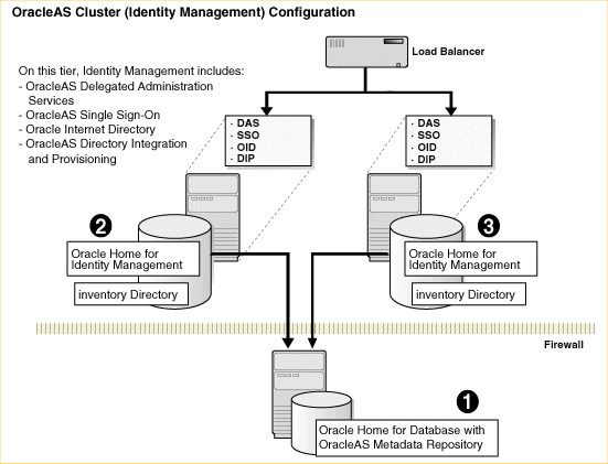

9.5 Installing an OracleAS Cluster (Identity Management) Configuration
In this configuration, you need an existing database that is already running in a configuration supported by the OracleAS RepCA. Oracle recommends running the database in a high availability environment, such as a Real Application Clusters database. You also need additional nodes (at least two nodes) to run Oracle Identity Management components. In this configuration, Oracle Internet Directory, OracleAS Single Sign-On, and Oracle Delegated Administration Services run on each node. If you want to distribute these components, see Section 9.6, "Installing a Distributed OracleAS Cluster (Identity Management) Configuration".
These nodes are accessed through a load balancer. See Figure 9-1.
You install the OracleAS Metadata Repository in your existing database, then install Oracle Identity Management components against this database.

9.5.1 Installation Order
To create an OracleAS Cluster (Identity Management) configuration:
  1. Install the OracleAS Metadata Repository in your existing database.
  2. Install the Oracle Identity Management on each node. You run the installer on each node separately.
    If you want to configure Oracle Internet Directory to listen on SSL ports only, perform this configuration after you have installed Oracle Identity Management. Oracle Internet Directory needs to be listening on both SSL and non-SSL ports when you install OracleAS Single Sign-On and Oracle Delegated Administration Services.
  3. Install middle tiers.

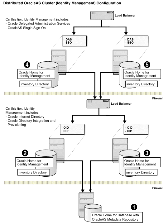

9.6 Installing a Distributed OracleAS Cluster (Identity Management) Configuration
In this configuration, you need an existing database that is already running in a configuration that is supported by OracleAS RepCA. Oracle recommends running the database in a high availability environment, such as a Real Application Clusters database. This database will contain the OracleAS Metadata Repository.
You also need two nodes to run OracleAS Single Sign-On and Oracle Delegated Administration Services components, and two additional nodes to run Oracle Internet Directory. These nodes are accessed through load balancers. See Figure 9-2.
Oracle Directory Integration Platform Is Started on the First Node Only
The installer starts Oracle Directory Integration Platform only on the first node, even though you selected it on subsequent nodes as well. On subsequent nodes, the installer configures Oracle Directory Integration Platform, but does not start it.
If You Want Oracle Internet Directory to Listen on SSL Ports Only
If you want Oracle Internet Directory to listen on SSL ports only, perform this configuration after you have installed OracleAS Single Sign-On and Oracle Delegated Administration Services. You need Oracle Internet Directory to be listening on both SSL and non-SSL ports when you install OracleAS Single Sign-On and Oracle Delegated Administration Services.
Figure 9-2 Distributed OracleAS Cluster (Identity Management) Configuration
Description of Figure 9-2 follows
Description of "Figure 9-2 Distributed OracleAS Cluster (Identity Management) Configuration"

9.6.1 Installation Order
To create a distributed OracleAS Cluster (Identity Management) configuration:
  1. Install OracleAS Metadata Repository in your existing database.
  2. Install Oracle Internet Directory on each node. You run the installer on each node separately.
    If you want to configure Oracle Internet Directory to listen on SSL ports only, perform this configuration after you have installed OracleAS Single Sign-On and Oracle Delegated Administration Services. Oracle Internet Directory needs to be listening on both SSL and non-SSL ports when you install OracleAS Single Sign-On and Oracle Delegated Administration Services.
  3. Install OracleAS Single Sign-On and Oracle Delegated Administration Services on each node. You run the installer on each node separately.
  4. Install middle tiers.

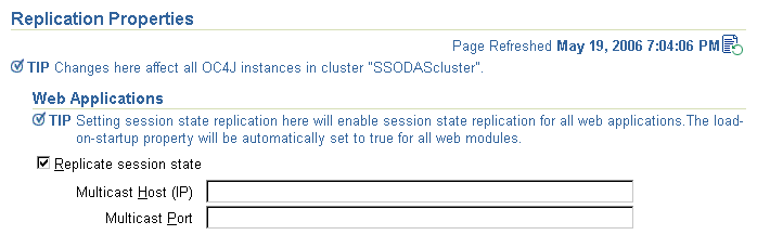

9.7.1 Cluster the OC4J_Security Instance for State Replication (First Oracle Delegated Administration Services node only)
To ensure that Oracle Application Server maintains the state of stateful Web applications across DCM-Managed OracleAS Cluster, you need to configure state replication for the Web applications. Configure state replication only on the first node where Oracle Delegated Administration Services is installed.
To configure state replication for the OC4J_Security instance, do the following:
  1. Using the Application Server Control Console, navigate to the Application Server Home page for the instance that contains Oracle Delegated Administration Services.
  2. Select the OC4J_SECURITY link on the Application Server Home page.
  3. Select the Administration link on the OC4J Home Page.
  4. Select the Replication Properties link in the Instance Properties area.
  5. Scroll down to the Web Applications section. Figure 9-3 shows this section.
    Figure 9-3 Web State Replication Configuration
    Description of Figure 9-3 follows
    Description of "Figure 9-3 Web State Replication Configuration"
  6. Select the Replicate session state checkbox.
    Optionally, you can provide the multicast host IP address and port number. If you do not provide the host and port for the multicast address, it defaults to host IP address 230.230.0.1 and port number 9127. The host IP address must be between 224.0.0.2 through 239.255.255.255. Do not use the same multicast address for both HTTP and EJB multicast addresses.
    When choosing a multicast address, ensure that the address does not collide with the addresses listed in:
    http://www.iana.org/assignments/multicast-addresses
    Also, if the low order 23 bits of an address is the same as the local network control block, 224.0.0.0 – 224.0.0.255, then a collision may occur. To avoid this problem, provide an address that does not have the same bits in the lower 23 bits of the address as the addresses in this range.
