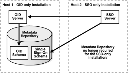

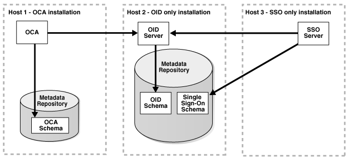

In addition, your OracleAS Identity Management configuration can be distributed or non-distributed. Consider the following examples of distributed OracleAS Identity Management installations:
Figure 7-1 Distributed Identity Management - Example 1
Description of Figure 7-1 follows
Description of "Figure 7-1 Distributed Identity Management - Example 1"
Figure 7-2 Distributed Identity Management - Example 2
Description of Figure 7-2 follows
Description of "Figure 7-2 Distributed Identity Management - Example 2"

7.5.3 Upgrading Distributed OracleAS Identity Management Configurations
The following sections describe how to upgrade a distributed OracleAS Identity Management configuration:
7.5.3.1 Upgrading a Distributed OracleAS Identity Management Configuration
A distributed OracleAS Identity Management configuration consists of multiple Oracle homes. One of the Oracle homes contains the Oracle Internet Directory.
In a distributed OracleAS Identity Management installation, the other Oracle homes contain additional OracleAS Identity Management components, such as OracleAS Single Sign-On, Delegated Administration Services, Oracle Directory Integration and Provisioning, and OracleAS Certificate Authority.
To upgrade a distributed OracleAS Identity Management configuration (as shown in Figure 7-1), do the following:
  1. Review Section 7.5.3.2, "Verifying Whether OracleAS Identity Management Components are Enabled or Disabled" to determine exactly which OracleAS Identity Management components will be upgraded.
  2. Synchronize the system clocks on all nodes where the OracleAS Identity Management components reside so they are running within 250 seconds of each other.
    When synchronizing the system clocks, make sure the clocks are set to the same time zone.
  3. Upgrade the Oracle home that includes the Oracle Internet Directory used by the other OracleAS Identity Management components.
    You must upgrade the Oracle Internet Directory first before upgrading the other distributed OracleAS Identity Management components.
    To upgrade the Oracle Internet Directory Oracle home, use one of the following procedures, depending upon the type of installation used for the Oracle Internet Directory Oracle home:
    If you are running only Oracle Internet Directory from the Oracle home, check to be sure the other OracleAS Identity Management components are disabled so they will not be upgraded or started in the destination 10g (10.1.4.0.1) Oracle home.
    For more information, see Section 7.5.3.2, "Verifying Whether OracleAS Identity Management Components are Enabled or Disabled".
  4. Make sure that the OracleAS Metadata Repository database and database listener used by the distributed components are up and running.

7.5.3.2 Verifying Whether OracleAS Identity Management Components are Enabled or Disabled
When you upgrade a distributed OracleAS Identity Management configuration, the 10g (10.1.4.0.1) installer will upgrade any OracleAS Identity Management components that are enabled in the source Oracle home.
An OracleAS Identity Management component is considered enabled when it is marked as such in the following configuration file in the source Oracle home:
SOURCE_ORACLE_HOME/config/ias.properties
Before you upgrade your Oracle Internet Directory installation in a distributed OracleAS Identity Management configuration, you can check the contents of this file to verify which components are enabled. If necessary, modify the entries to reflect exactly which components you have enabled, and as a result, which components will be upgraded.
If you are running only Oracle Internet Directory in the Oracle home, the ias.properties file should contain the following entries:
SSO.LaunchSuccess=False
OID.LaunchSuccess=True
DAS.LaunchSuccess=False
DIP.LaunchSuccess=False
OCA.LaunchSuccess=False
On the other hand, if you are running OracleAS Single Sign-On, Oracle Delegated Administration Services, and Oracle Directory Integration and Provisioning in one Oracle home, but using Oracle Internet Directory in another Oracle home, the entries would appear as follows:
SSO.LaunchSuccess=True
OID.LaunchSuccess=False
DAS.LaunchSuccess=True
DIP.LaunchSuccess=True
