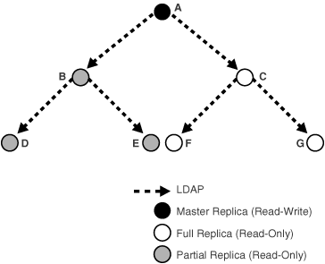

8.1.1 Fan-Out Replication (LDAP Replication)
In fan-out replication, one Oracle Internet Directory is the master, and the other Oracle Internet Directory instances are called the Oracle Internet Directory replicas.
Clients modify the data in the master Oracle Internet Directory only. The master then propagates the changes to the replicas. These replicas, in turn, can update other Oracle Internet Directory replicas.
Figure 8-1 Example of Fan-Out Replication (LDAP Replication)
Description of Figure 8-1 follows
Description of "Figure 8-1 Example of Fan-Out Replication (LDAP Replication)"
In fan-out replication, Oracle Internet Directory instances use the LDAP protocol to communicate with each other. The Select Oracle Internet Directory Replication Mode screen in the installer uses the term LDAP Replication to refer to fan-out replication.
