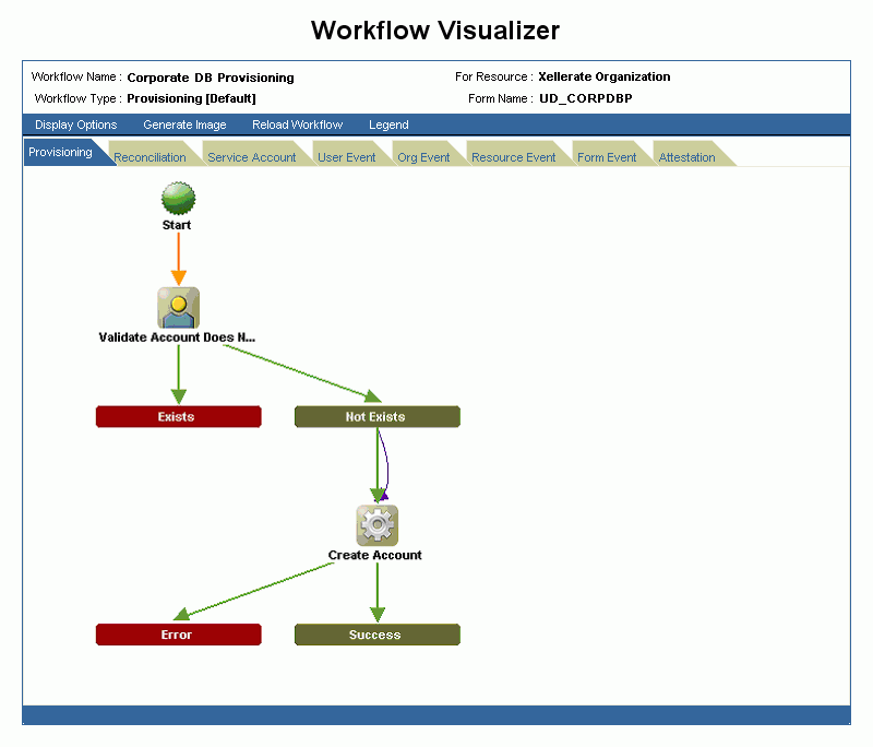

For example, suppose that the Corporate DB Provisioning workflow definition is shown. Selecting an event tab displays the appropriate sequence of tasks for that event. These event tabs are discussed in the "Using the Provisioning Workflow Definition Event Tabs".
Figure 12-1 Using the Workflow Visualizer
Description of Figure 12-1 follows
Description of "Figure 12-1 Using the Workflow Visualizer"

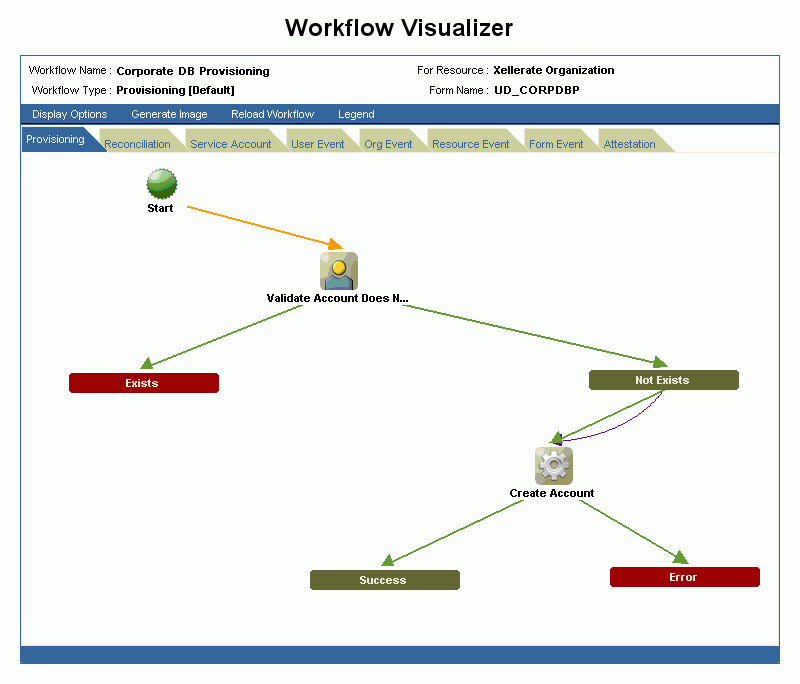

Using Drag and Drop
You can rearrange the graphical workflow by dragging and dropping the icons that make up the workflow definition to any location in the workflow view. As you move an icon component, the direction arrow continues to associate the link.
Figure 12-2 Using Drag and Drop in the Workflow Visualizer
Description of Figure 12-2 follows
Description of "Figure 12-2 Using Drag and Drop in the Workflow Visualizer"

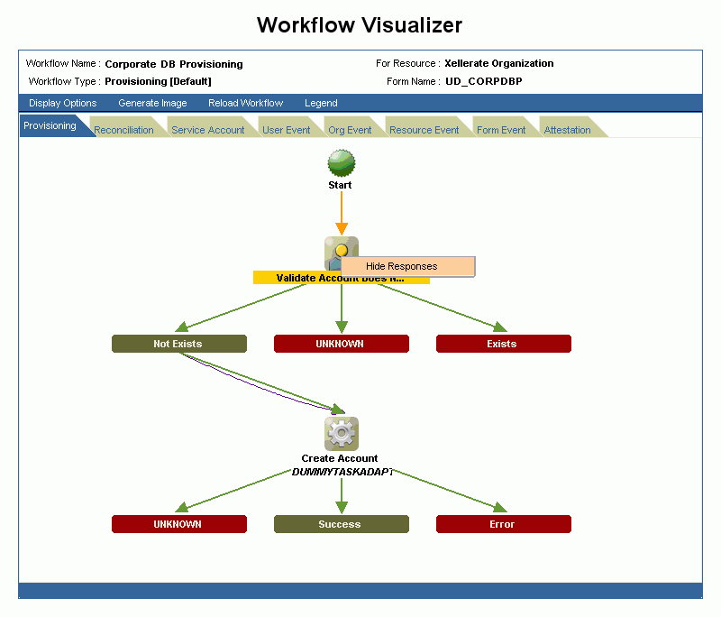

Using the Task Node (right-click menu)
When you right click the task node, the Hide Responses option appears. When you click this option the response sub-tree collapses and is replaced with an expansion node. The task node label is highlighted in yellow to denote that it was collapsed. If the node is collapsed, the Hide Responses action option does not appear.
Figure 12-3 Using the Task Node (Right-Click Menu)
Description of Figure 12-3 follows
Description of "Figure 12-3 Using the Task Node (Right-Click Menu)"

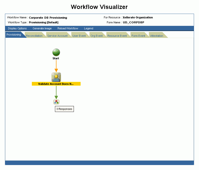

Using the Expansion Nodes (Response Sub-Tree)
Task Nodes with more than five response codes, not including the Unknown Response code, are not be drawn with their responses in the flowchart. Instead, an expansion node replaces the entire response sub-tree. When you double-click the expansion node, the flowchart is redrawn to display the response sub-tree for the parent task (node). The label of the task node is highlighted in yellow.
Figure 12-4 Collapsed Response Subtree in the Workflow Visualizer
Description of Figure 12-4 follows
Description of "Figure 12-4 Collapsed Response Subtree in the Workflow Visualizer"
When you place your cursor over the expansion node, it indicates how many response codes are associated with it. Unknown Response Codes are hidden by default.

The Provisioning Workflow Definition is displayed with associated event tabs of the logical flow. The event tabs represent the various task sequences for a specific event in the workflow definition. By clicking an event tab, the tab displays the appropriate tasks for the workflow event of the process. You can arrange the flowchart to your desired view. If there is no task defined for the workflow event, the tab displays a blank view. If there is more than one task sequence for the workflow event type, the tab displays a pull-down menu where you can select the process flowchart that you want to view.
Provisioning Tab
The Provisioning tab shows the task that will provision a resource. When the process type is Provisioning, the process flowchart shows all task needed to provision a resource.
Reconciliation Tab
The Reconciliation tab shows the reconciliation event for the provisioning process with marker tasks inserted into it – either Reconciliation Insert Received or Reconciliation Update Received. These tasks can have adapters attached to them to initiate a provisioning action. If no adapters are attached to it, a response code of Event Processed is assigned to that task. Additional provisioning process tasks can be generated based on this response code to initiate a provisioning flow due to the reconciliation event.
Service Account Tab
The Service Account tab shows all the provisioning processes of service accounts for users (administrators). When a user is provisioned with a service account, Oracle Identity Manager manages a mapping from the user's identity to the service account. When the resource is revoked or the user is deleted, the provisioning process for the service account is not cancelled. Instead, a task is inserted into the provisioning process to removes the mapping from the user to the service account. The provisioning processes of service account are: Service Account Changed, Service Account Alert, and Service Account Moved.
User Event Tab
The User Event tab shows the workflows that respond to changes to a user record, for example, updating the password or user ID.
Org Event Tab
The Org Event tab shows workflows that respond to changes to an organization record, for example, updating the name, the parent name, or the key of the organization the resource is provisioned to or the organization of the user that the resource is provisioned to.
Resource Event Tab
The Resource Event tab shows workflows that respond to state changes of the provisioned resource instance, for example, being enabled or disabled.
Form Event Tab
The Form Event tab shows workflows that respond to data changes in the Process Form of the provisioned resource instance.
Attestation Tab
The Attestation Event tab shows the workflows that respond to data changes in an attestation process.
