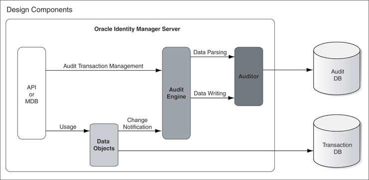

Figure 1-1 shows the design components of the Oracle Identity Manager auditing process.
Figure 1-1 Design Components of the Auditing Process
Any action that a user takes in Oracle Identity Manager translates into an application programming interface (API) call or into an MDB picking up a message to process an action.One action can cause multiple changes. All changes are combined into an audit transaction. Each API method that can modify data objects calls the startTransaction method in the audit engine at the beginning of the API and the endTransaction method at the end of the method call. This defines boundaries for the audit transaction. The audit engine generates a transaction ID to identify the changes made in the transaction.
Oracle Identity Manager provides auditing and historical archiving of a user profile. It takes a snapshot of a user profile, stores the snapshot in an audit table in the database, and updates the snapshot each time the user data changes.
