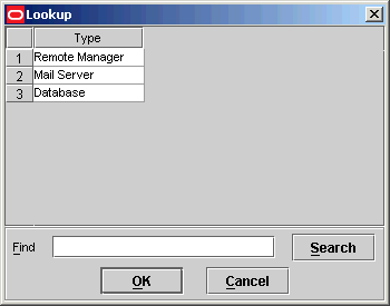

A lookup field enables you to search for a value. The following procedure describes how to use lookup fields.
To use lookup fields:
If the Lookup dialog box contains a short list of fields, click a field, then click OK.
Alternatively, you can select the field and press the F4 key.
Click Cancel to close the Lookup window without selecting anything.
Figure 4-1 displays the Lookup dialog box.
If the Lookup dialog box contains a long list of values, enter the first few characters of the value you want in the Find box, followed by a wildcard (*), then click the Search button.
The Lookup dialog box displays the results that match your search.

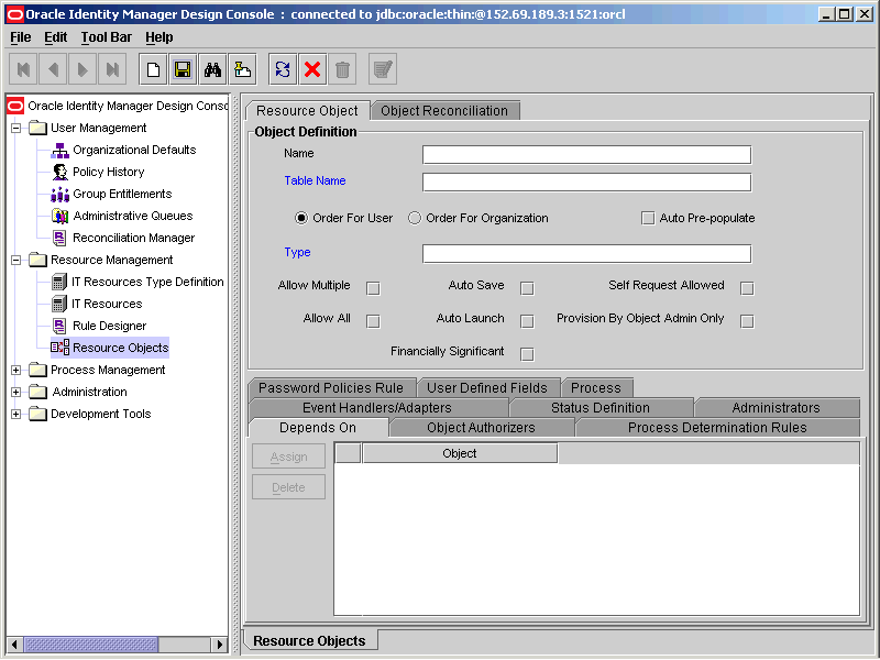

Most Oracle Identity Manager forms contain multiple tabs. The tabs are usually located in the lower region of the form. The tabs display additional information about a record, for example, the users who are employed at an organization, as shown in Figure 4-2.
Figure 4-2 Oracle Identity Manager Design Console - Tab on Forms
Each tab has its own tables and function buttons. Usually, the buttons on a tab are not enabled until the information in the upper portion of the form is saved. The table displayed in the tab enables you to view and edit the records associated with that tab item.
To modify information in a row of a tab's table, either double-click the field that contains the information you want to edit, or double-click the associated row header.

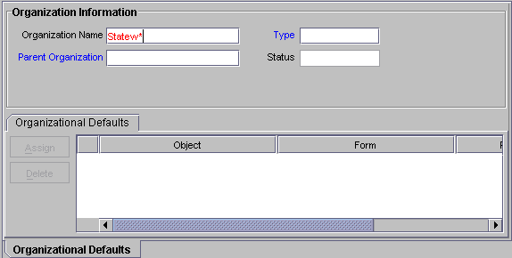

You can filter the search criteria in a form field. This limits the results that are returned to only the records that match the criteria you entered. If you leave all form fields blank prior to conducting the search, all records in the table are returned.
You can use a wildcard in a search. The asterisk (*) wildcard character represents unspecified portions of search criteria. You can use a wildcard at the beginning, middle, or end of the value that you enter in a field. For example, if you enter B* in the Location field of an Oracle Identity Manager form and execute a search, you retrieve all records with locations that begin with the letter B (for example, Burbank, Boston, Bristol, and so on). If the * character is placed in the middle of a search value, as in Br*on, you retrieve all records that begin with BR and end with ON (for example, Brighton, Boston, and so on) If you place the * character at the end of the search value, as in *A, you retrieve all records that end in A (for example, Philadelphia, Tampa, and so on).

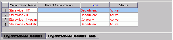

In Figure 4-3, a query is performed on the Organizational Defaults form and the Organization Name field is used to filter the search criteria. The filter Statew*; ensures that only organizations with names that begin with Statew are retrieved.
Figure 4-3 Displaying the Results of a Search Query

More than one record is returned. Multiple records in the database match your search criteria. A Table view appears, listing all records that meet your search criteria. The first record in the retrieved set of records appears in the Form view, as shown in Figure 4-4.

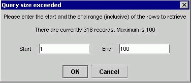

If you have both read- and write-access to all forms and records in Oracle Identity Manager in the System Configuration form (that is, you are a System Administrator), this enables you to set the maximum number of records that may appear in the result set for a search. If the set of records retrieved for a search exceeds this value, Oracle Identity Manager displays the Query Size Exceeded dialog box, as shown in Figure 4-5.
Figure 4-5 The Query Size Exceeded Dialog Box
You are prompted to enter a specific range or subset of the result set to be viewed. In Figure 4-5, the maximum result set of 100 has been exceeded. The dialog enables you to display only records 1 through 100.
