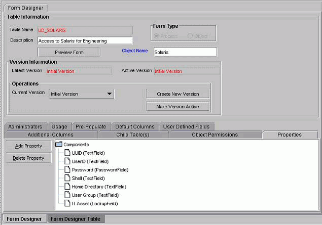

The Adapter Manager form is located in the Development Tools folder. It is used to compile multiple adapters simultaneously, as shown in Figure 9-2.
The information required to provision resources to a target user or organization cannot always be retrieved from an existing Oracle Identity Manager form. You can use the Form Designer form in the Development Tools folder to create a form with fields that contain the relevant information. After creating the form, you assign it to the process or resource object that is associated with provisioning resources to the user or organization. Figure 9-3 displays the Form Designer Form.
The following are reasons, listed in order of importance, why Oracle Identity Manager displays a resource object or process form that a user creates using the Form Designer form:
If the resource object form is attached to a resource object that is requested, and the Launch Object Form menu command is selected by right-clicking the resource object from the Process Console tab of the Requests form.
When the resource object form is attached to a resource object that is direct provisioned.
If the process form is attached to the standard approval process, and the Launch Form menu command is selected by right-clicking the process from the Process Console tab of the Requests form.
When the process form is attached to the appropriate provisioning process, and the Launch Form menu command is selected by right-clicking the process from the Object Process Console tab of the Organizations or Users forms.
For example, when Oracle Identity Manager or one of its users attempts to complete the resource object or process, the assigned form is triggered. When this occurs, either Oracle Identity Manager or a user populates the fields of this form. After the data is saved, the corresponding process or resource object can achieve a status of Completed, and Oracle Identity Manager can provision the appropriate resources to the target organizations or users.
For example, the Solaris form (represented by the UD_SOLARIS name in the Table Name field) has been created and assigned to both the Solaris resource object and provisioning process.
Note: The table name contains a UD_ prefix, followed by the form name. So, for this example, since the name of the form is SOLARIS, its table name is UD_SOLARIS. |
The following table describes the data fields of the Form Designer form
| Field Name | Description |
| Table Name | The name of the database table that is associated with the form.
Note: The table name contains the UD_ prefix, followed by the form name. So, if the name of the form were SOLARIS, its table name would be UD_SOLARIS. |
| Description | Explanatory information about the form.
Important: The text that appears in the Description field is the name of the form. |
| Preview Form | When you click this button, the form appears. This way, you can see how it looks and functions before you make it active. |
| Form Type | These radio buttons are used to designate whether the form is to be assigned to a process or a resource object.
If you select the Process radio button, then the form is associated with an approval or provisioning process. By selecting the Object radio button, the form is to be assigned to a resource object. |
| Object Name | This is the name of the resource that can be provisioned (for example, a database, server, software application, file, or directory access). Also, referred to as a resource object name.
Double-click in this field to see the available resource object names. |
| Latest Version | The most recent version of the form. |
| Active Version | The version of the form that is used with the designated process or resource object.
Note: Once a version of the form appears in the Active Version field, it cannot be modified. |
| Current Version | This version of the form is the one being viewed and has information, which appears throughout the various tabs of the Form Designer form. |
| Create New Version | If you click this button, you can assign an additional name to the existing version of a form. As a result, you can modify this version, without impacting the original version of the form.
Note: If you create a new version of the form and click Refresh, the name that you provided for this version appears in the Current Version box. |
| Make Version Active | By clicking this button, you can specify that the current version of the form is be the one that is to be assigned to the process or resource object. In other words, this version is now active.
Note: Once a version of the form is active, it cannot be modified. Instead, you must construct an additional version of the form (by clicking the Create New Version button). |
The following section describes how to create a form.
The following procedure describes how to create a form.
To create a form:
Open the Form Designer form.
In the Table Name field, type the name of the database table that is associated with the form.
Note: The table name contains the UD_ prefix followed by the form name. So, if the name of the form were SOLARIS, its table name would be UD_SOLARIS. |
In the Description field, enter explanatory information about the form.
If the form is assigned to an approval or provisioning process, select the Process radio button.
If the form is to be assigned to a resource object, select the Object radio button.
Click Save.
The form is created. The words Initial Version appear in the Latest Version field. This signifies that you can populate the tabs of the Form Designer form with information, so the form is functional with its assigned process or resource.
Once you launch the Form Designer form, and create a form, the tabs of this form become functional. The Form Designer form contains the following tabs:
Each of these tabs is described in the following sections.

Figure 9-7 displays the Properties Tab of the Form Designer Form. You use this tab to assign properties and property values to the data fields that appear on the form that is created through the Form Designer form.
Figure 9-7 The Properties Tab of the Form Designer Form
Note: The table name contains the UD_ prefix, followed by the form name. So, for this example, since the name of the form is Solaris, its table name is UD_SOLARIS.This tab will be populated with information only after you click the Make Version Active button, and attach the form to a resource object or provisioning process. |
