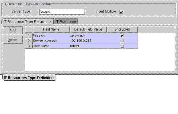

The IT Resources Type Definition form is in the Resource Management folder. You use the IT Resources Type Definition form to classify IT resource types, for example, AD, MS Exchange, Solaris. Oracle Identity Manager associates resource types with resource objects that it provisions to users and organizations.
After you define an IT resource type on this form, it becomes available for selection when you define a resource. The type appears in the Type field on the IT Resources form.
IT resource types serve as templates for the IT resource definitions that reference them. If an IT resource definition references an IT resource type, the resource inherits all of the parameters and values in the IT resource type. The IT resource type serves as the general IT classification, for example, Solaris. The resource is an instance of the type, for example, Solaris for Statewide Investments. You must associate every IT resource definition with an IT resource type.
The IT Resources Type Definition form is shown in Figure 6-1.

The following procedure describes how to define an IT resource type.
To define an IT resource type:
Enter the name of the IT resource type in the Server Type field, for example, Solaris.
To make the IT resource type available for multiple IT resources, check the Insert Multiple checkbox.
Click Save.
The IT resource type is defined. You can select it from the Type field when defining IT resources in the IT Resources form.

You use the IT Resource Type Parameter tab to specify default values and encryption settings for all connection parameters for the IT resource type, as shown in Figure 6-1. Parameters and values on this tab are inherited by all IT resources that reference this IT resource type.
When you define a new parameter, the parameter and its values and encryption settings are added to the current IT resource type and to any new or existing IT resource definitions that reference this IT resource type. For any applicable resource definition, the new parameter appears in the Parameters tab of the IT Resources form.
Note: You can customize the values and encryption settings for these parameters within each IT resource. |
Adding a Parameter to an IT Resource Type
The following procedure describes how to add a parameter to an IT Resource Type.
To add a parameter to an IT Resource Type:
Click Add.
A new row appears in the IT Resource Type Parameter tab.
In the Field Name field, enter the name of the parameter.
In the Default Field Value field, enter a default value.
This value is inherited by all IT resources that reference this IT resource type
Select or clear the Encrypted checkbox.
This checkbox determines if this parameter's value is be masked, that is, represented with **** symbols, in a form field.
If you want the parameter's value to be masked, select this checkbox.
Click Save.

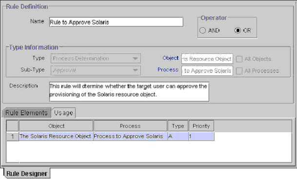

The Rule Designer form shown in Figure 6-2 is located in the Resource Management folder. You use this form to create and manage rules that are used with resources.
There are four types of rules:
General: Enables Oracle Identity Manager to add a user to a user group automatically and to determine the password policy that is assigned to a resource object.
Process Determination: Determines the approval process for a request, and the approval and provisioning processes for a resource object.
Task Assignment: Specifies the user or user group that is assigned to a process task.
Prepopulate: Determines what prepopulate adapter is executed for a form field.
A rule contains the following items:
A rule element: Consists of an attribute, an operator, and a value. In Figure 6-2, the attribute is User Login, the operator is ==, and the value is XELSYSADM.
A nested rule: If one rule must be placed inside another rule for logic purposes, the internal rule is known as a nested rule. In Figure 6-2, a Rule to Prevent Solaris Access is nested in a Rule for Solaris.
An operation: When a rule contains multiple rule elements or nested rules, an operation shows the relationship among the components. In Figure 6-2, if the AND operation is selected, the User Login==XELSYSADM rule element and the Rule to Prevent Solaris Access nested rule must both be true for the rule to be successful.

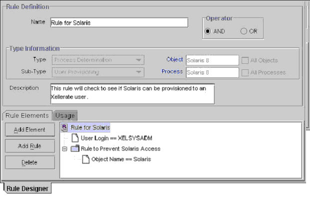

From this tab, you can create and manage elements and nested rules for a rule. For example, in Figure 6-3, the Rule for Solaris contains the User Login==XELSYSADM rule element. It also has a nested Rule to Prevent Solaris Access. Figure 6-3 displays the Rule Elements tab of the Rule Designer form.
Figure 6-3 The Rule Elements Tab of the Rule Designer Form
The rule in Figure 6-3 can be applied to a provisioning process for the Solaris resource object. After this resource object is assigned to a request, the rule is triggered. If the target user's login is XELSYSADM, and the name of the resource object is Solaris, the Solaris resource object is provisioned to the user. Otherwise, the user will not be able to access Solaris.

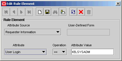

Click Add Element.
The Edit Rule Element dialog box appears.
The custom menus in the boxes on the Edit Rule Element dialog box reflect the items in the Type and Sub-Type boxes of the Rule Designer form.
The following table describes the data fields in the Edit Rule Element dialog box.
| Name | Description |
| Attribute Source | From this box, select the source of the attribute. For example, if the attribute you wish to select is Object Name, the attribute source to select would be Object Information. |
| User-Defined Form | This field displays the user-created form that is associated with the attribute source that appears in the adjacent box.
Note: If Object Data or Process Data do not appear in the Attribute Source box, the User-Defined Form field will be empty. |
| Attribute | From this box, select the attribute for the rule. |

Set the parameters for the rule you are creating, as shown in Figure 6-4.
Figure 6-4 Edit Rule Element Window -- Filled
In this example, if the Login ID of the target user is XELSYSADM, the rule element is true. Otherwise, it is false.
From the Toolbar of the Edit Rule Element dialog box, click Save, then click Close.
The rule element appears in the Rule Elements tab of the Rule Designer form.
From the main screen's toolbar, click Save.
The rule element is added to the rule.
Adding a Nested Rule to a Rule
The following procedure describes how to nest a rule within a rule.
Caution: In the following procedure only rules of the same type and sub-type as the parent rule appears in the Select Rule window. |
To add a nested rule:
Click Add Rule.
The Select Rule dialog box appears.
Select the desired nested rule and click Save.
Click Close.
The nested rule appears in the Rule Elements tab of the Rule Designer form.
From the main screen's Toolbar, click Save.
The nested rule is added to the rule.

This tab appears on the Rule Designer form. The information in the Usage tab reflects the rule's classification type. For example, if a rule type is Pre-Populate, the user-created field that this rule is applied to appears in this tab.
Figure 6-5 illustrates the Usage tab.
Figure 6-5 Usage Tab of the Rule Designer Form
This tab displays the following items:
The password policy, resource object, process, process task, auto-group membership criteria, user group, Oracle Identity Manager form field, and pre-populate adapter associated with a rule.
A one-letter code, signifying the rule's classification type (A=Approval, P=Provisioning).
This code appears for process determination rules only.
The rule's priority number.
In Figure 6-5, the Rule to Approve Solaris has been assigned to the Solaris Resource Object and the Process to Approve Solaris. Since this is an approval rule, its classification type is A. The priority of this rule is 1, indicating that it was the first approval rule that Oracle Identity Manager was scheduled to evaluate, once the corresponding resource object was assigned to a request.

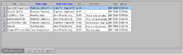

The Rule Designer Table, as shown in Figure 6-6, displays all available rules defined in the Rule Designer form.
The Rule Designer Table displays the following information:
| Field Name | Description |
| Rule Name | The name of the rule. |
| Rule Type | A rule can belong to one of four types:
| Rule Sub-Type | A rule of type Process Determination, Task Assignment, or Pre-Populate can be categorized into one of four sub-types:
| Rule Operator | The relationship between the attribute and the attribute value (== or !=) |
| Description | Explanatory information about the rule. |
| Last Updated | The date when the rule was last updated. |

If a resource object is of type Application, and you want to provision the resource object to a user or organization, you may want that user or organization to meet password criteria before accessing the resource object. This password criteria is created and managed in the form of password policies. These policies are created using the Password Policies form.
As the resource object definition is only a template for governing how a resource is to be provisioned, Oracle Identity Manager must be able to make determinations about how to provision the resource based on actual conditions and rules. These conditions may not be known until the resource is actually requested. Therefore, rules must be linked to the various processes and password policies associated with a resource to allow Oracle Identity Manager to decide which ones to invoke in any given context.
Oracle Identity Manager determines which password policy to apply to the resource when creating or updating a particular user's account by evaluating the password policy rules of the resource and applying the criteria of the policy associated with the first rule that is satisfied. Each rule has a priority number, which indicates the order in which Oracle Identity Manager will evaluate it.
For this example, Oracle Identity Manager will trigger the Rule to Prevent Solaris Access rule (since it has the highest priority). If this rule were TRUE, Oracle Identity Manager would apply the criteria of the Restrict Solaris password policy to the password of the account being created or updated.
If the rule is false, Oracle Identity Manager will evaluate the rule using the next highest priority. If this rule is true, Oracle Identity Manager applies the password policy associated with it to the password of the account being created or updated.
Now that we have reviewed about password policy rules, you will learn how to add a password policy rule to a resource object. In addition, when an existing rule is no longer valid, you will learn how to remove it from the resource object.
