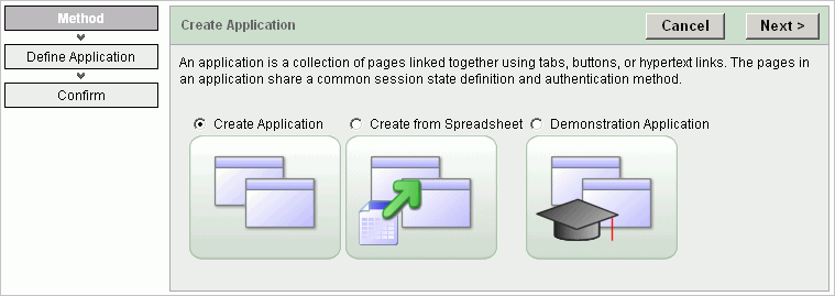

  4. For Method, accept the default, Create Application, and click Next.

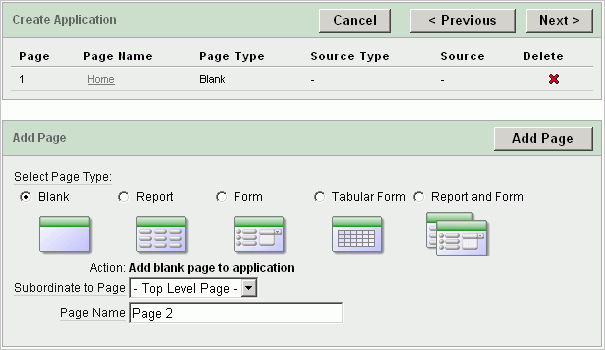

  6. For Pages, specify the following in the Add Page section:
    1. Select Page Type - Accept the default, Blank.
      Tip:
      Explanatory information for each option appears on the right side of the page. This page-level help appears throughout the application.
    2. Page Name - Enter Home.
    3. Click Add Page.
      The new page is listed in the top area. Also, note that the Add Page area appears so you can continue adding pages to your initial application.
    Description of cr_app_add_pg.gif follows

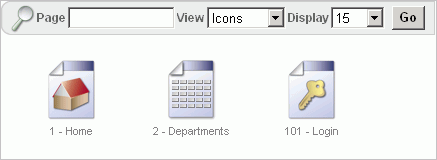

    The two pages you created, Home and Departments, appear as icons by default.
    To view the pages in a list instead of as icons, from the View list select Details and click Go. Your view setting is retained from session to session.
    Because these steps use the default setting, switch back to Icons view before continuing.
    Notice that Application Express adds a Login page automatically to your application.

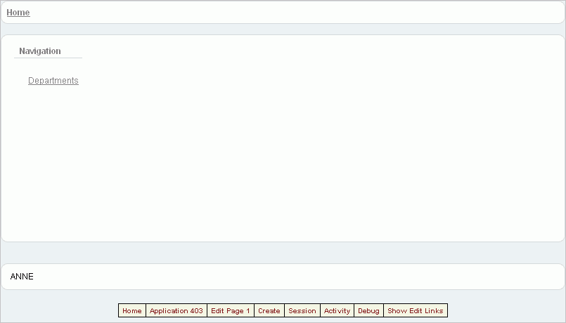

    The Home page of your application appears.
    Description of bldap_home.gif follows
    Notice that a link to the Departments page appears on the Home page because you set up that hierarchy.
    Also notice the Developer toolbar at the bottom of the page. These links appear when you run an application within the development environment. The Developer toolbar offers a quick way to edit the current page; create a new page, region, or page control; view session state; or toggle in and out of Debug mode.

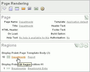

  1. Click the Edit Page 2 link on the Developer toolbar (at the bottom of the page).
    The Page Definition for Page 2 appears. A page is the basic building block of an application. Pages contain user interface elements such as tabs, lists, buttons, items, and regions. To see the definition of each page belonging to your application, you use the Page Definition page. For more information, see "What Is Application Builder?".

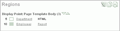

  2. Under Page Rendering, locate the Regions section.
    Description of reg_sect.gif follows
  3. Click Departments.

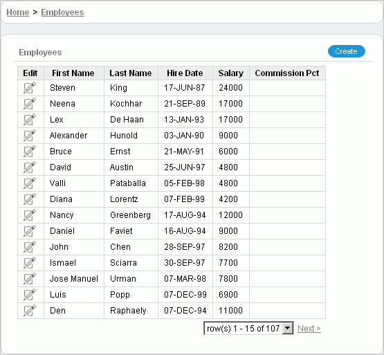

  5. For Define Report Page, edit the following:
    1. Page Name - Change to Employees.
    2. Region Title - Change to Employees.
    3. Breadcrumb - Select Breadcrumb.
      The Create Breadcrumb Entry section appears.
    4. For Select Parent Entry, click the Home link.
      Home appears in the Parent Entry field.
    5. Click Next.
  6. For Define Report Page, accept the default, Do not use tabs, and click Next.
  7. For Define Report Page, press the Ctrl key, select the following columns, and click Next:
    • EMPLOYEE_ID
    • FIRST_NAME
    • LAST_NAME
    • HIRE_DATE
    • SALARY
    • COMMISSION_PCT
    The columns you selected will appear on the Report page.

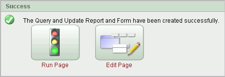

  15. For Confirm, verify the information and click Finish.
Previewing the Pages
To preview the two pages you just created, run the current page. From the Employees report, you can then preview the form.
To preview the pages:
  1. Click the Run Page icon.
    Description of runpg_afterwiz.gif follows

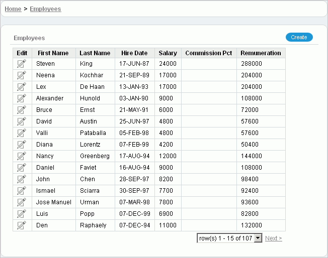

    The Employees report appears.
    Description of bldap_empform.gif follows
    Note the following about the Employees report:
    • The Edit icon you selected appears in each row. You can click the Edit icon to update the employee record.
    • The Create button appears in the upper right corner. You can click the Create button to add an employee to the underlying table.
    • The Employees report includes the five columns you specified. When you selected the columns and applied the changes, Application Express created the appropriate SQL code in the background to produce this result.
    Your data might appear in a different order. If so, ignore this difference and continue with these steps.

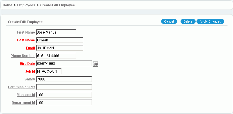

  2. To review the form you also created, click the Edit icon in an Employee row.
    The Create/Edit Employee form appears.
    Description of bldap_empeditfrm.gif follows
    Note the following about the Create/Edit Employee form:
    • The form includes Cancel, Delete, and Apply Changes buttons.
    • The Hire Date field displays a calender, which is included because the data type of the underlying column is DATE.

  2. Under Regions, click the Employees link (next to Report).
    Description of reg_emplrpt.gif follows
    The Region Definition appears.

Previewing the Page
To preview the page, click the Run Page icon in the upper right corner. Notice the addition of the new column, Remuneration.
Description of bldap_empfrmrem.gif follows

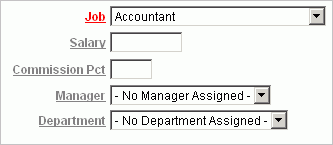

Editing Items to Display as Select Lists
After you create the lists of values, you need to edit these items so that they display as select lists. By default, the items display as text fields.
You also rename the P4_JOB_ID, P4_MANAGER_ID, and P4_DEPARTMENT_ID items.
To edit the job item:

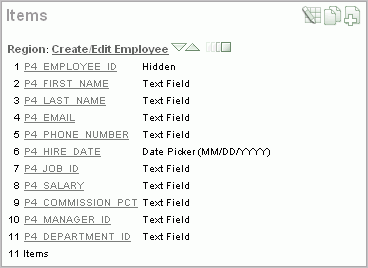

  1. Under Page Rendering, scroll down to the Items section.
    Description of item_sect.gif follows
    Notice that the Items section lists all the items for this page. Currently all but two items show the default type of Text field.
  2. Click P4_JOB_ID.
    The Edit Page Item page appears.
  3. Under Name, select Select List from Display As.
  4. Under Label, change Label to Job.
  5. Scroll down to List of Values.
  6. From Named LOV, select JOBS.
  7. Click Apply Changes.
To edit the manager item:
  1. Under Items, click P4_MANAGER_ID.
  2. Under Name, select Select List from Display As.
  3. Under Label, change Label to Manager.
  4. Under List of Values:
    1. Named LOV - Select EMPLOYEES.
    2. Display Null - Select Yes.
    3. Null display value - Enter the following:
      - No Manager Assigned -
    Note that you did not include this information for Jobs because the Job column is mandatory. For optional columns, such as Manager and Department, you need to specify that the select list display a null record. You can also provide meaningful text to display to the user when this situation occurs.
  5. Click Apply Changes.
To edit the department item:
  1. Under Items, select P4_DEPARTMENT_ID.
  3. Under Label, change Label to Department.
    1. Named LOV - Select DEPARTMENTS.
      - No Department Assigned -
  6. Run the page.
    Description of bldap_empeditfrm_lst.gif follows
    In the form, note that the Job, Manager, and Department fields now display as select lists.

  1. Navigate to the Page Definition for the Home page, page 1:
    1. Click Application in the Developer toolbar (at the bottom of the page).
    2. On the Application home page, click Home.

  6. Run the page.
    Description of bldap_homeemp.gif follows
    Notice that your Home page now includes a link to Employees.
  7. Click Employees to test the link.

Creating a Region

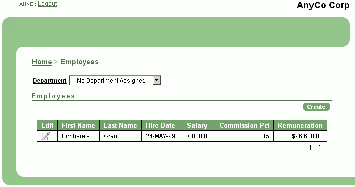

First, create a region on the Employees page to hold the Department select list.
To create a region:
  1. Navigate to the Page Definition for the Employees page, page 3.
  2. In the Regions section, click the Create icon.
  3. For Region:
    1. Identify the type of region to add to this page - Accept the default, HTML, and click Next.
    2. Select the type of HTML region container you wish to create - Accept the default, HTML, and click Next.
  4. For Display Attributes:
    1. Title - Enter Department.
    2. Region Template - Select No Template.
      This option adds a region without a region title.
    3. Sequence - Change to 5 so that this region displays above Employees.
    4. Accept the remaining defaults and click Next.
  5. Click Create Region.
    Note the Regions section now lists a Department region of type HTML.

  5. Run the page.

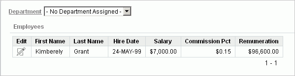

  6. From the Department select list, select Accounting.
    Note that the list displays only those employees belonging to that department.
    Description of bldap_deptfilter.gif follows

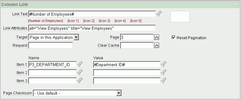

To change the column value to a link:
  1. Navigate to the Page Definition for the Departments page, page 2.
  2. Under Regions, click Report.
    The Region Attributes page appears.
  3. Locate the Column Attributes section.
  4. From Column Alignment, select right for Number of Employees.
  5. Click the Edit icon next to Number of Employees.
  6. Scroll down to the Column Link section.
  7. Under Column Link:
    1. Link Text - Select #Number of Employees#.
    2. Link Attributes - Enter the following:
      alt="View Employees" title="View Employees"
    3. Page - Enter 3.
    4. Select the Reset Pagination check box.
    5. Item 1, Name - Select P3-DEPARTMENT_ID.
    6. Item 1, Value - Select #Department ID#.
      The Column Link section shows all the options you selected.
      Description of bldap_setnumlink.gif follows

To turn off pagination:
  1. Under Regions, click Report (next to Department Details).
  2. Scroll down to Layout and Pagination.
  3. For Pagination Scheme, select - No Pagination Selected.
  4. Click Apply Changes.
  5. Run the page.
  6. From the Department list, select No Department Assigned.
    Description of bldapp_nodptassgn.gif follows
    Employee Kimberely Grant appears. This employee is not currently assigned to a department. Therefore, no department details appear. The 1 - 1 you see on this form is part of the Employees report, not part of the Department Details region you just edited.

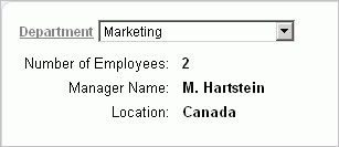

  7. From the Department list, select Marketing.
    Description of bldapp_dptdetail.gif follows
    Note the details under Department.
